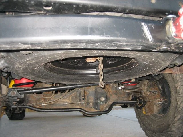

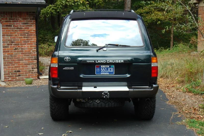

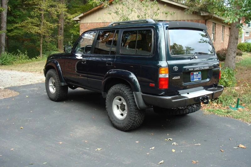

I was able to squeeze a full 34" tire up there with some modification of the winch/cross member assembly and a 1.5 inch body lift. The tire is a 9 inch wide swamper which will only be used as a spare. With my receiver acting as the skid and rear protection, I haven't scraped the tire yet.

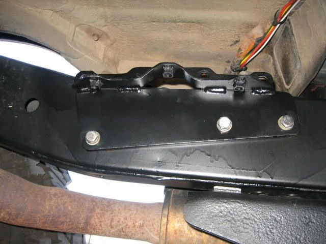

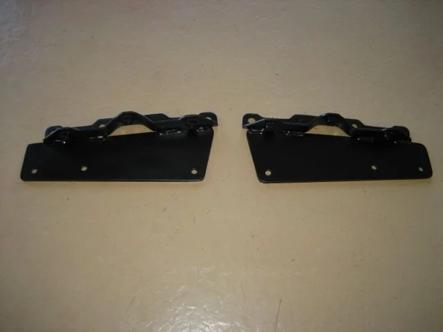

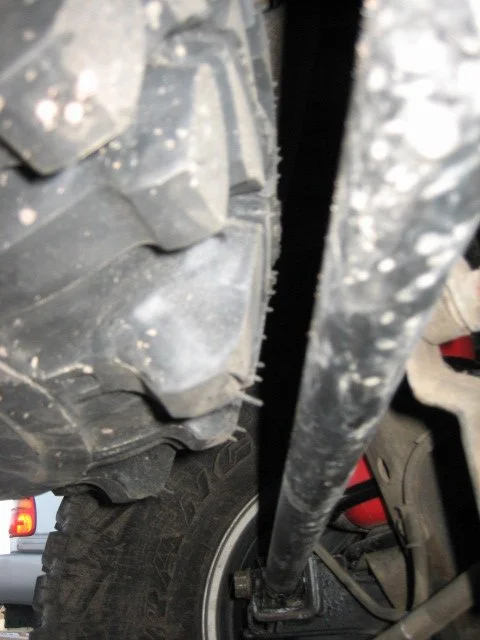

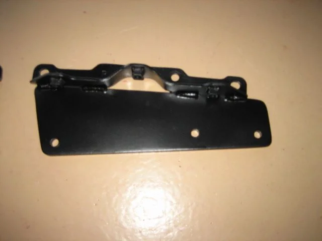

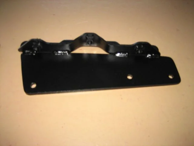

For my spare, pictured above, I made templates of where the holes are in the frame and cut two pieces of metal, 3/16 inch I believe and welded these plates to the end of my existing spare tire carrier. I also moved them back about 1.5 inches so the tire would be nice and snub against the rear cross member. I also leveled it out to keep it tucked up. It took a little trial and error, but a 34.1 inch tire fits without issues. I have about 1/2 inch clearance on the front between the tire and rear panhard bar.
Adam
A few more pics.
Adam,
Really like this idea. You may want to consider making a few more for re-sale or a template as a DIY. ;)

Adam R.,
Me too. I would be interested in buying a set.
I'll run it by my brother. He's the owner of swagoffroad.com. Although he builds stuff primarily for Jeeps and innovative fabrication tools, he's better set up to make a production run of these if there is enough interest.

Thanks Adam!
Consider me interest! With the changes we discussed.
