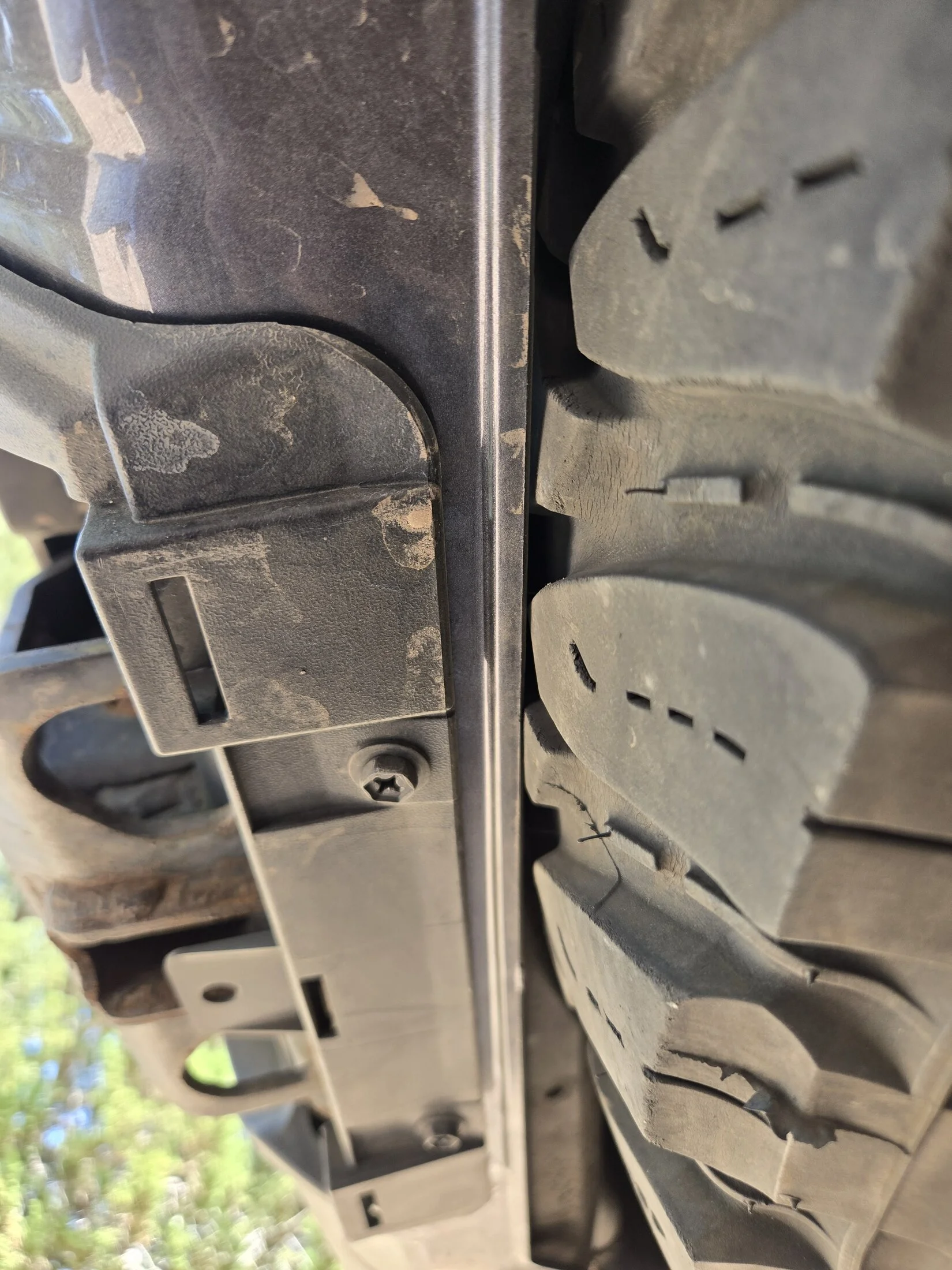

Does anyone have a picture of the stamped steel wedge ? Just want to know what to look for when I lower the spare, will it be obvious and what is the best way to remove it ?
It will be obvious once you get under there. 2 bolts hold it on. Forgot if they are 12mm or 14. Socket and ratchet should be enough to remove them.
Looking under there, it looks like that wedge may keep the spare from snugging up against that nice important looking black box above it. Anyone done the checks to see if it does and if it is a problem?

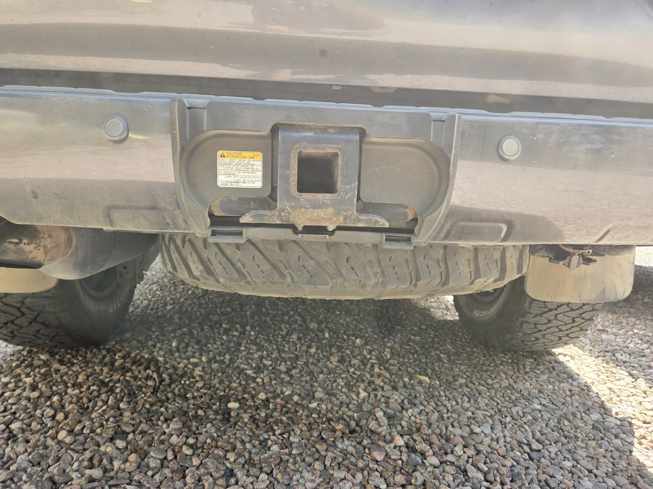

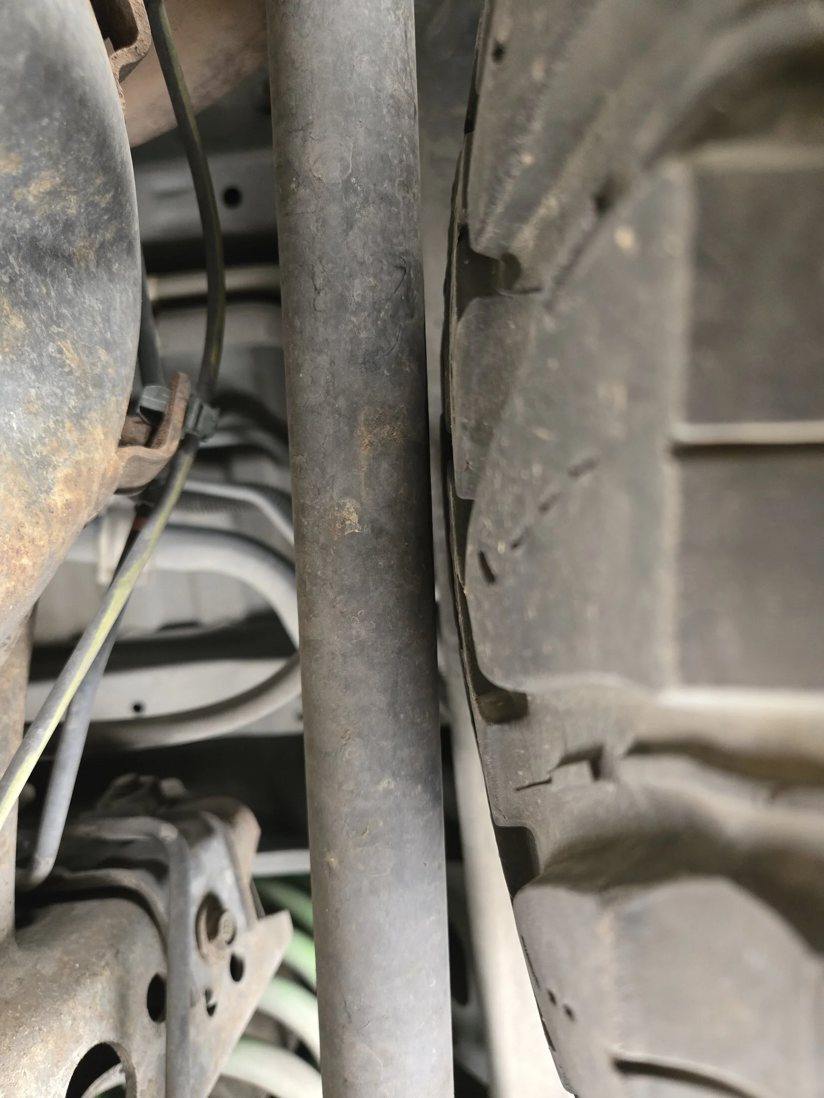

I just fit a worn 285/75/R18 with a few mm to spare at the panhard bar. If it was new it wouldn't have fit. It's less than 6 years old with 1/2 tread life left.
It's currently a nice diameter match for the 295/70/R18s I just mounted - both are a hair over 34". It's fairly wide, so it's noticeable below the bumper.
It'll do until I find a better spare.
View attachment 3949157It's currently a nice diameter match for the 295/70/R18s I just mounted - both are a hair over 34". It's fairly wide, so it's noticeable below the bumper.
Nicely done. Um, we're going to need pics of the rig on 295/70/R18s. :steer:
