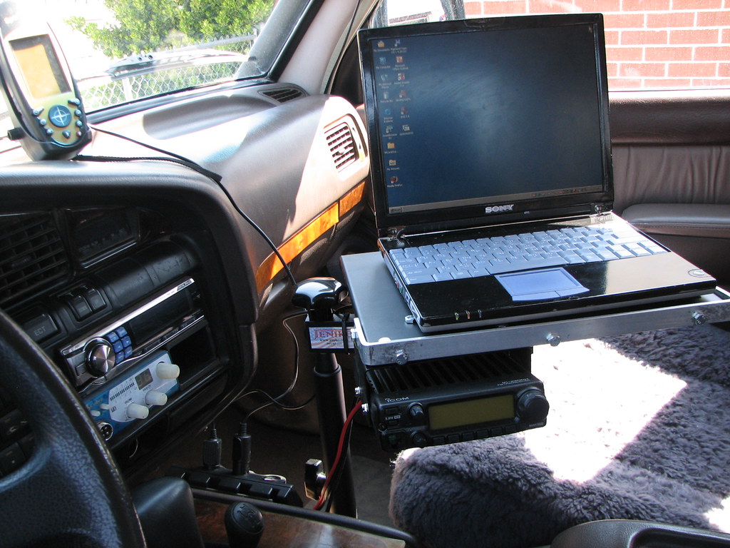

Here are a few pic's I took yesterday, I have mounted it on the trans tunnel, I started with sheet metal screws but decided I needed to bolt it through with 1" diameter washers on the back side.
It has some vibrations or sort when you hit bumps, Normal or not I dont know.
I would also like to add a tray stop of some sort at the bottom and use a strap on the upper side to hold the lap top, It came with Velcro to mount it to the tray :rolleyes:
I will be giving it a true test during the Overnighter for CM in a week or so.
I cut 5" off the back end of the tray mount, That way the passenger could rotate it over.

I moved my HAM radio so It would be easier to see as well as my laptop

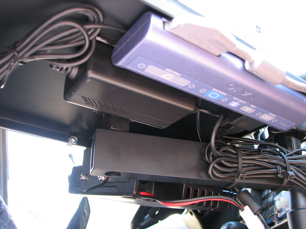

I have Velcroed a power supply for the laptop as well as a "port bar" :meh: so I could use my GPS on it, My GPS only has a serial port...

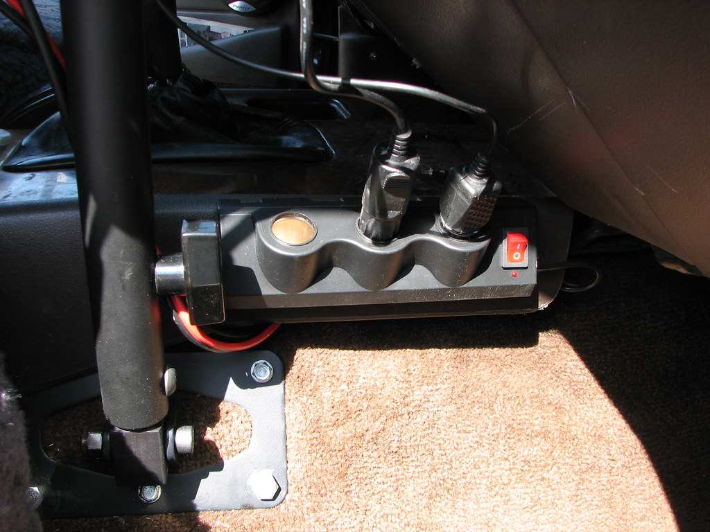

Finally I wired in a 3 hole power supply so I can power the GPS and Laptop.

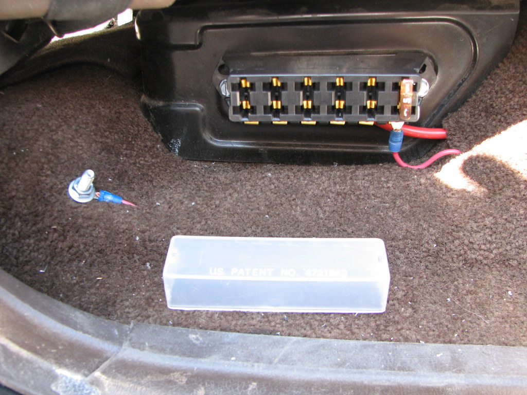

Here is the Fuse block I mounted on the passenger seat, Note the ground screw :hillbilly:
