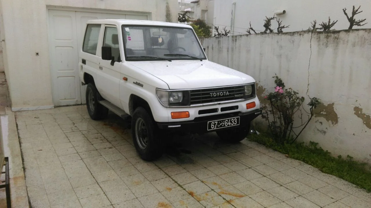

Hi All
I have Land Cruiser LJ70 1991. my 2LT II engine blow up after cold section overhaul, I guess the oil pump didnt run properly.
I am looking for replacement engine and found 5L one. can it fit with no issues? It the only engine I can locate in 500km raduis.
otherwise, I can find many 2L ( non turbo engine)- cheaper option.
I use the car occasionally for recreation and dont really need to climb rocks.
any recommendation?
