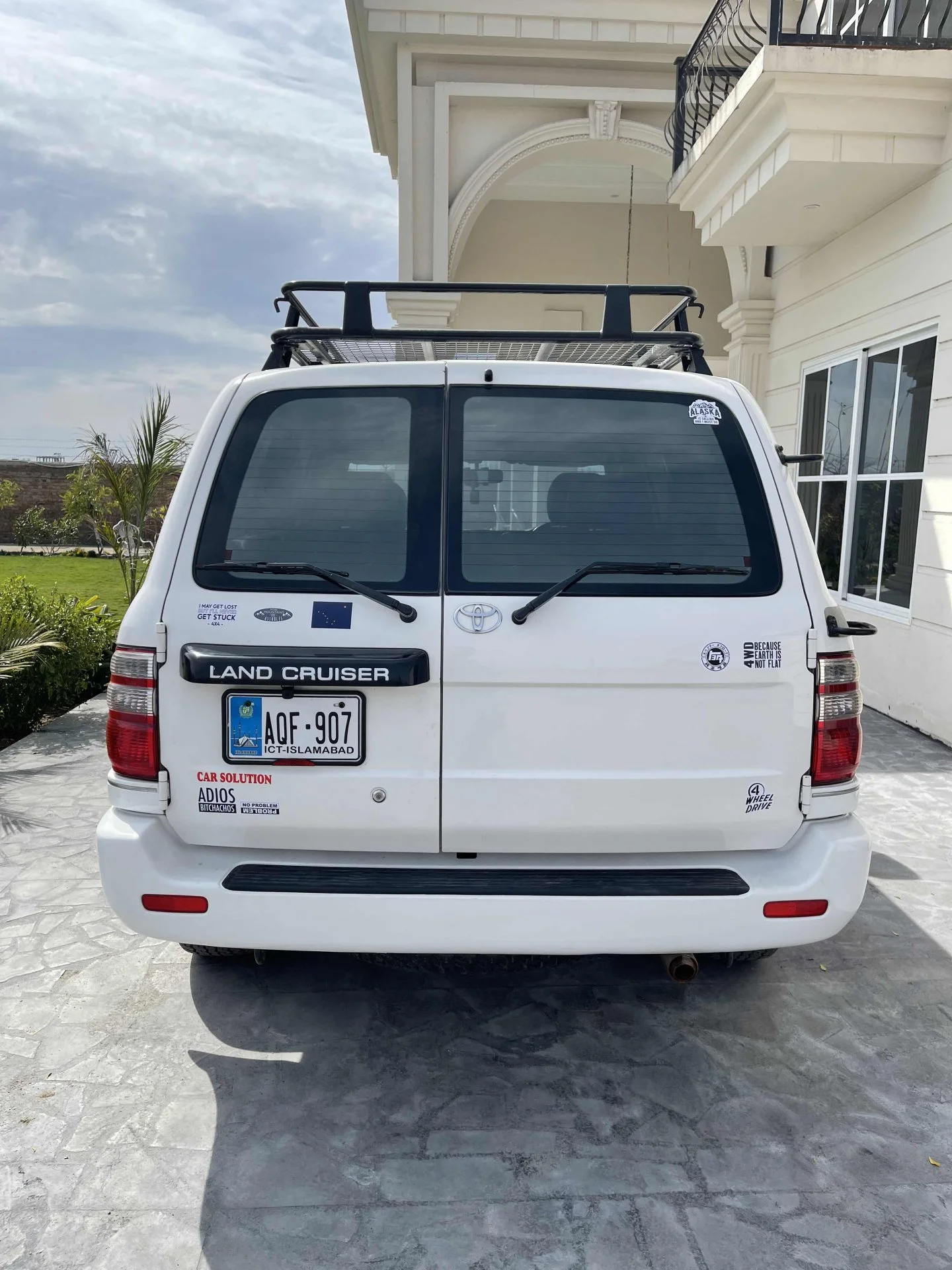

What is the size of these two rear wiper blades? I am far away from the car and want to buy trico wiper blades for the rear but I don't know it's size.
14" and 16"
According to Toyota the short one is also off a 1997+ rav4 and the longer one is off a 100 series land cruiser.
