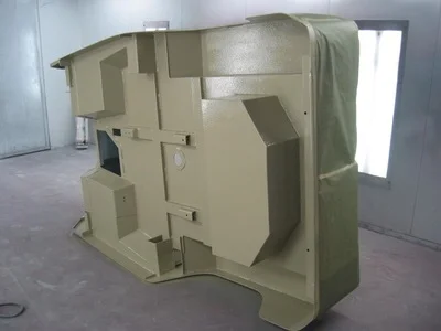

- sanded the entire new Aqualu body and all associated parts in preparation for paintwork; took about 2.5 weekend b/c of all the nooks/crannies; should really make the primer stick
- primed all the parts with self-etching primer

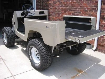

- the bottom was coated at least 4x with color-matching SEM Pro-Tex (polyurethane bedliner material)
showPic.php
Posting a few large pics as I thought you guys might like to see the texture of the SEM material. Really like the way it turned out...it's very glossy and mud should just spray right off.

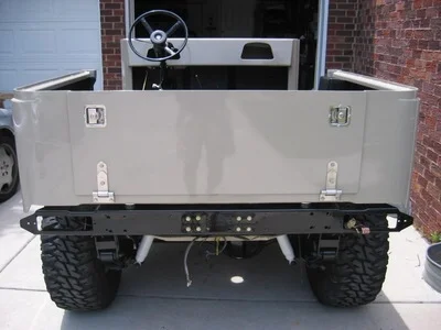

- next we painted the sides Toyota Dune Beige:
Very happy with the paint and SEM applications. My buddy owns a hotrod paint and body shop where all the sanding, priming, paint, and SEM was done. Had to keep reminding them that this is intended to be a trail truck and that it didn't matter that you could see all the TIG weld lines in the body.

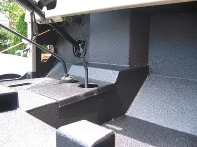

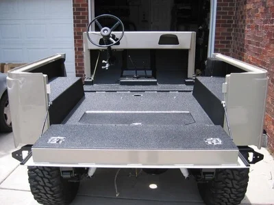

- next, I had the interior coated with black Rhino Liner:

Overall, I'm very pleased with the Aqualu tub and everything seems to be lining up well. Only complaint is that 2 of the rear bed area body supports don't have brackets on the tub to rest against...this basically eliminates 2 of the 4 rear tub supports...I've ordered a generic Energy Suspension body mount kit and will use it to take the space between the bed floor and chassis bracket; I think the tub should be fully supported at all places that Toyota designed.

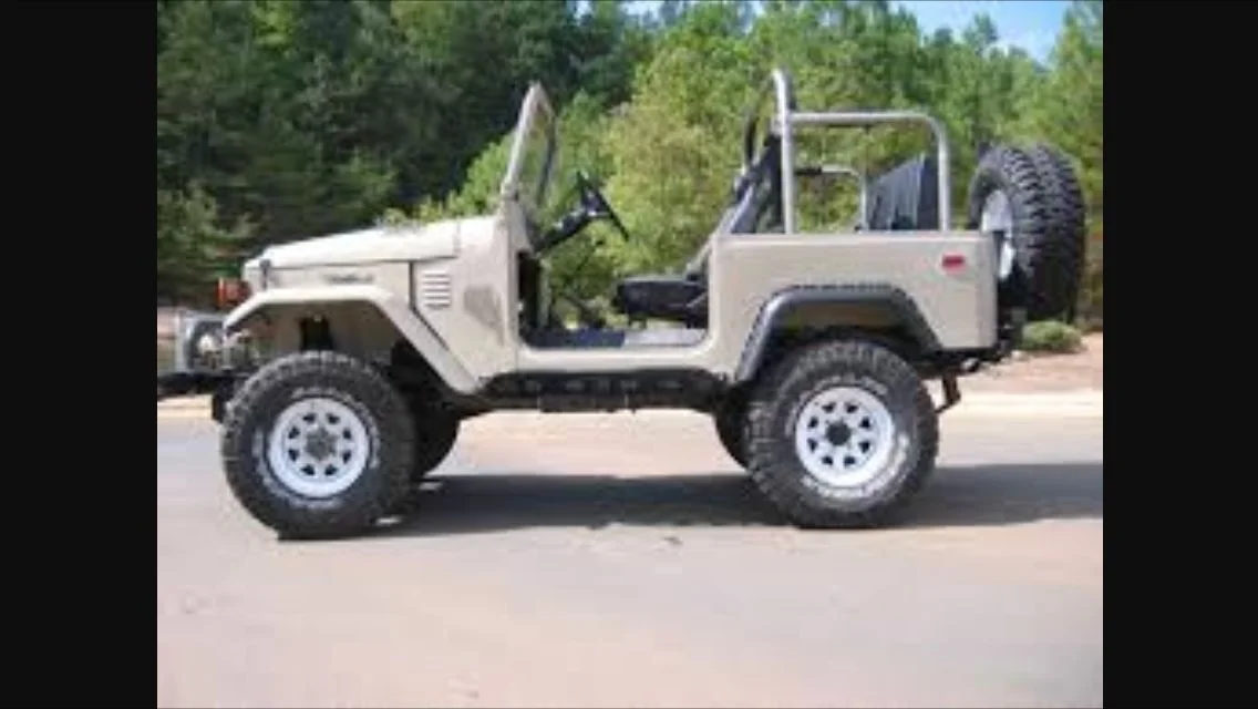

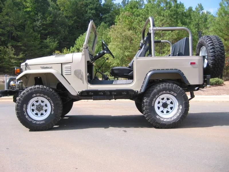

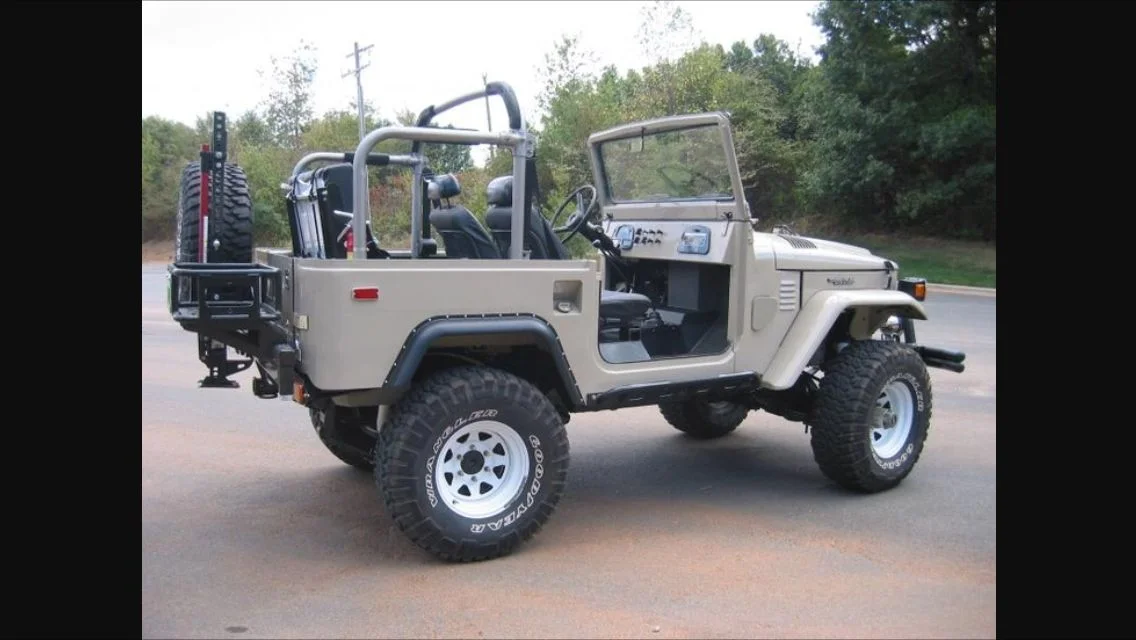

OK, the FJ40 has been back on the road for almost a month. Took it on a weekday trip from Charlotte to Boone & Blowing Rock (NC) to road-test it. It made the trip just fine, so I felt OK taking it off-roading & camping in western North Carolina for two weekends. Did great on the trails and I've been driving it around town the other two weekends. Probably close to 1.5K miles on it already...I love driving this thing!
Since my last post, here's what's been done:
- painted & re-installed front fenders/bib/bezel
- installed new front seat covers
- got it running + tune-up
- new exhaust system
- installed rear auxilary lighting
- new cooling system (the radiator gave up)

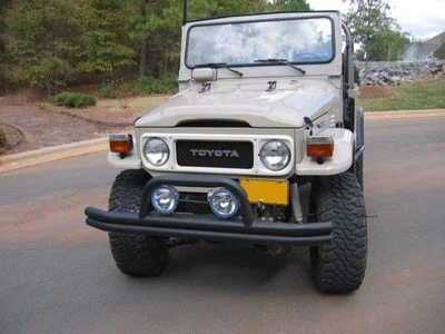

- repainted front bumper + installed front auxilary lights
- installed Man-A-Fre sliders (I should be the poster-boy for MAF...just happen to like their product designs)

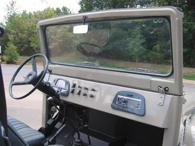

No comments about my J**p rear-view mirror...it fits the Aqualu winshield frame (better than stock FJ40 one) and was cheap (and no, it doesn't shake/vibrate). Oh yeah, just had to also get a new license plate too...
Anyway, here are pics of it:
More pics:
