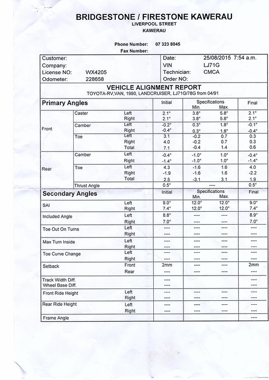

Can someone tell me the wheel alignment specification for my KZJ78 I can't see it in the manual and can only find other cruisers that have a toe in of plus or minus 2mm. It is the toe in I am looking for as as far as I know it is the only adjustment that can be done. Am I right in thinking that?

Here's one for an LJ, fairly sure the KZJ suspension would be the same:
Note that on this sheet the toe is listed in mm but other measurements in degrees.
Front toe is the only easy adjustment. Caster can be changed with offset radius arm bushes, front camber can be adjusted with offset kingpin bearings but they are $$$.
