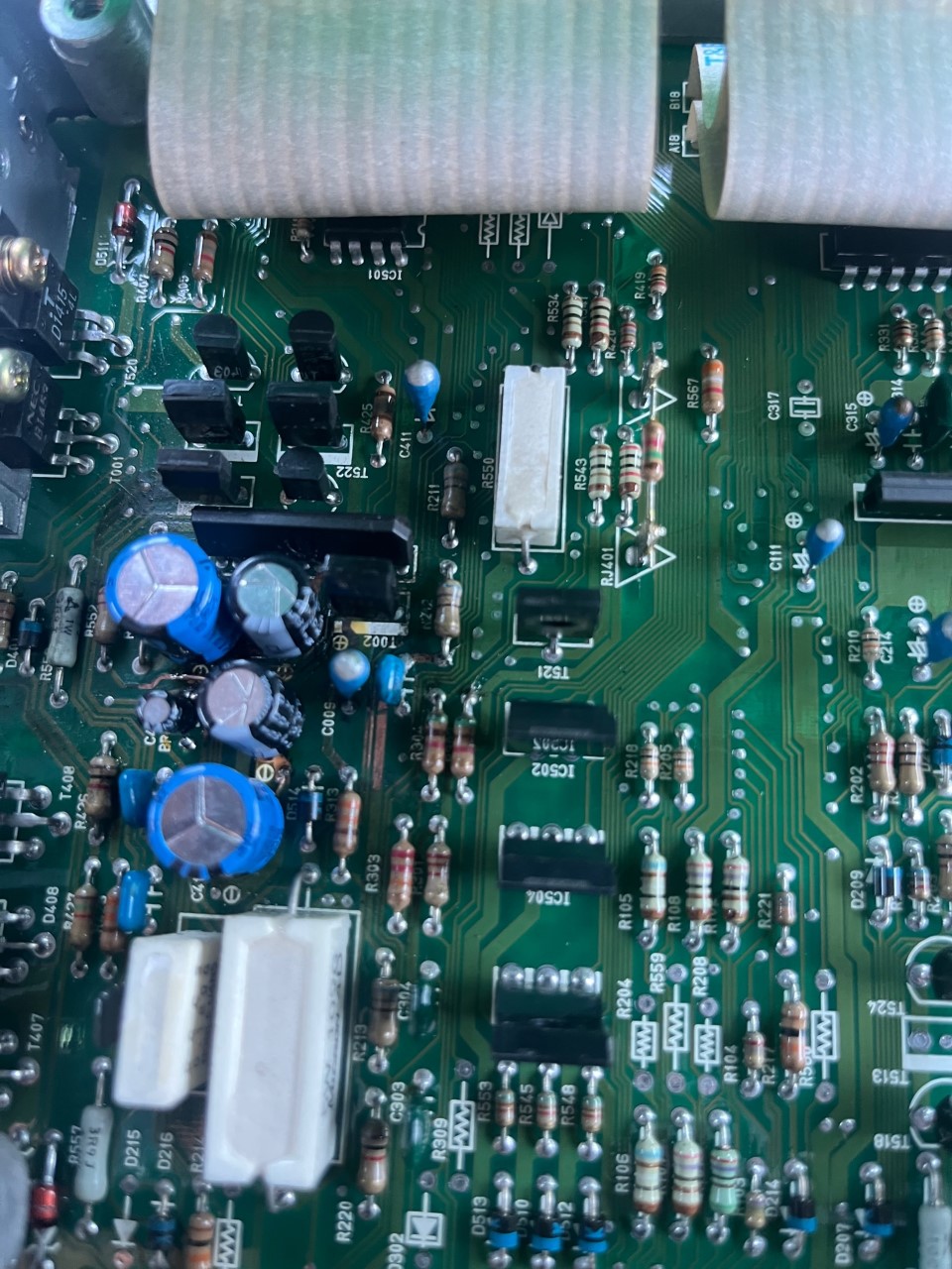

KZJ78 Tigris Writeup: ECU Rebuild/Upgrade with Pics
@Tigris that is awesome you tackled this. My ECU just failed on me last week, coincidentally right after I rebuilt the alternator. That probably isn't a coincidence? After unsuccessfully searching for a replacement that wasn't $1,000 or more and equally used condition, I found a shop willing to rebuild for approx. $200. I found your thread in the process, and I thought for a moment I may have to do this on my own if I can't find anyone with some electronics expertise to do it for me and I have to say I'm impressed. The damage looked pretty minor so I am hoping they can get it repaired easy enough. Will update in a couple weeks.
@FJ40 that green thing
Thank you! And yes that is certainly not fun. I also suspect that the alternator job may have been the last straw for the ECU capacitors, but of course these old electrolytic caps are just going to fail and spew their guts sooner or later.
Having professionals do the job can be the right thing to do, but I must say that "professional" simply means that they will take money in exchange for service. Of course not all are equal.
What I have learned going through this process is that using the correct components is vital. For example not all electrolytic 33uf 60v 5000h 105° are the same, particularly when it come to ESR and series.
I still have the tags from the caps I used (known to be the right component with the best specs) and I can take a picture of these tags for you to source from Digikey. If I were you, even if you end up sending the ECU for a recap, I would send them the caps, this way they don't just use whatever unknown quality/specs replacement. Certified genuine components from Digikey are not at all expensive. $20 will buy them all.
Best of luck!

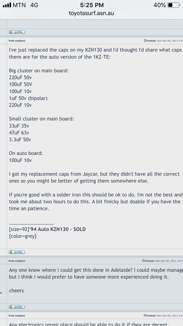

Tigris thanks for your great write up. I’m on Digikey to buy the caps, but I noticed that in the pictures of your original write up (first page), you have caps that are rated for 160V soldered on your board. Where as in your packaging list, they are 50V. Just wondering which ones I should order. Thanks again for taking the time to put all of this together!
Thanks @kzj78dp !
Yes you are correct. For my own ECU recap I opted for higher voltage/duty hours capacitors. That was an experiment that worked well since I knew that you can go up in the voltage but not the capacitance. Higher duty and temperature tolerances are never a bad thing to have.
Unfortunately I no longer have a reference for the caps I used on mine. But since then I recapped another ECU for a fellow Mudder as a favor and opted for the exact specs caps on his as I didn't know how my experiment would pan out long term. The values you see listed in the write up are those from this second recap I did, as I know that they are the correct ones for the job.
My ECU is working fine with the higher voltage caps. But some considerations must be made to accommodate for the physically larger sizes of the upgraded caps. So it's not for everyone.
Cheers!
Cheers!
Got it - thanks for the quick response!
Is it recommended to change any of the non-electrolytic capacitors? Or, are those generally fine?
I came across a similar list for KZN130, which seems to be the same as the KZJ78, and they mention one 1uF / 50V Bipolar. Anyone know which one they are referring to?
@kzj78dp
According to my research, all the non-electrolytic capacitors are okay to leave in circuit due to being manufactured using different formulation, lack of electrolyte, or the utilization of non degrading ingredients such as mica or tantalum.
Replacement of the 1uf bipolar capacitor was not suggested since it resembled an electrolytic capacitors only superficially. (It's also non polarized, i.e. can be installed in reverse).
That being said I did replace the bp capacitor when I recapped the two ECUs I worked on, mainly because the PCB was heavily corroded underneath it and I wasn't sure if the bp cap would survive the heat from the extraction and re-installation.
Heat management with new capacitors is a lot easier as you will have long leads to dissipate the heat.
Best of luck!
