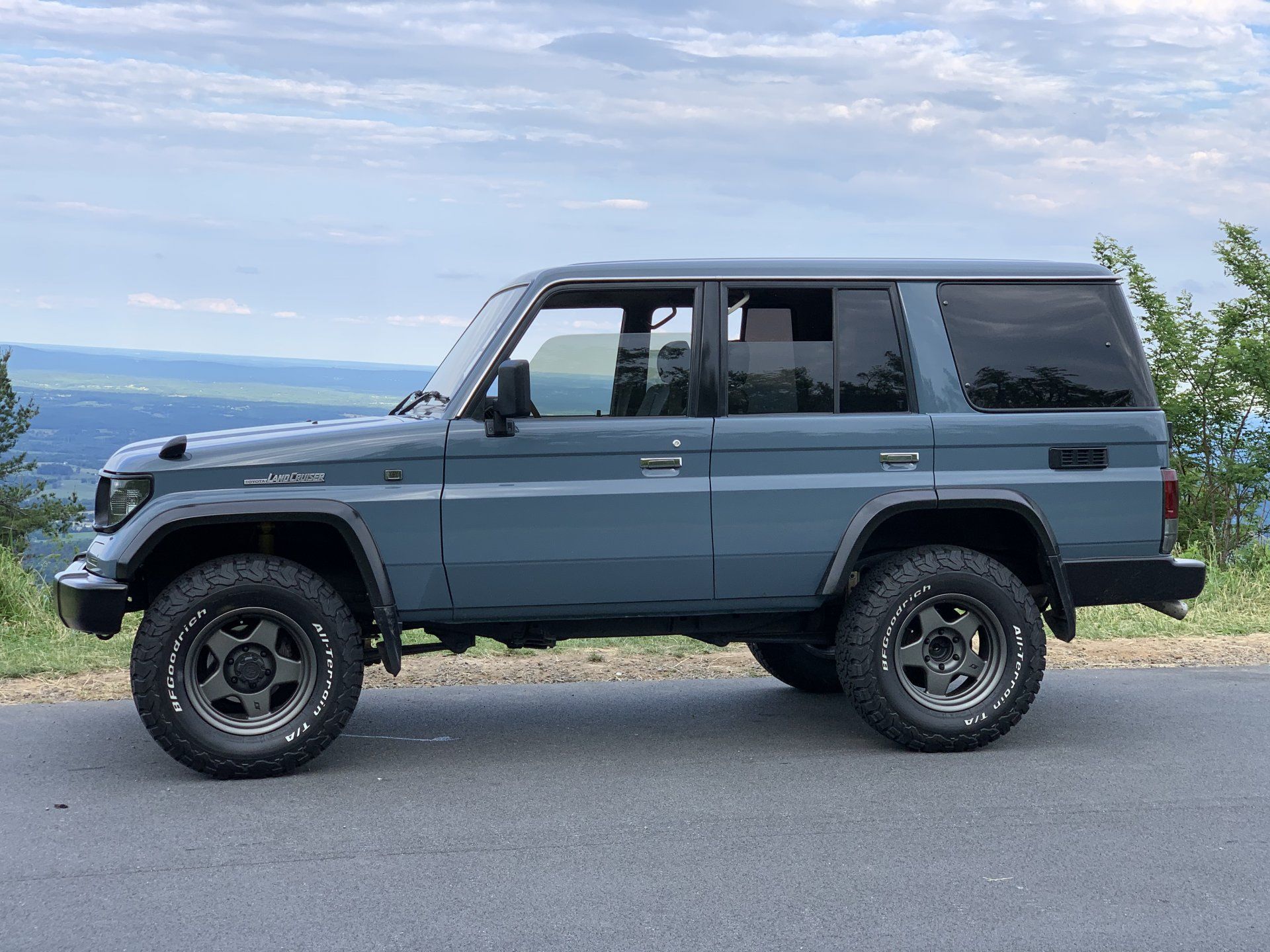

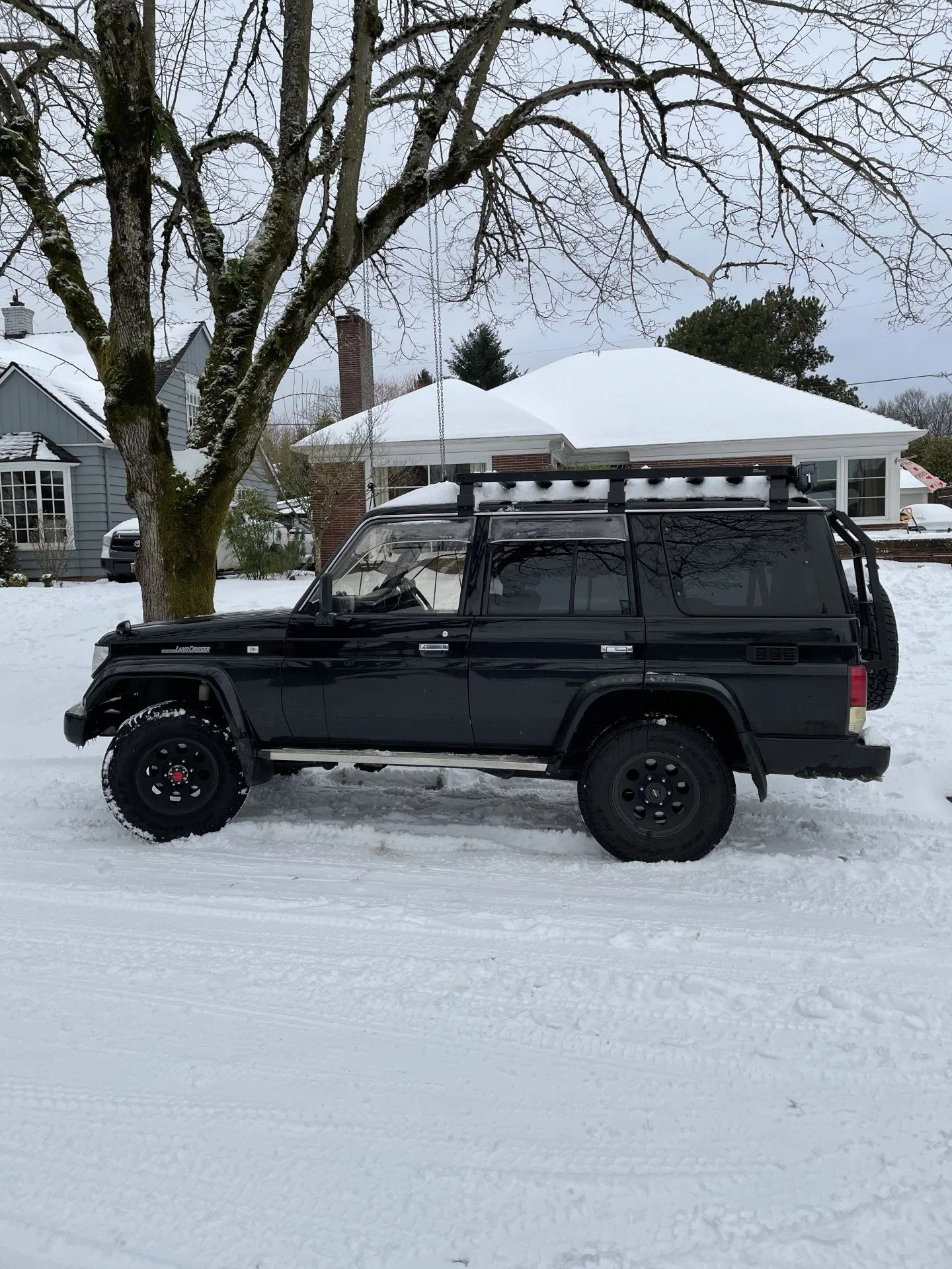

I found a similar used lift local to me which I put in my LJ78 (previously I've run brand new OME and Dobinson's lifts). I scrapped the used pro-comp shocks for new extended travel Dobinsons. Way better than the pro-comps, and it rides very nice. I love the tall springs, and they do work great with my 35s. Here are some pictures. My truck's not pretty, but it does go anywhere.

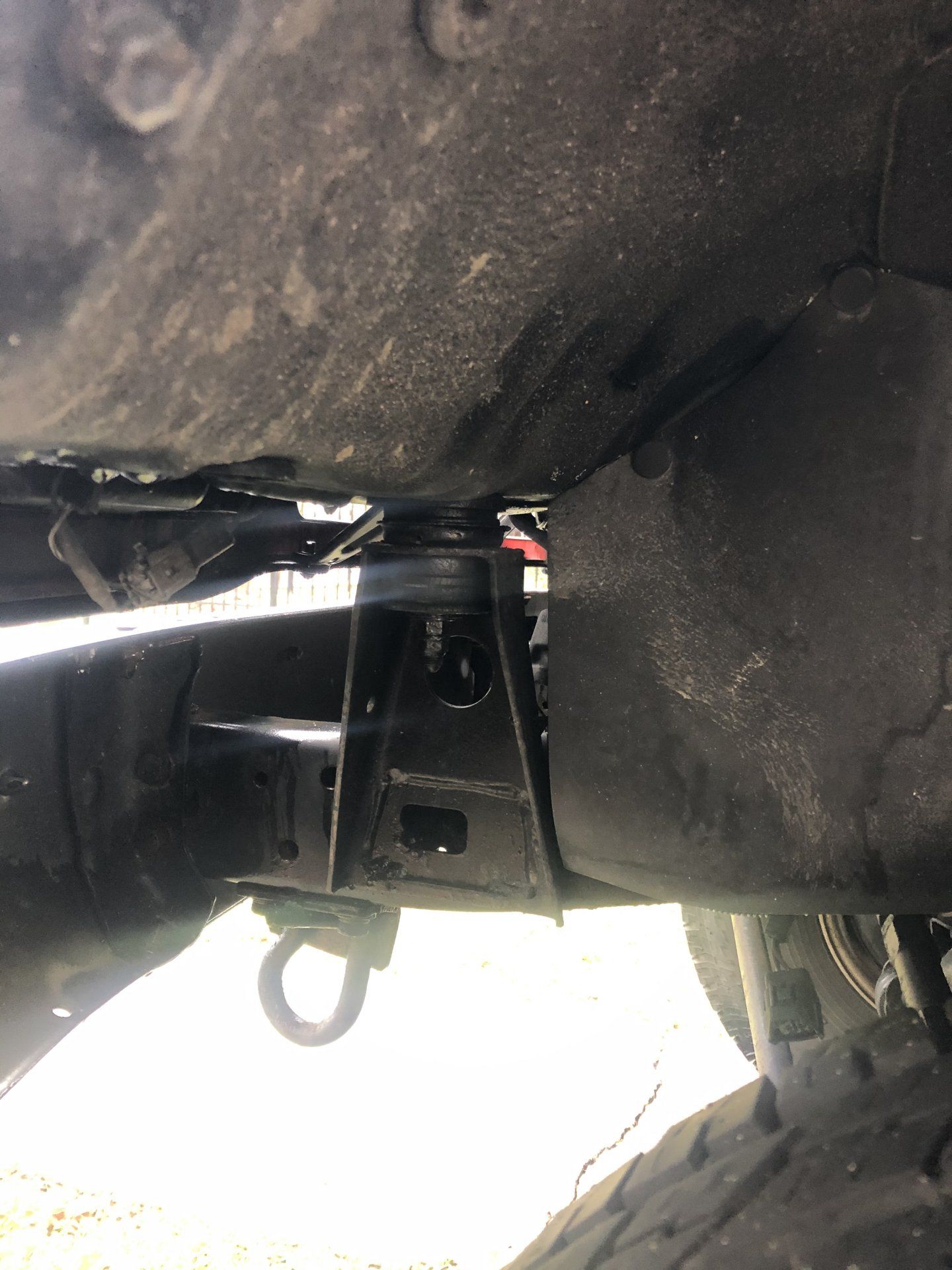

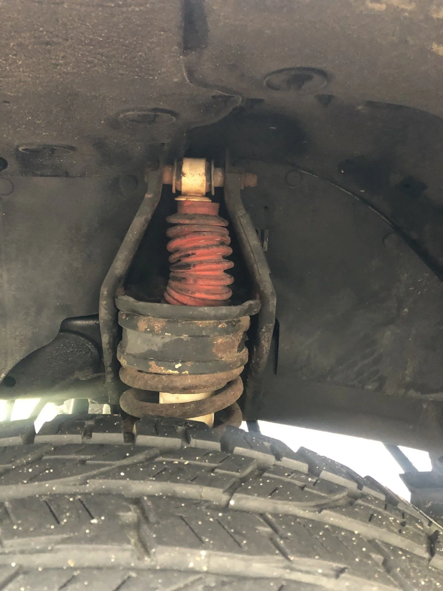

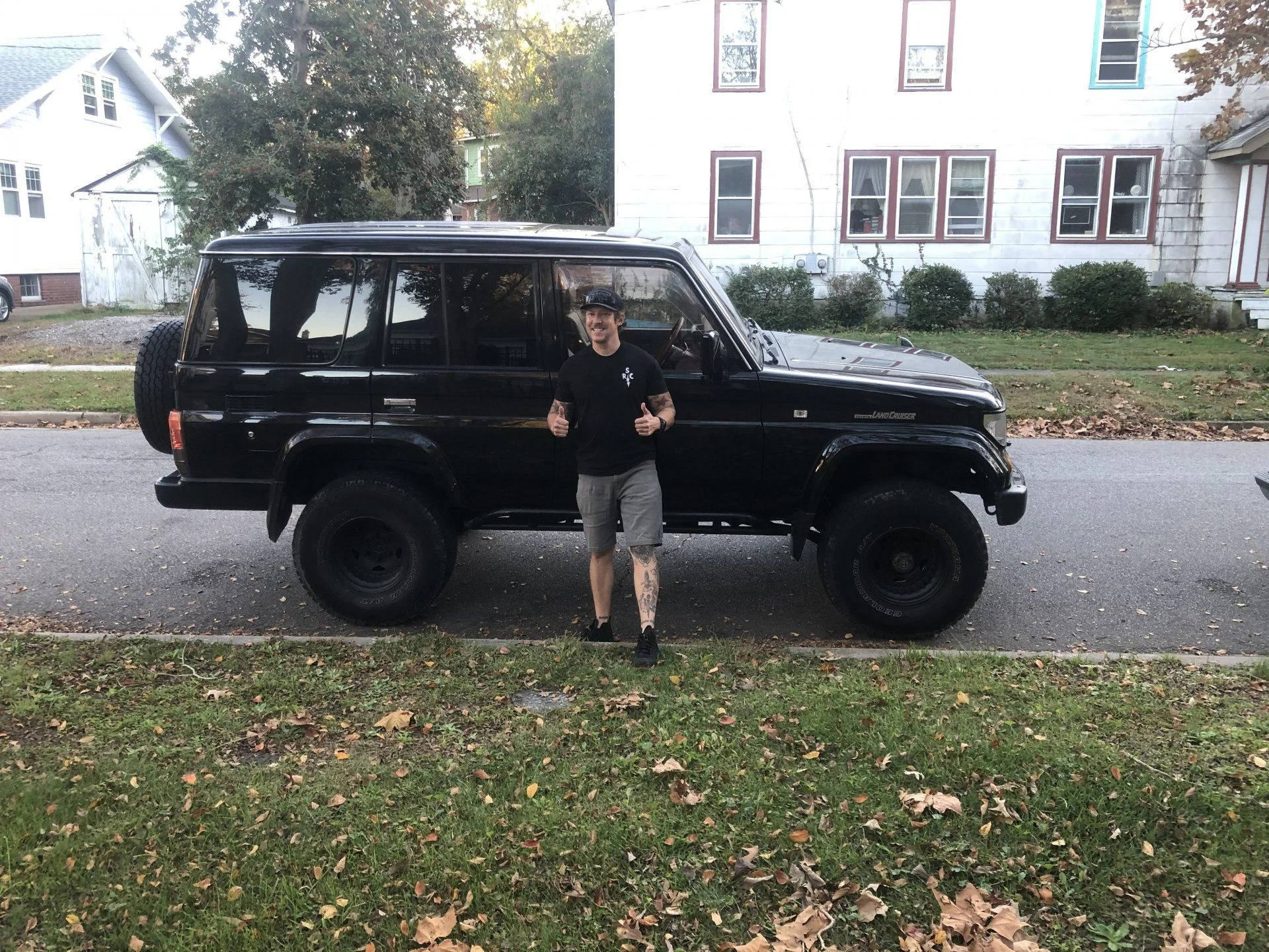

like I said, she is new to me. I was doing some looking around underneath at the suspension and it looks like there are spacers for the coils and a body lift as well. Like I said, the highest portion of the front fender sits 40 inches above the ground. So it’s sitting pretty high. I am thinking about going with your suggestion of the 75mm lift through Dobinsons and taking the spacers off. I might leave the body lift on since it looks no bigger than an inch. I would like to stuff 35s in there but I definitely don’t want to make it to tippy when it’s off road.
Truck looks great! I don't think Dobinsons makes a 75mm lift. It's a 60mm lift. I was just recommending their shocks if you want something better than the ones you have on there. Personally I'd stick with the springs you have if I was you. Any lower and you won't be able to fit 35s. I don't find my truck any tippier with 35s. Especially as they are wider offset rims and wider tread. Less tippy if anything.

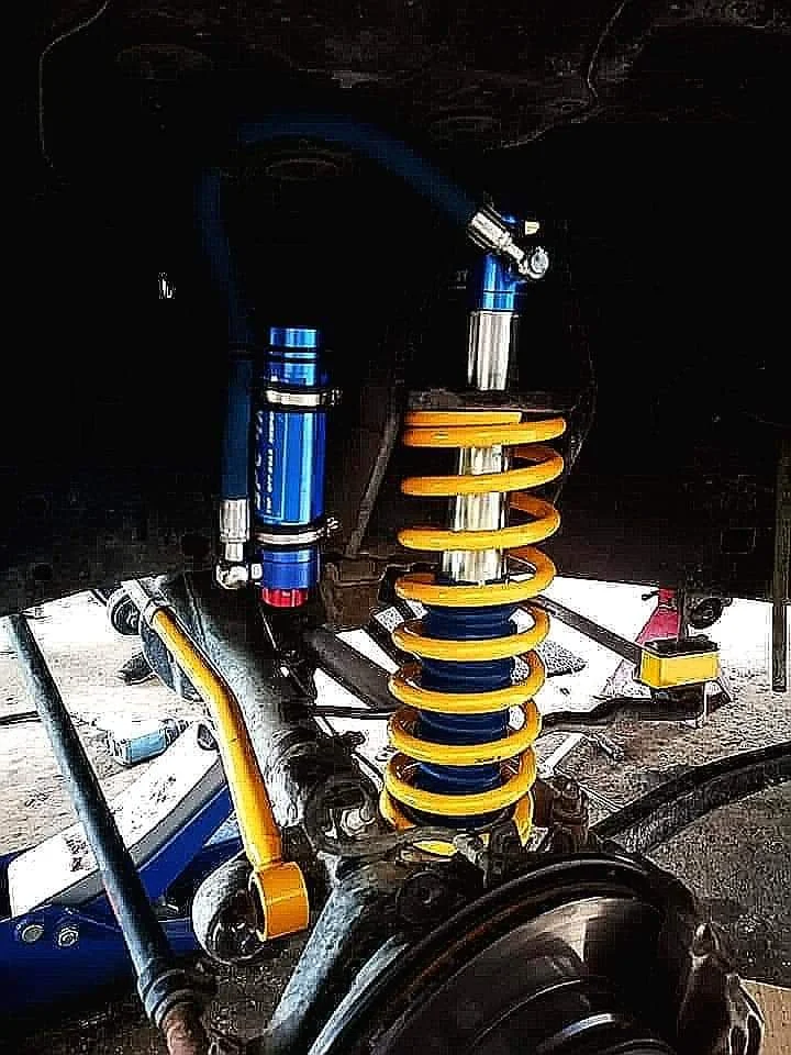

I was able to find a company called SPC 4x4 out of Malaysia that has a wide variety of suspension set ups for the KZJ78 and other models. Lots of 80 series stuff! They don’t have a webpage. Find them on Facebook and communicate through WhatsApp. They have everything from bumpers to suspension and everything in between. They have a remote resi setup available in 100mm. Anyone ever seen any of their stuff in person?
why not go with toughdog suspension? BP51 does not have shocks for KZJ78 series. SPC shocks are not bad , i have friends at sabah thats what their reviews are.
for sure dont compare with famous shocks like "king shocks". its not a bad shock but i personally think its better that there is a dealer in the states will be very helpful.
As these shocks can be RE-valve to suit the owner needs . overall they are not bad . in terms of PNP suspension, i suggest tough dog , dobinsons and ironman.
