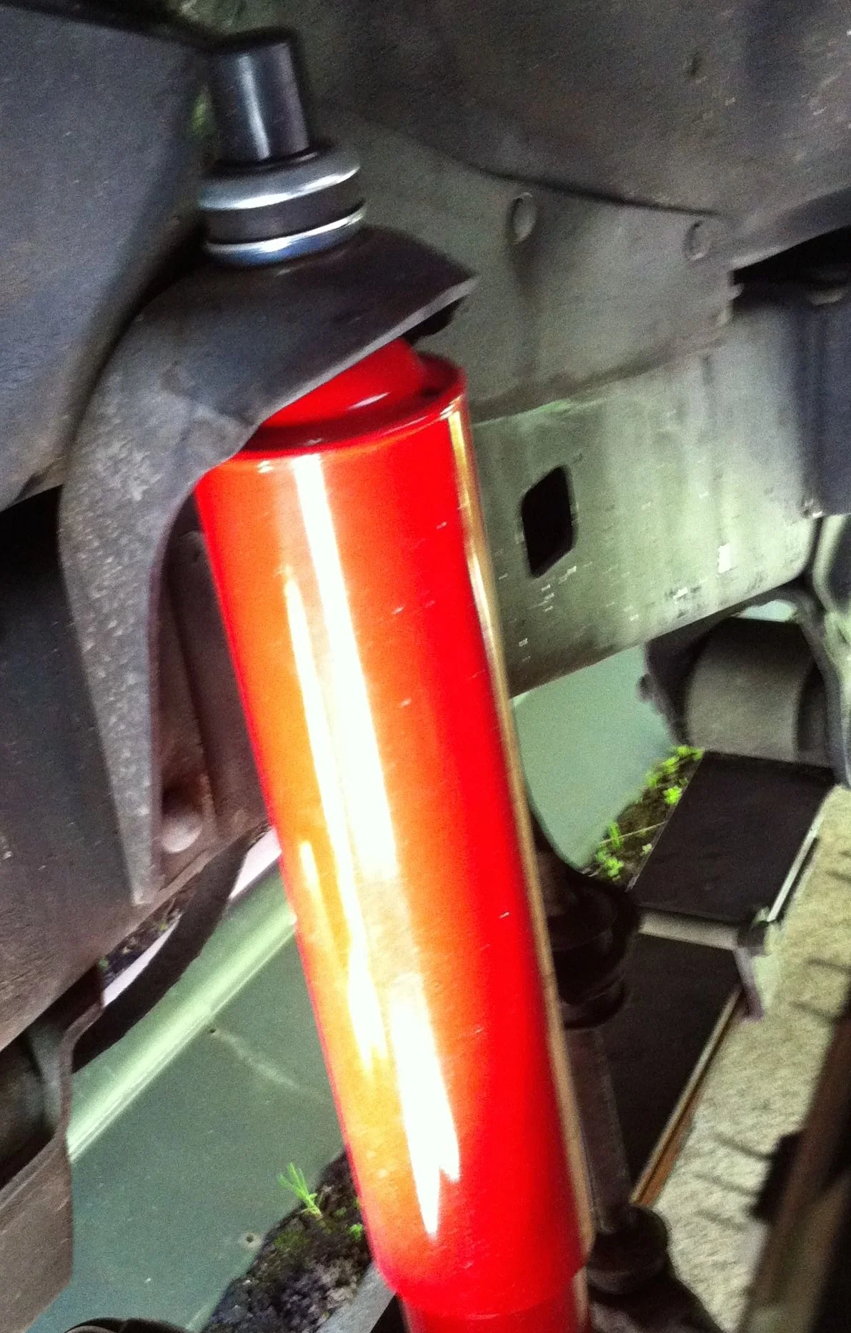

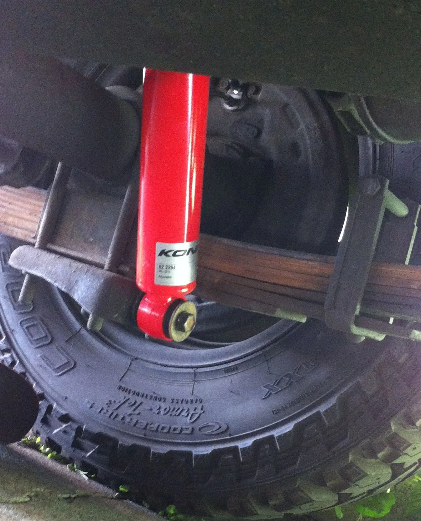

G'Day

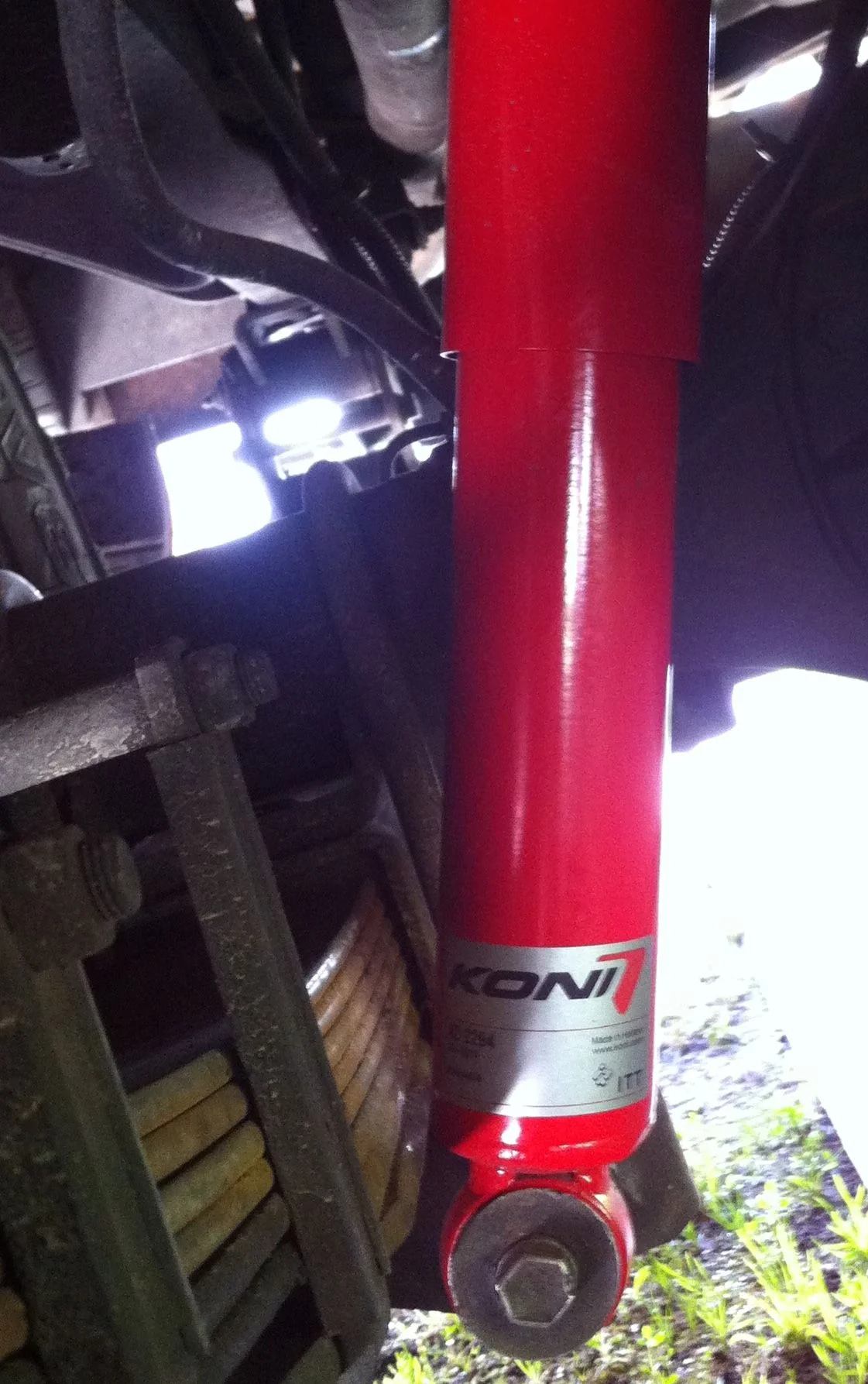

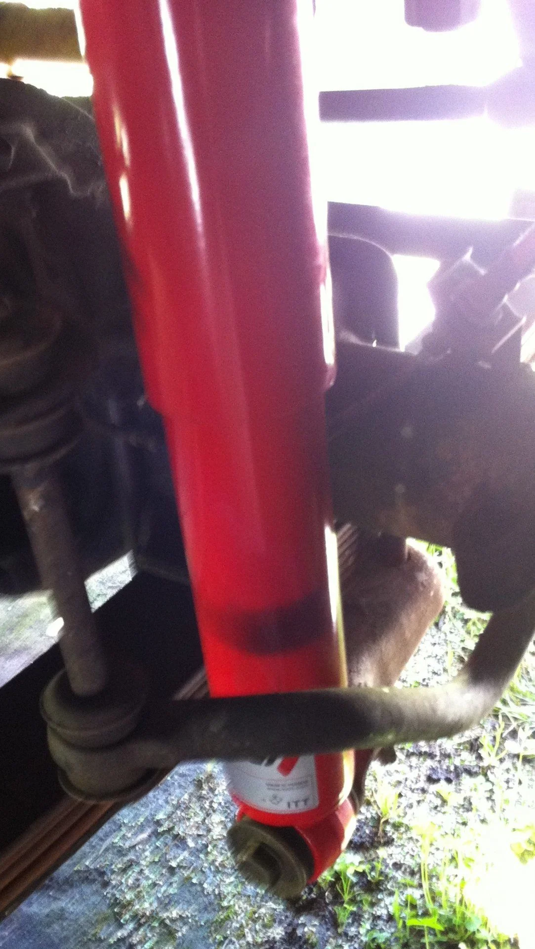

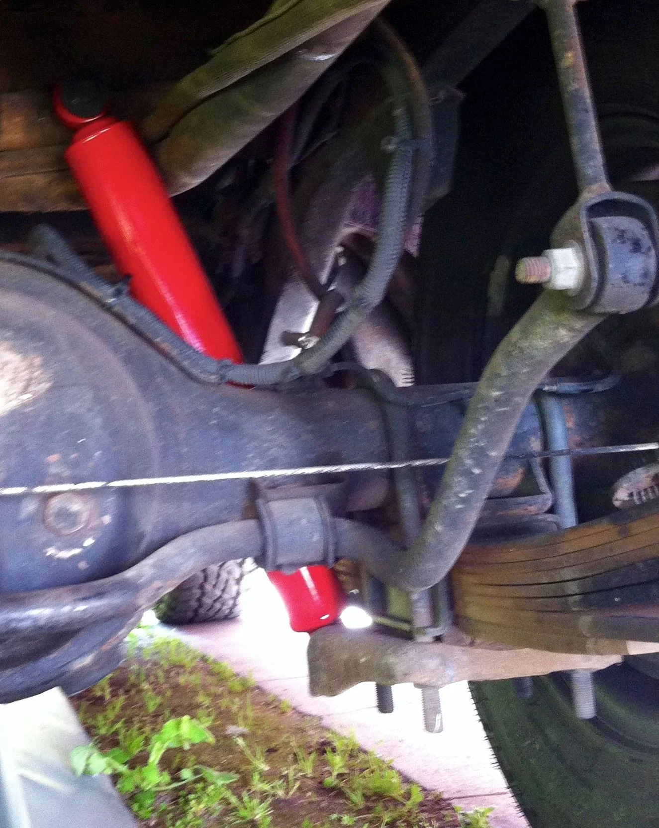

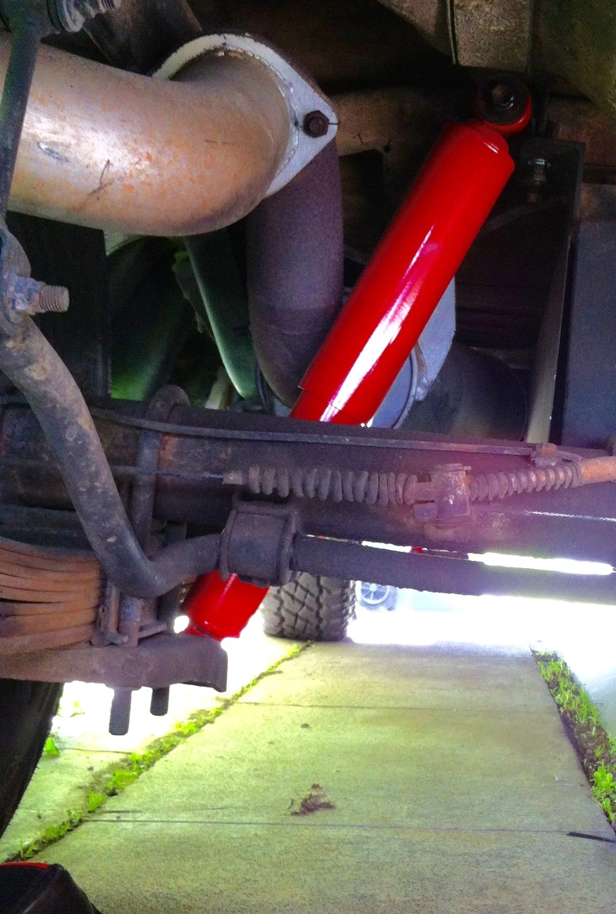

I finally got the systems to talk to each other, so I've uploaded a few pictures.
As you can see there isn't a lot of room at the rear. On this side too, with the filler pipe.
a view from the front.
and on the other side.
See if this works before proceeding...
Ironbark
Ok, seems to be working:

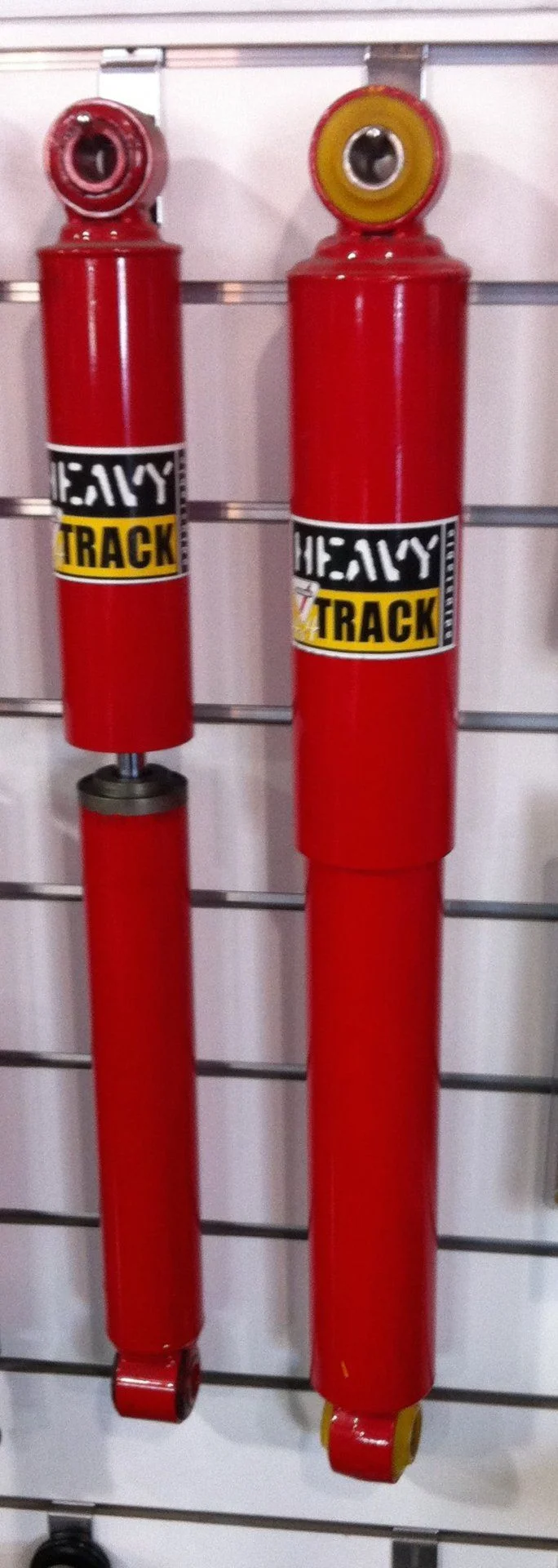

Just to show the differences, here is a 90 series side by side with an 82 series.

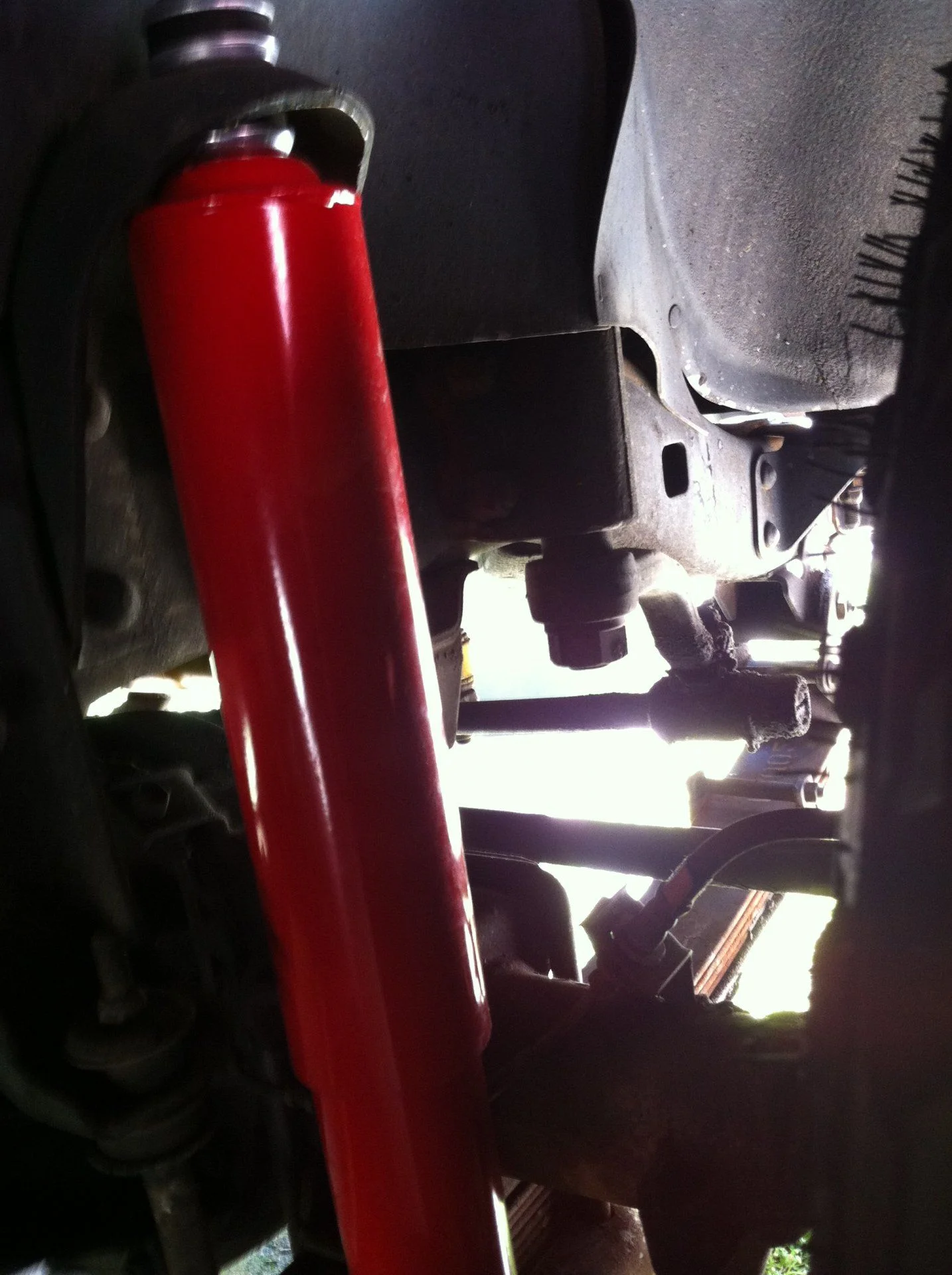

A few views now of the front shocks:
There you go, enjoy!
Ironbark
Ironbark
