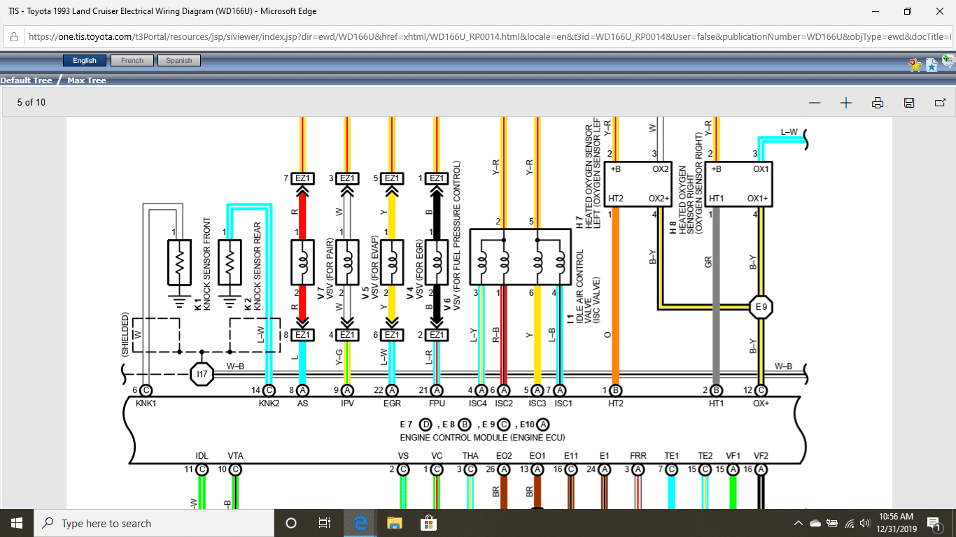

when you say that you rewired di you run a new wire from the sensor to the ecu or just do a continuity check on the harness? if you did run a new wire the wire has to be shielded as it can pick noise and cause a bad reading. this is from a us spec ewd but I would expect that the aus spec would be similar
I did run a wire back to the ECU , but it wasn't shielded.

the shielding could be as issue but I doubt it if you were running the wire as a temporary fix or just to rule some things out. if you can get to some of the shielding on the harness check for continuity to ground
if your thinking that its the morot have you recently filled up, maybe it was a tank of bad of petrol. how many km on the truck, time for a tune up maybe? is the timing set correctly on the truck? you can pull the plugs and see what the tops of the cylinders look like with a bore scope. im sure that youve already checked these things but just have to ask the stupid questions
if you need some more screen shots of hte ewd let me know and i can post them up

Sorry what is hte ewd
electrical wiring diagram, its the wiring schematic. I can only get it for na spec vehicles but it may be able to help with certain things on the truck or at least get you started looking in the right direction.

Cheers I have a wiring diagram

and your ground location for the shielded wires will be on the intake, youll see multiple wires crimped together for one ground point
