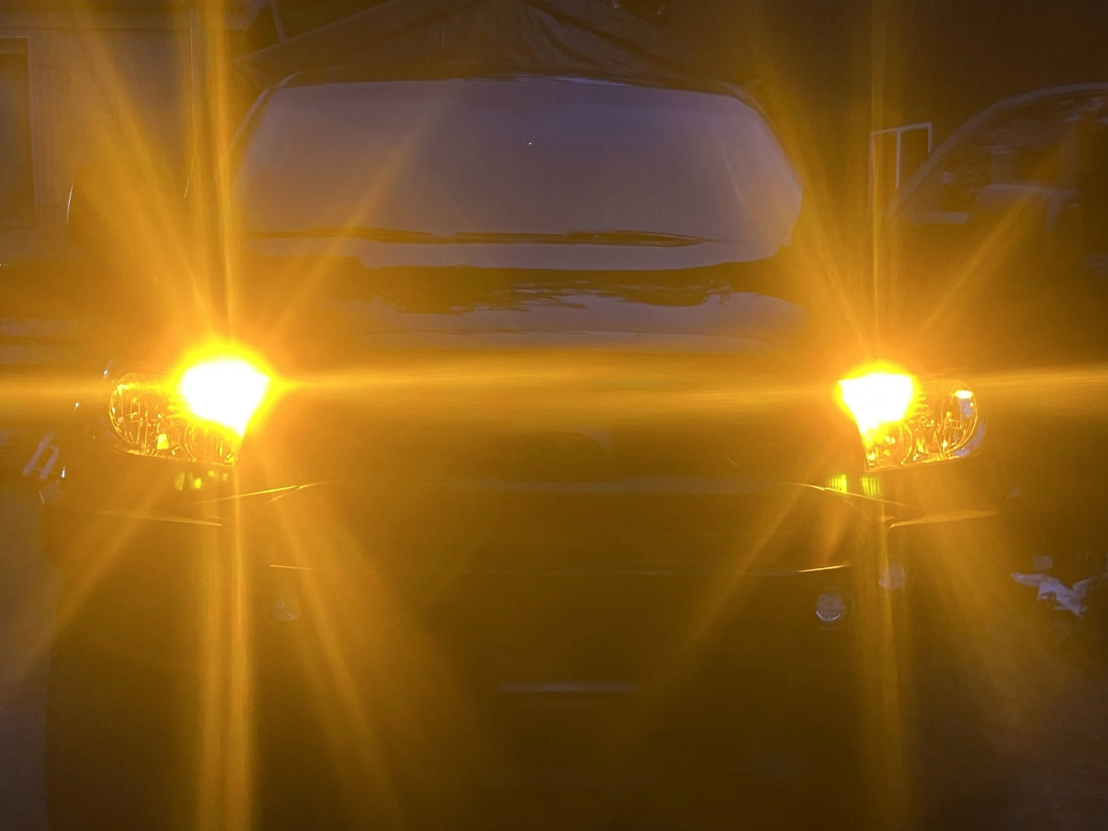

Just basic truck running:
Truck w/ running lights & even turn signals in motion:

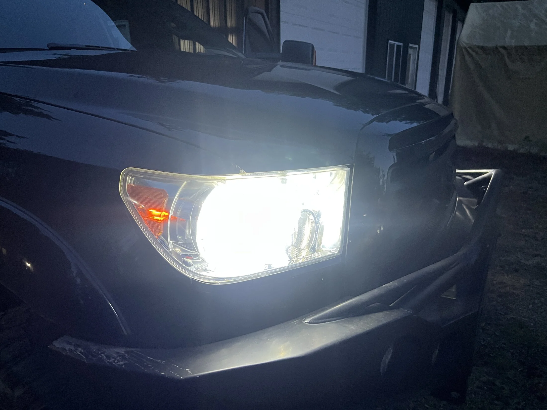

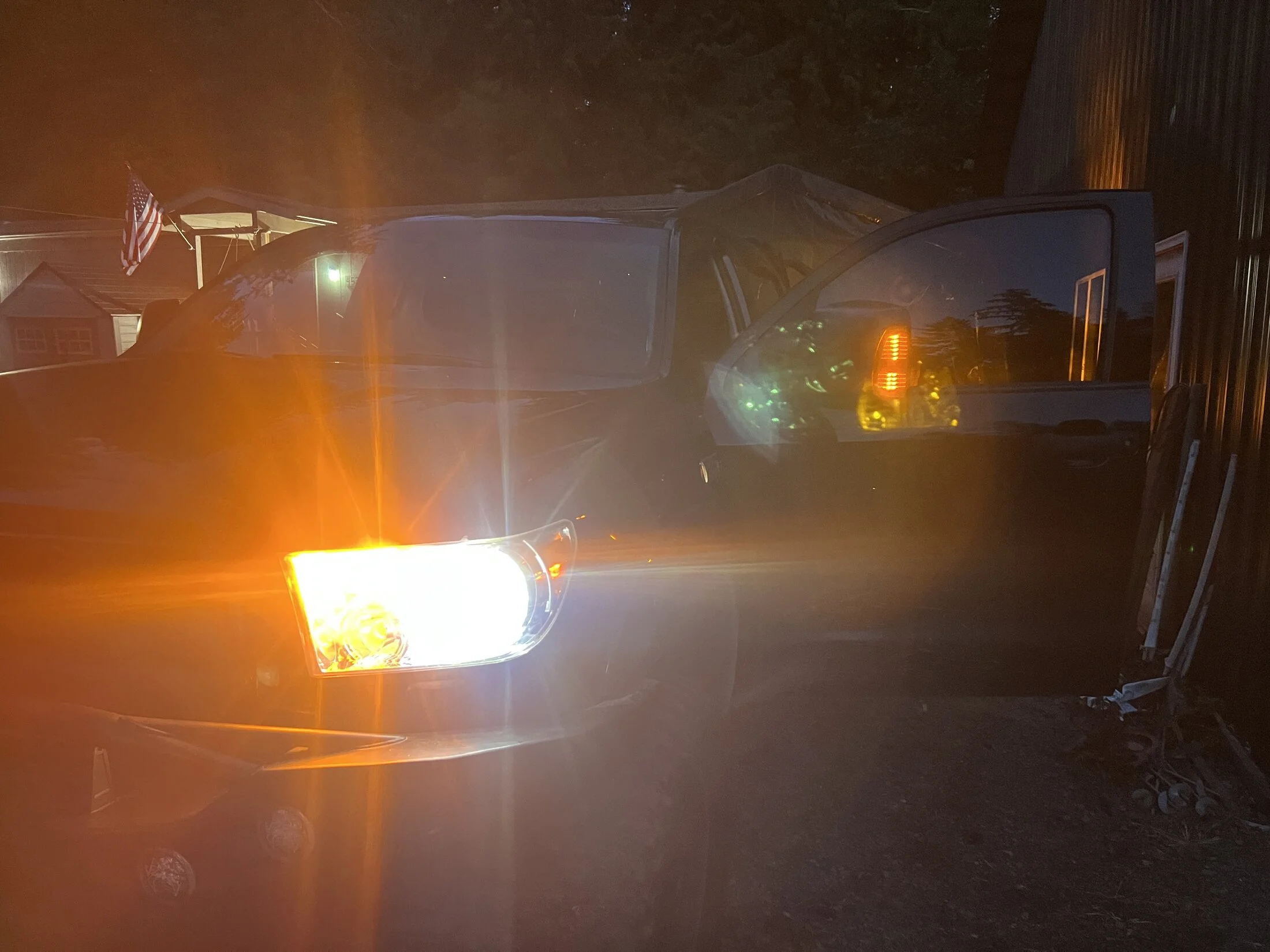

But once you turn headlights on, the DRL’s go white while running, but flash amber for turn signals:
But when you signal turn, it flashes amber:
— I been told like 3x I am an a$$ not signaling a turn, but if you get the white/amber version, nobody can complain, and I like maximum visibility so if you are into the same, the Canbus support from the Auxito stuff supports white DRL’s when headlights are on & flash amber when you turn.
It’s small stuff, but the mod makes you way more visible & I lime the color shift for when I signal my turns.
