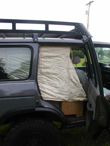

Have you seen the set up that Kevin Rowland has. It is on his ROTW thread post #165. Very simple and functional, if done with the right material it can be mosquito proof.

like this solution...but doesn't work with a roof rack!
