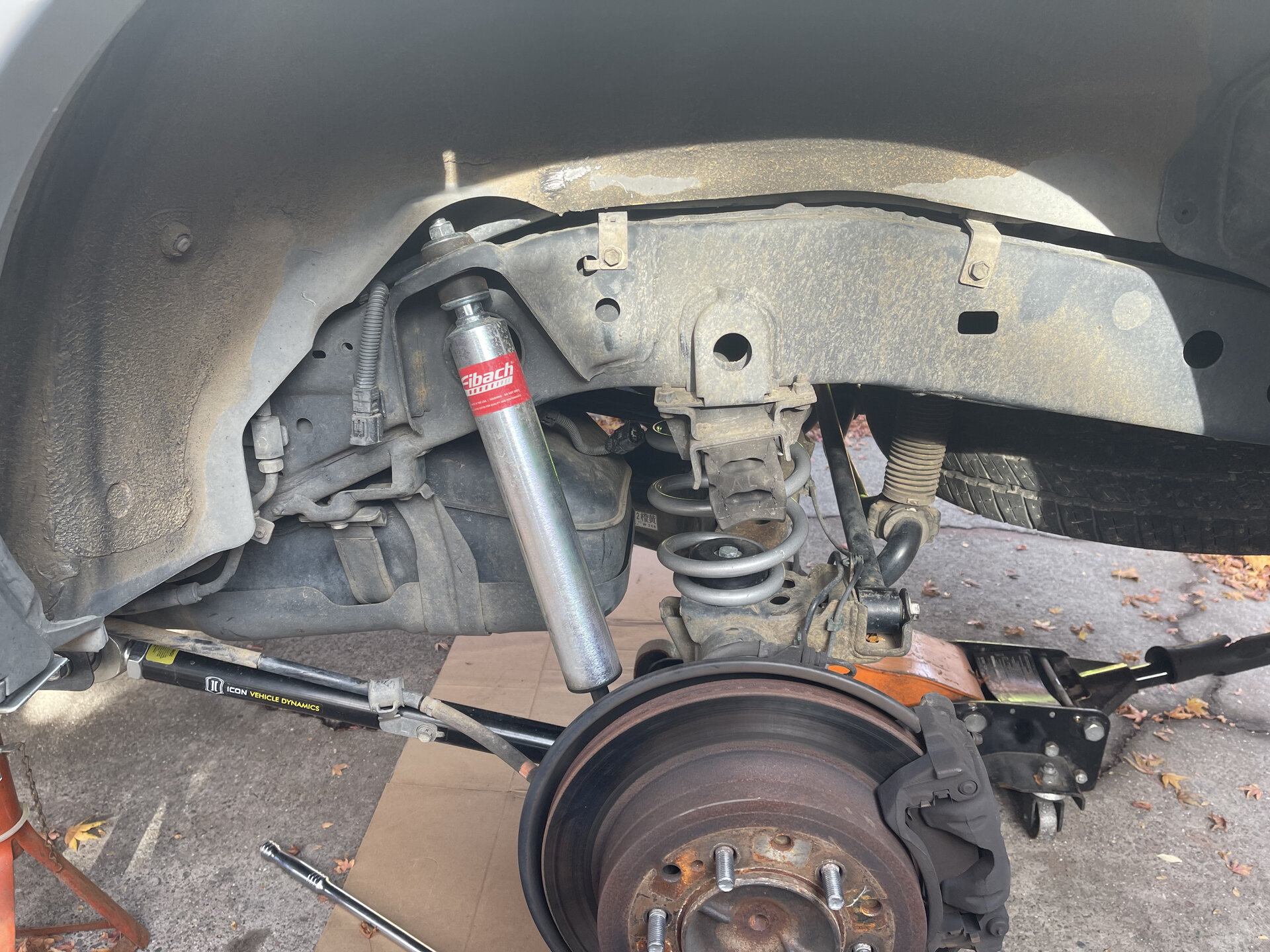

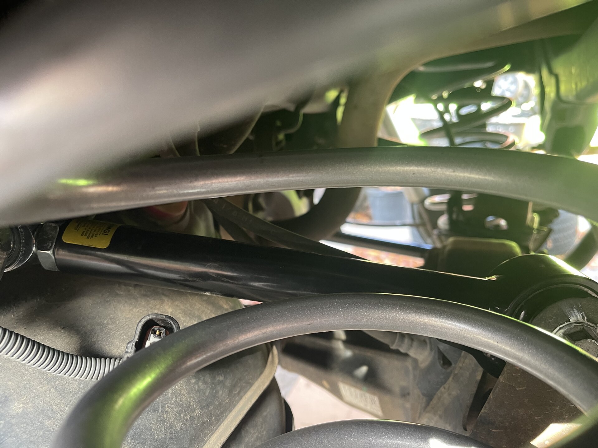

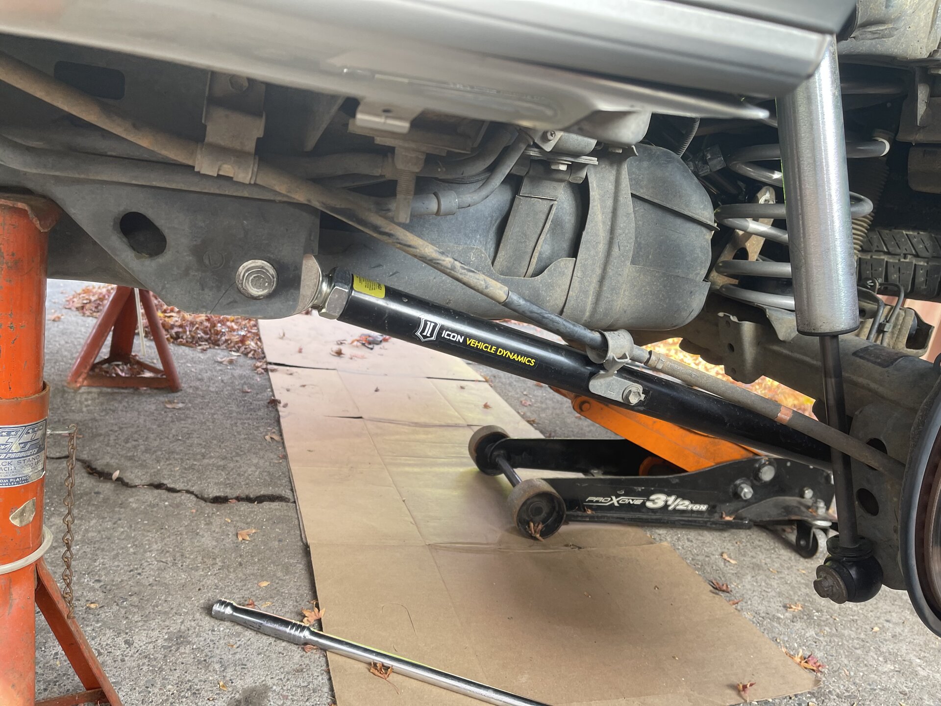

I took the opportunity to buy the Icon kit. Super nice, but.... the poping noise still persists.

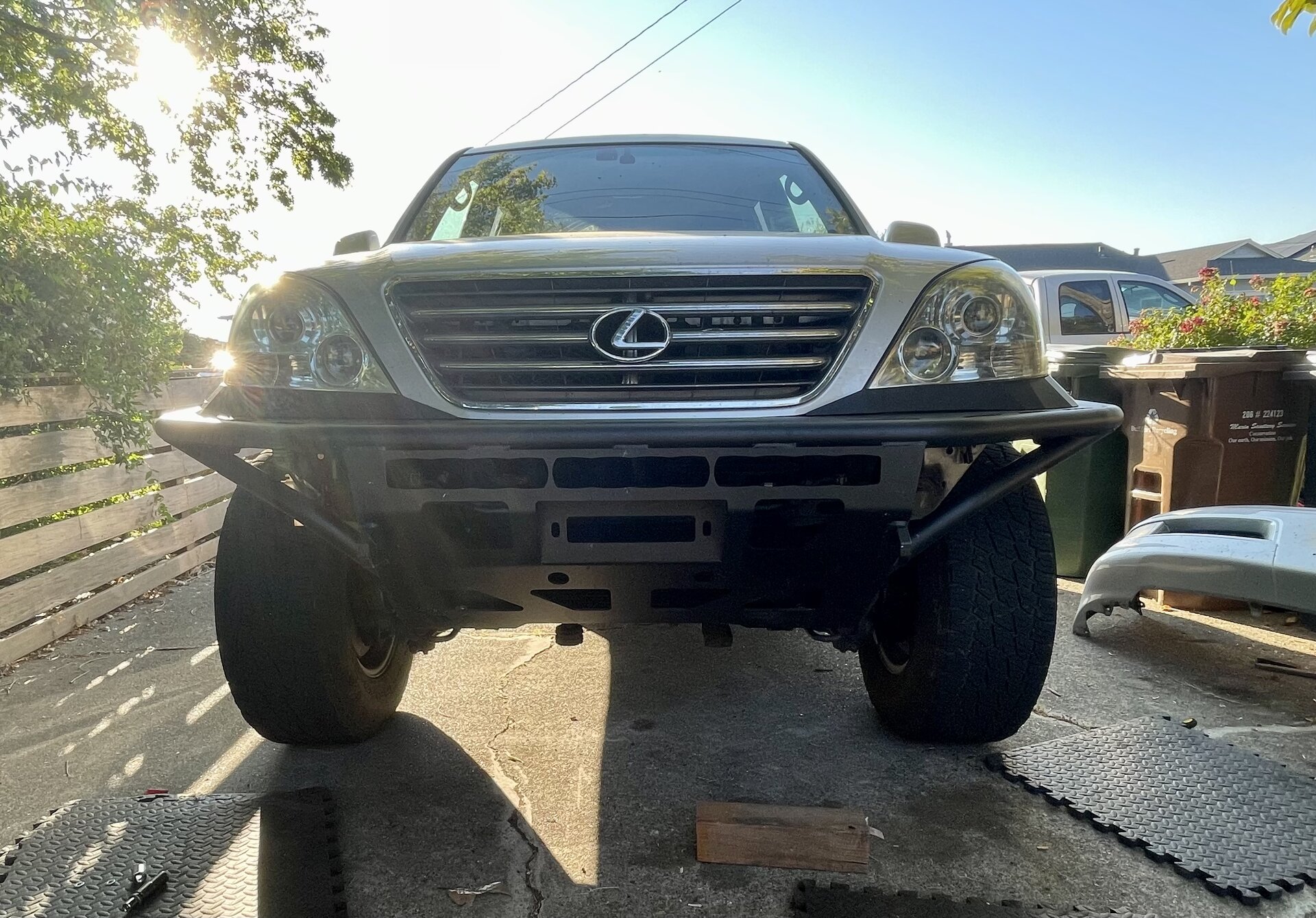

Ok, so really weird update. I have been debating on what to do with the KDSS but in the meantime I found a relentless off-road winch bumper and installed it. Poping noise is now gone?????
Yes gone. Not sure what changed but the front end is now 1” lower so I’ll have to go one or 2 notches up of the eibach kit but seriously, what the hell is going on here? Any theories?
