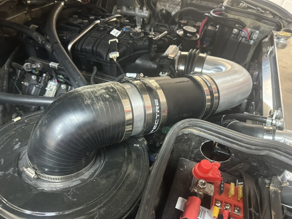

Is anybody running a K&N air filter box that more or less fits in the stock location and will attach to a snorkel….. located in more or less the “stock” location !?!?!?

Since I did not post looking for options on K&N, I did not mention I have done an LS swap, and for the last eight years I have been running with the stock OEM air filter. But strictly due to clearance issues I need to lower the assembly. Even if I make a custom box, I still need air filters that fit it.

What type of clearance issues are you having. You can see the hood insulation touches my 90 but not enough to hurt anything.
Would a 100 series setup give you the flow and clearance you need? It seems to be in the same general area but I have not removed one completely to see if it sits lower. I don't think early model tundra or sequoia options will work since they are too far forward to the radiator support.
Or the 05 4runner airbox...
Also I have some vehicles I can take measurements on can you tell me how much lower you need to be? I can try to measure the various vehicles I have to see if they would be options for you.
The other bolt in option is one of a couple Aussie made housings that use a flat panel filter from a 200 IIRC. “Moonlight” is one brand.
Seems like there’s one out there that uses a Duramax filter too. These options aren’t small though. We’ll have to know what your fitment issue is to really help.
