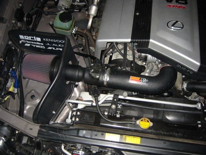

first of all, its tech. not a "cold air intake" because it doesnt have tubing for a cold intake setup. Its a FIPK err fuel injection performance kit.
heres a picture of mine installed, i have more but uh, thats the one i found first.
as you can see, it DOES straighten airflow from the filter to the TB. I personally want to reinstall my stock airbox so i can draw air from the outside or via a snorkel if i go that route. But i dont want to distrupt the airflow, so i want to get a straight tube made to replace that mess of plastic between the airbox and TB that toyota/lexus gives us.
