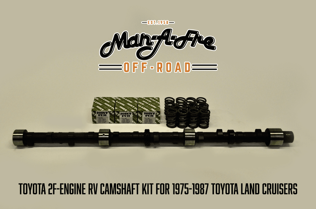

gotcha. what would doing something to the cam be?
Exactly that...
Well the engine is all back together, I think the machine shop “balanced” cam.
