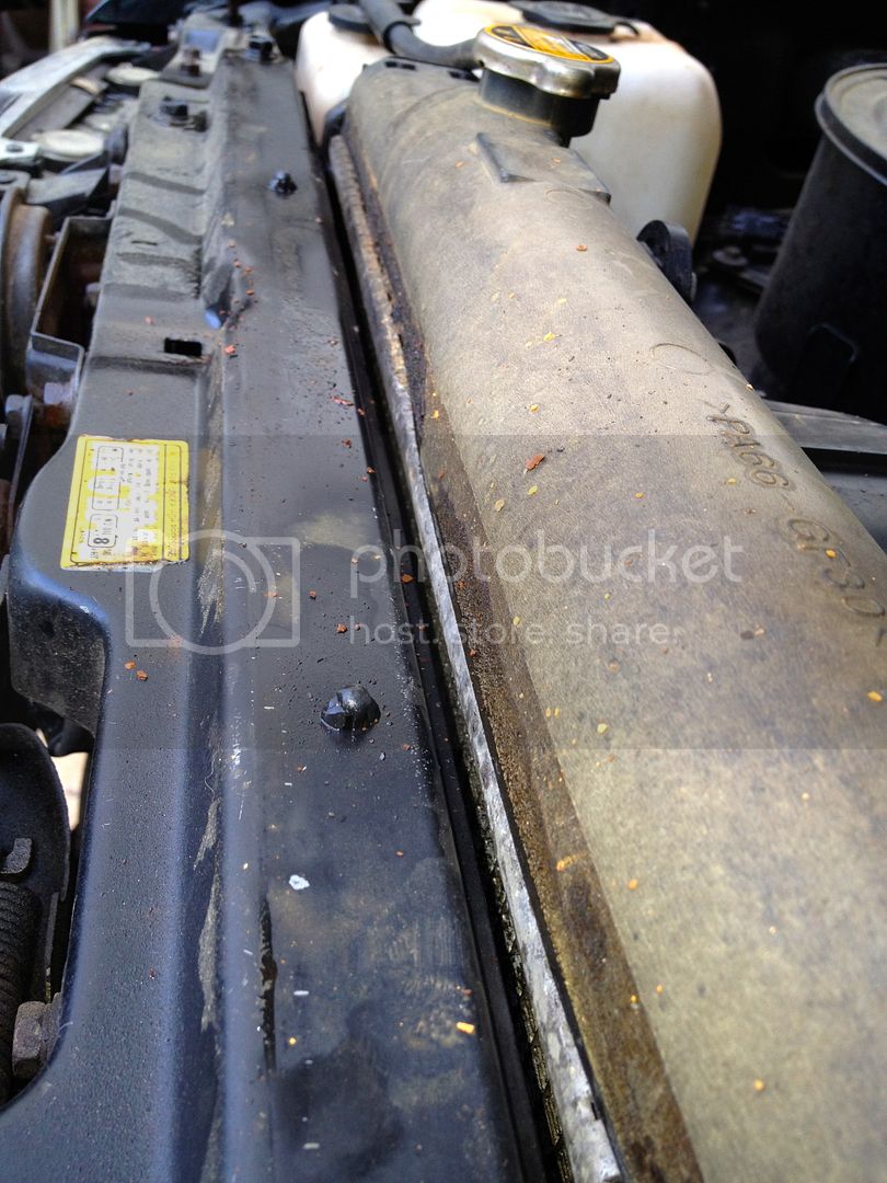

Pull over quickly, shut it down, pop the hood to start looking for the blown hose or other failure that would cause such rapid deployment of coolant. All looks fine through the mist and steam, look to the front, low and behold, I think I found the problem...

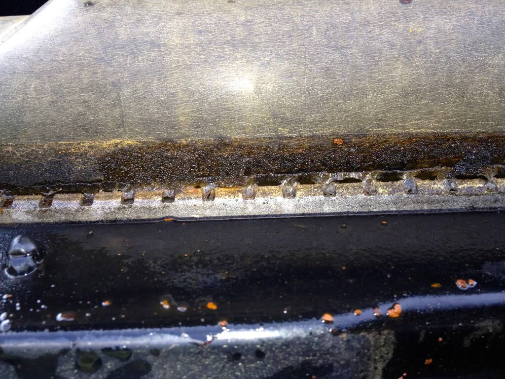

All the rust pieces when it blew were all over...

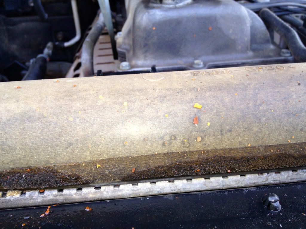

Drove it into the driveway, let it idle until it got to temp and I could see the steam starting to blow through the failure. Apparently, it simple blew through all the little tabs that hold the "tank" onto the "body" of the radiator.

A measly 160k. It wasn't hot, never ran hot (to my knowledge, my daughters have been driving it the past few years), looks to me like the radiator rusted through from the inside. When I bought it, the coolant looked "rusty", changed it out never had an issue, until today that is...
