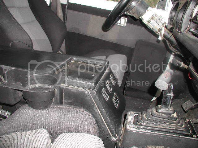

These are the switches for the power windows, rear window, and kc switches

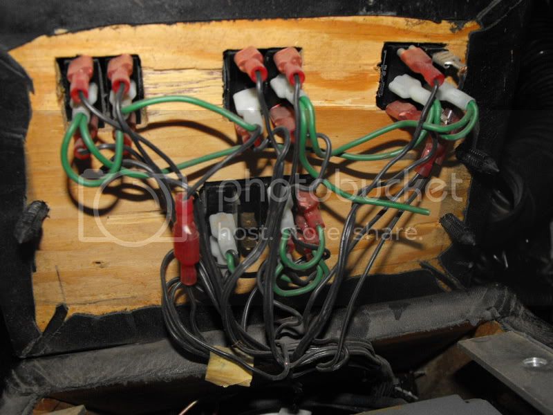

back side

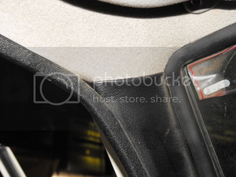

I'm not sure where the headliner came from but it was probably shop installed.
They ran the wires for the door sensor (alarm) behind the windshield pillar and tucked the headliner under the gaskets.
Where it attatches to the window it was glued down on the edges, and covered with weatherstrip.
Where the headliner met at the a pillars (seperate piece) they folded down the top piece and overlapped it with the lower piece. The a pillar piece has a "glue hem" to keep it clean.
