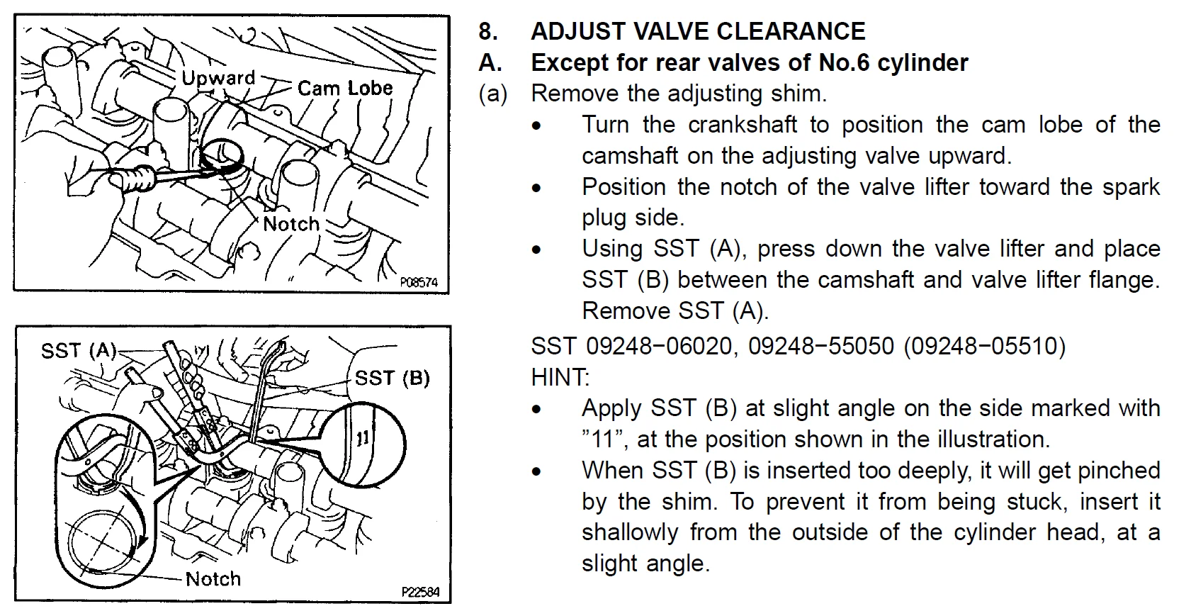

The 1FZ-FE valves aren't adjustable. Except when you're building the head.
My bad- I'm lost in 3-FE land, & forget most of you don't have to worry about such trivia! :doh:
