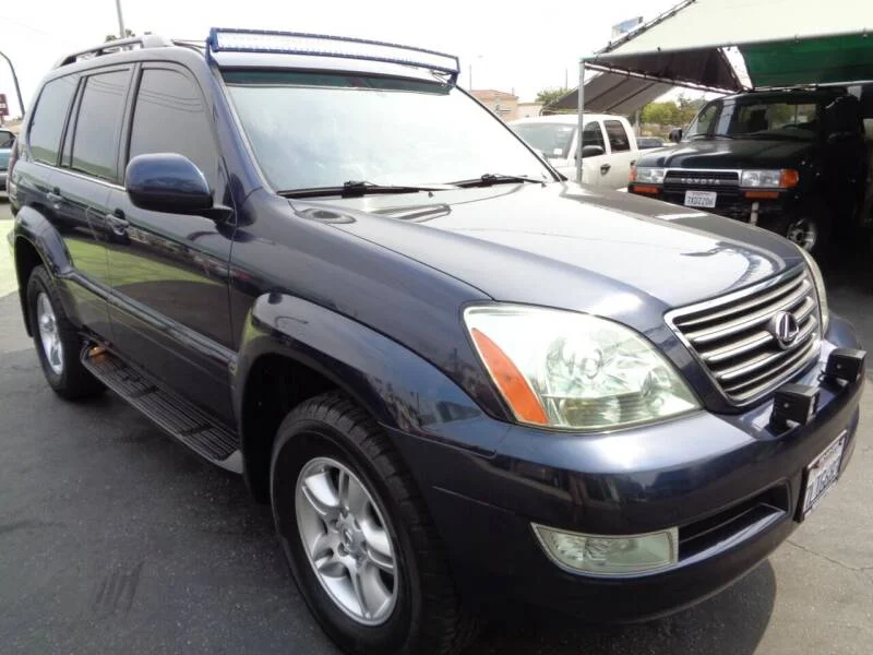

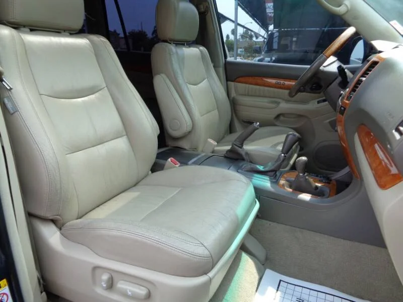

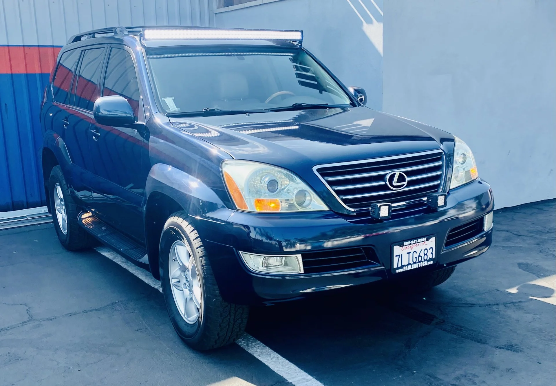

Here are some of the original listing pictures:

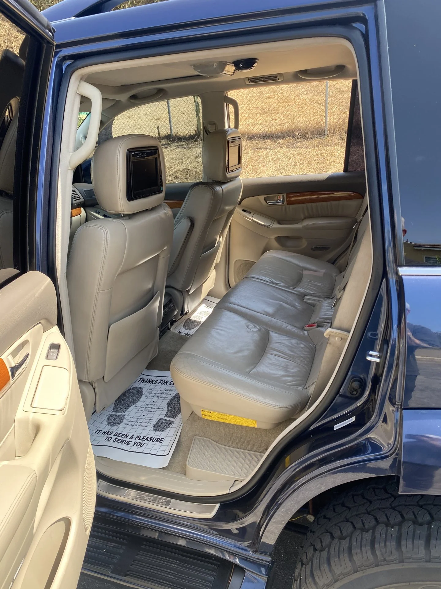

See the condition of the leather? The media screens on the back seats - not normal. Neither is the DVD player underneath the driver seat. Haha, anyway.

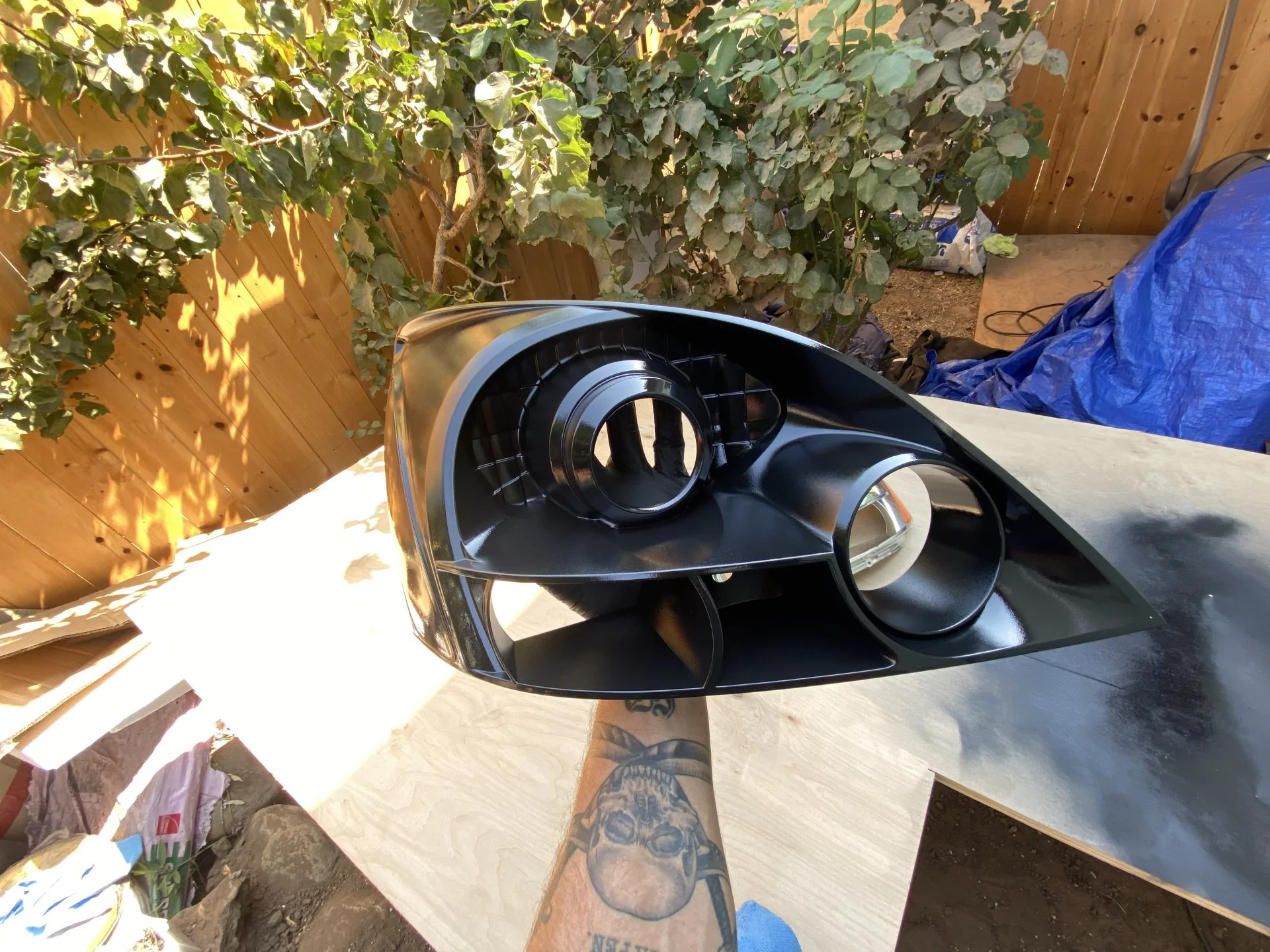

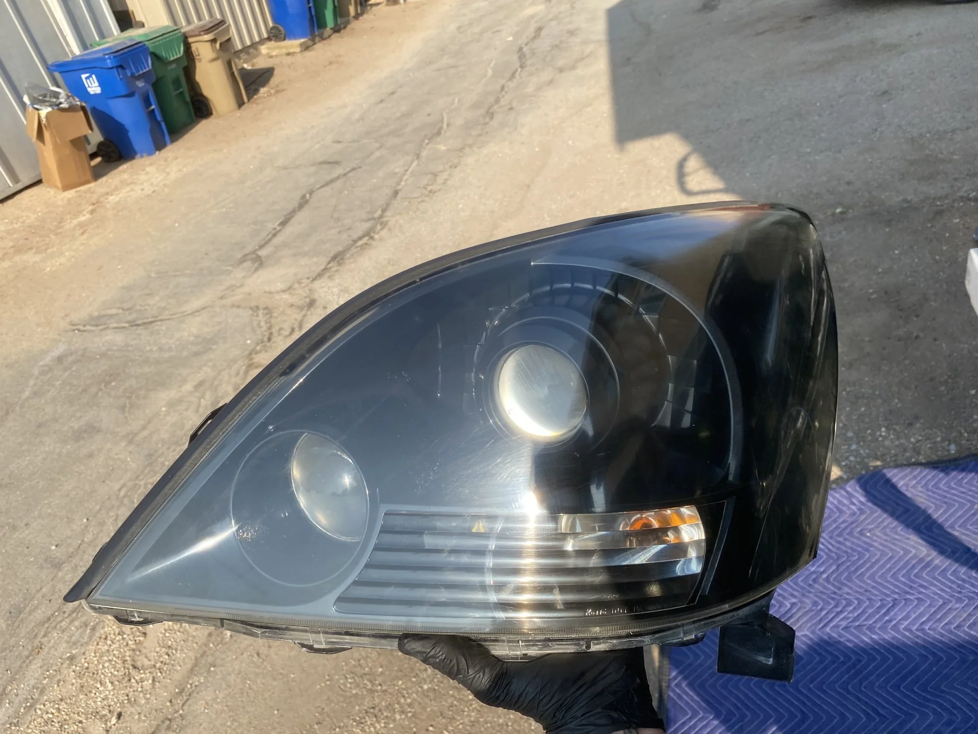

Next weekend working on the headlights:

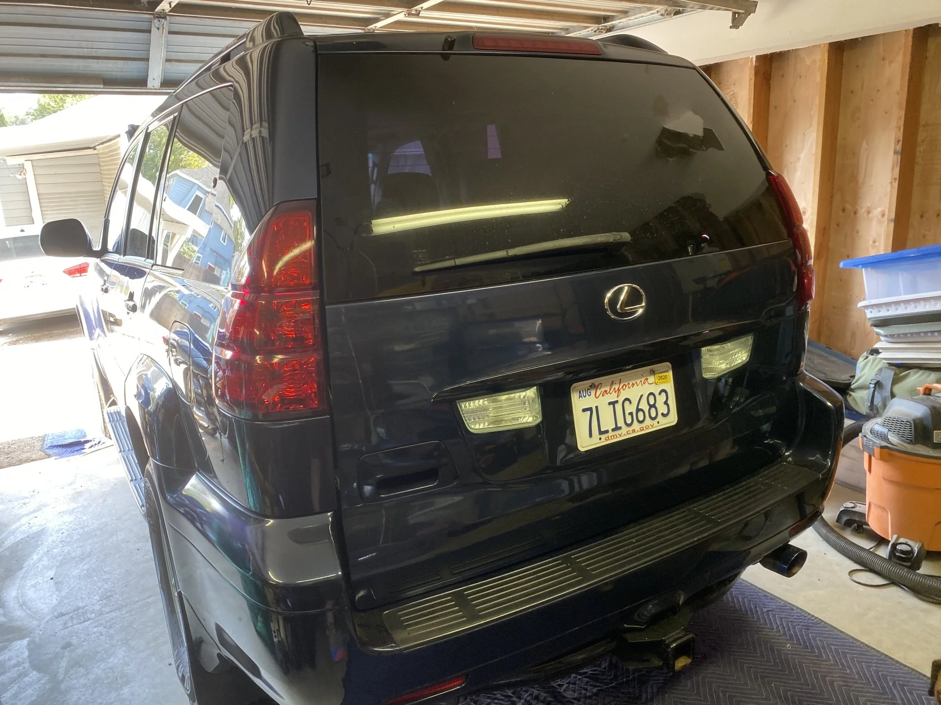

Wrapping back hatch
wrapping the chrome on the back and sides

Finished Head light mod with grille lights installed:

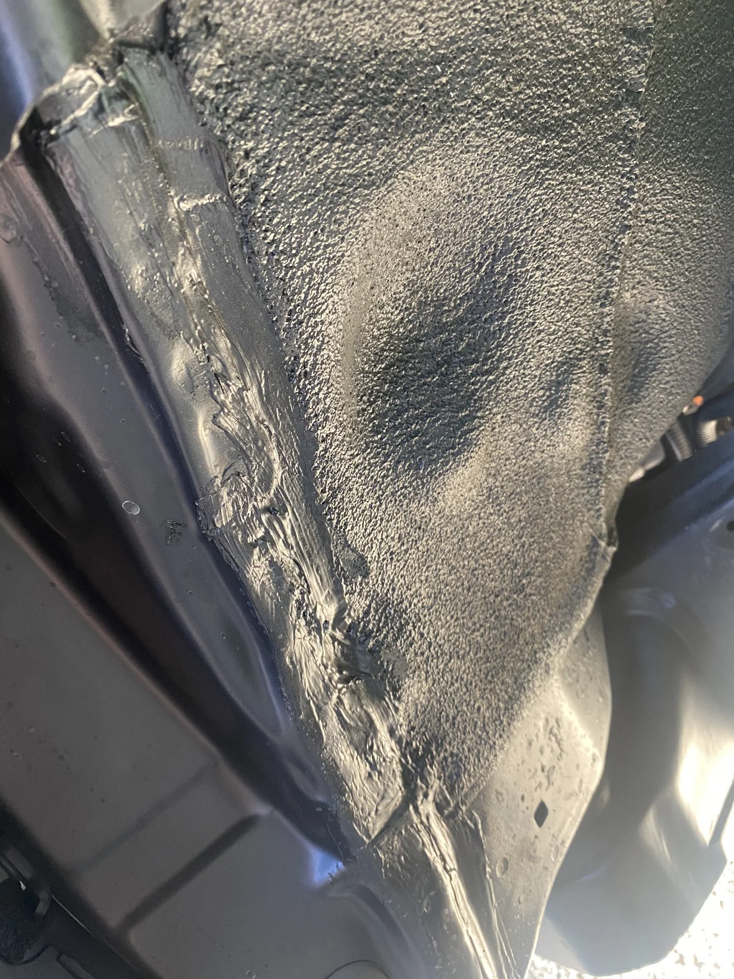

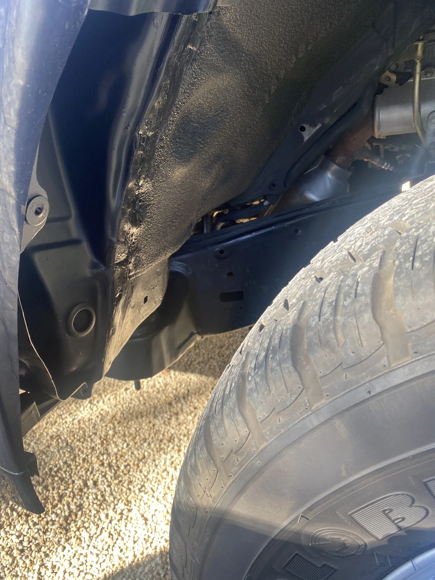

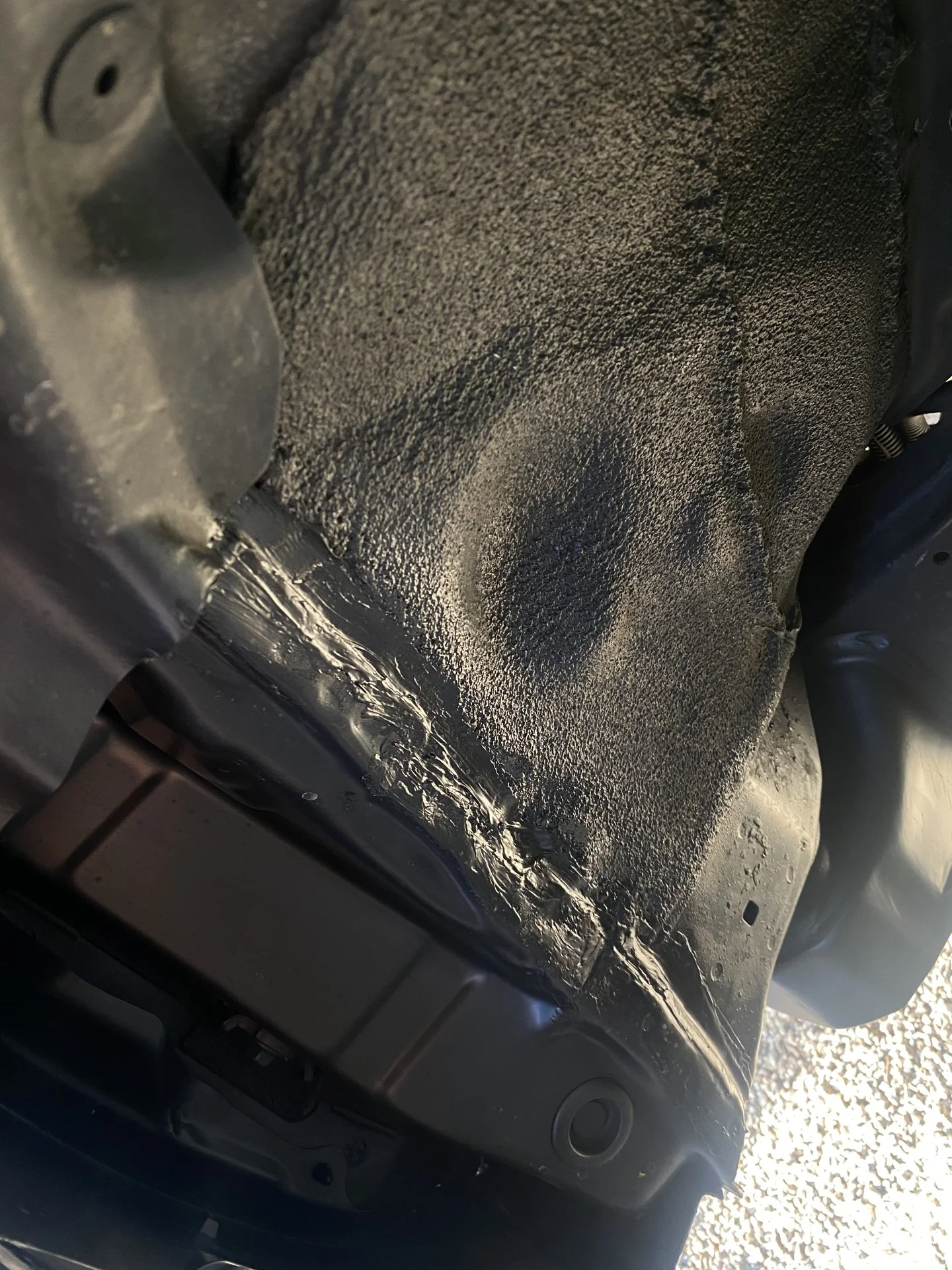

The Ironman Kit came in and I rushed to get the BMC and pinch welds removed as I sat on wheels and tires in my garage.
Post Lift - BMC Complete, Pinch welds removed:
Lift Kit Installed
Close-up of BMC

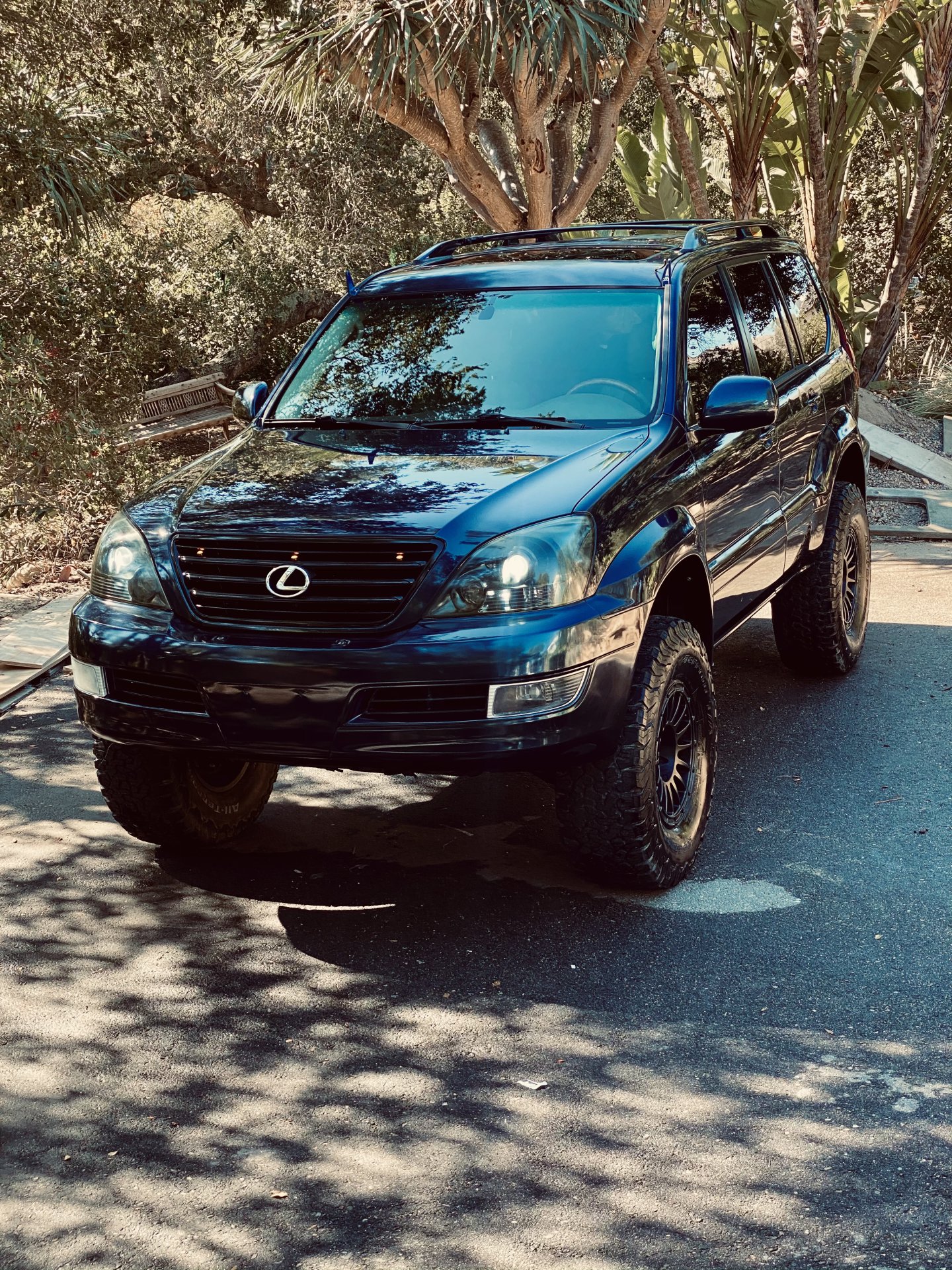

I was pretty happy with it at this point - but still had so much I wanted to do.

@jonnygx That bmc looks oem…smooth and curved. can you recommend the shop that did it?
I’ve never considered 35s, but your build is inspiring me to think about it. I would do skinny 35s like a 35”x10.5” but just not sure how bad I want 35s
Yeah I was just as impressed as well. So I found the guy on instagram. He operates out of a shop called @ssahaus on Instagram. Steve is the one that does the BMC's
The address of the shop is 17510 Woodruff Ave, Bellflower, California. I'd recommend following him on instagram and DMing him for an appointment. You can see all of his work on there and hes active all the time.
@steve.ssahaus
He's a self proclaimed Body Mount Chop Specialist.
Great work
@steve.ssahaus
Great work
I paid $380 btw. It was well worth the trip and the money as opposed to the f'n hack job I would've done. Check out the pinch welds:
Lift Kit Installed
Close-up of BMC
It kind of sat like this for a while as I recovered from the amount of money I had put into it on mods and I began to refocus on the CV Axles and LCA's that STILL had not been done after all the suspension work.. I know I know.
