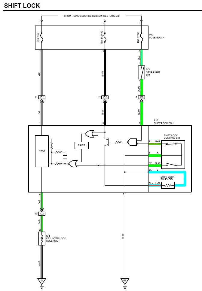

Your shift lock ECU controls shifting out of park.
It has 3 inputs:
1) 12V from the stop light switch
2) 15A ECU-G fuse
3) 15A CIG fuse.
Check those fuses. This is just from a 91 EWD, which might not match yours.

It has 3 inputs:
2) 15A ECU-G fuse
3) 15A CIG fuse.

No, wiring isn't necessarily good if fuses are still good. I would ohm out the wiring to check. A short to ground would blow a fuse, but a break in the wiring would not.
I would inspect and test all the wiring between the brake switch and the shift lock control and the ECM.

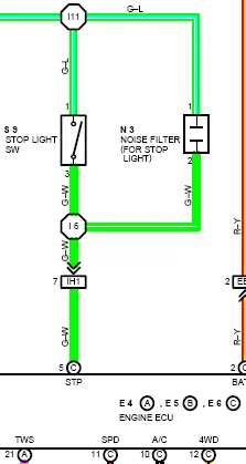

There is a noise filter as well, shown in the circuit to the ECM.

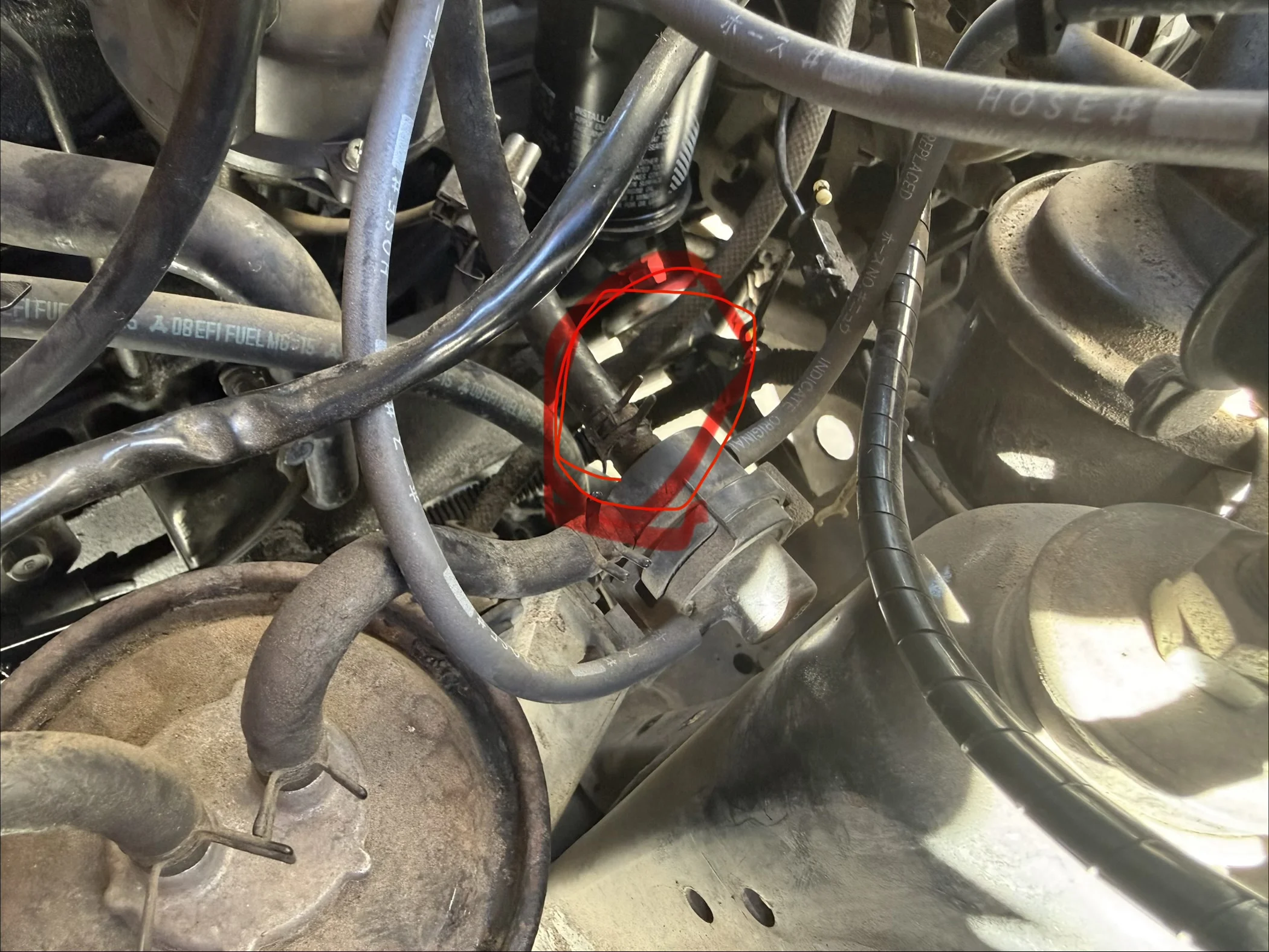

Thanks for the help, I’ll dig into the wiring. Good thing is I found the reason of my rough idle. One of the vacuum hoses near canister was came undone god know how that happened. Plugged it back into place and it’s fixed idle issue.
