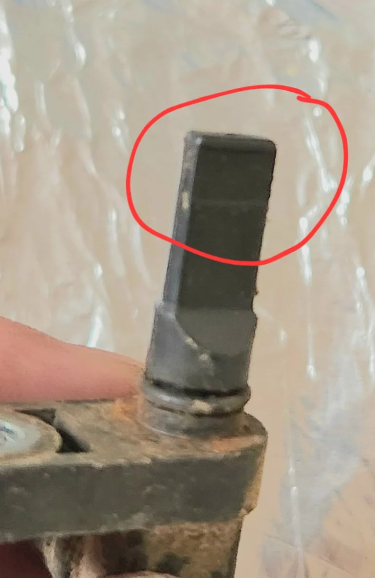

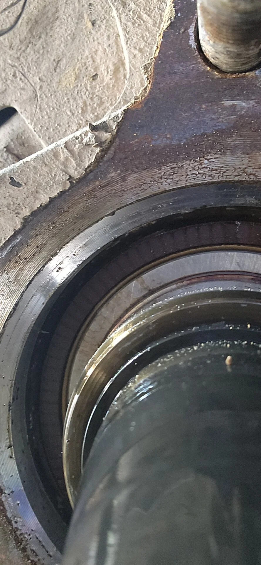

Mine is coming back too. So a couple weeks ago I remove all 4 of my speed sensor to see if they got any debris on it. All 4 are fairly clean but the right rear got slight groove. I remove my rear axle and I can feel the bearing got slight play. I cannot feel the play with the axle still installed.
I bought a set of new OEM wheel bearing and special puller to do the job. Haven't got the time to do it yet. Maybe next weekend. OEM rear wheel bearing are pricey. Non toyota branded Koyo are available and they are a lot cheaper. The tools cost me $225 plus a press of you don't have one. But the estimate I got from a shop are $1400 to replace both rear bearing.
