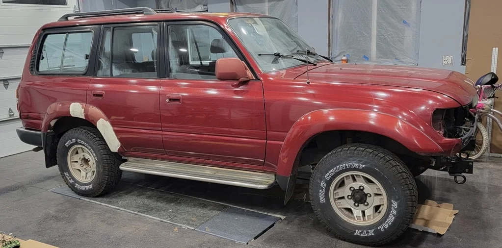

Anyway, here's the future Island Cruiser I just picked up to fix and then ship off to be my island rig here in the Bahamas. It's a 92 and obviously needs a bit of work, but has only 150k on it.
The goal is to get it back to good condition, mechanically sound, as many preventative fixes as necessary, and then stick it on the boat. Importing vehicles (and most anything) here is crazy expensive so we're doing as much as we can before without making it fancy because the import duty (85%) is paid based on the vehicle value at and another 10% VAT on top. Ugh.

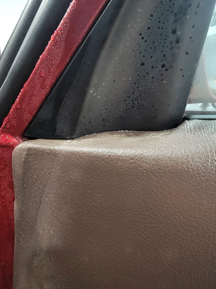

Has some fairly light front-end damage and other misc issues, but the first thing to take care of is water intrusion. Seems like possibly coming in through what I'm assuming is a bad door seal on the passenger side, or possibly a break in a sunroof drain hose? Water seems to be coming down the door vs directly pooling onto on the floor (which is wet) or in the headliner.
Does your LC have a sunroof, if so make sure the drains are free and clear. They can clog and cause water to enter the main compartment.
Yes. That's one of the first things on the list to check top to bottom with tie wire or heavy fishing line. Seems like it's running down behind the door's a-pillar cover for lack of a better explanation.
If that is where the water is that is your issue, clogged sunroof drain.
Haven't had much detailed "look" at this truck yet but my buddy and I did a video call a few days ago to give me a virtual tour. Smog pump has been removed, the airline to the intake hasn't been blocked off (hose is still laying open ended by where smog pump was)
Overall, it looks to be in pretty decent shape other than the obvious front end issue . It hasn't moved too many miles in the last few years. The paint and overall condition is better than I expected, it has the tool kit, owners manual, 2 keys and couple service records. Both front seat outer bolsters are a bit flat, there's a small tear on the seat side-skirt on the passenger side, a bit larger on the driver side and small hole in the fabric on the driver side of that bolster. It has most of the parts to put it back together other than clearance lights and both headlights need to be replaced and maybe some front trim pieces. The front bumper is a bit bent and missing the $90 plastic end cap on one side.

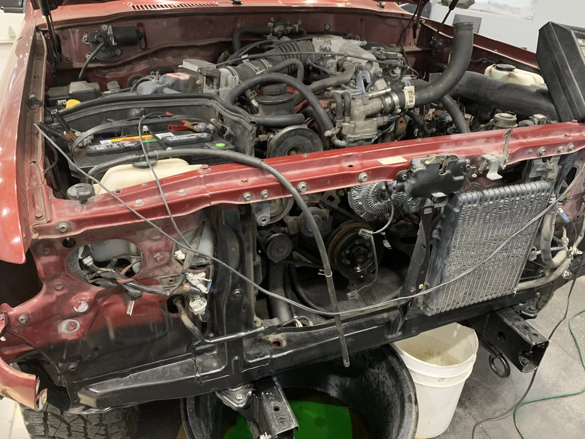

Ok, the plan is (always tentatively, since flying into the US requires a 1 day before flight nasal cavity search now) that I'll be flying to FL this week, grabbing some stuff from storage and heading to the PNWet on Saturday. Then I'll be camping in my buddy's garage and start some actual work for a few weeks.

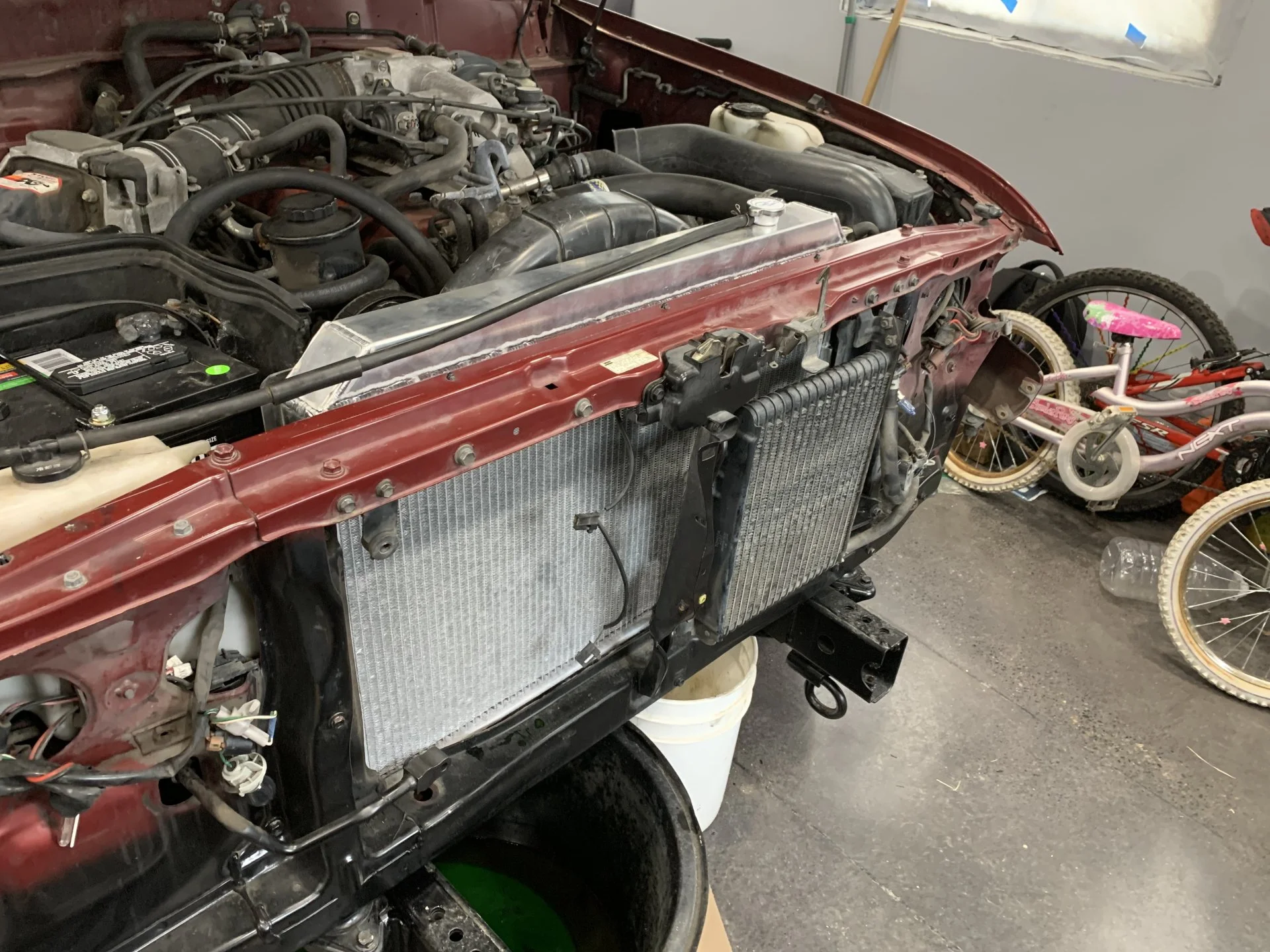

Been a bit slow going as I've been focusing on the sunroof leak (without much progress - it doesn't seem to seal very well and the single pinch welds are ridiculous for taking in any amount of water so for now the rocker plugs are pulled) but the new radiator and fan clutch is in.
Liland brand, not quite a perfect fit and took a bit of corrosion.
