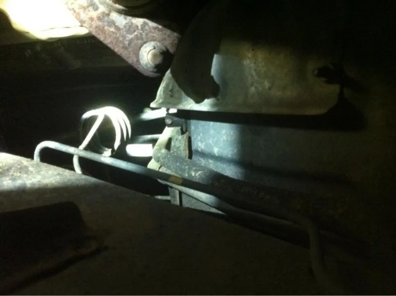

Is this the AC drain?
Mar 17, 2010
78
1,279
Dallas
The little nub with the water droplet on it? Is it supposed to have a hose attached to direct it away from dripping on my sway bar bolts? The picture is of the underside of the passenger footwell?
I took some 5/8" tubing and a hose clamp and rerouted to my wheel well. The nub a semi soft rubber, so I didn't crank it down too hard, but it seems to be working. The 5/8" was a little too small so I heated it up and stretched the opening just a bit.
here it is attached to the drain
and where it exits into the wheel well
