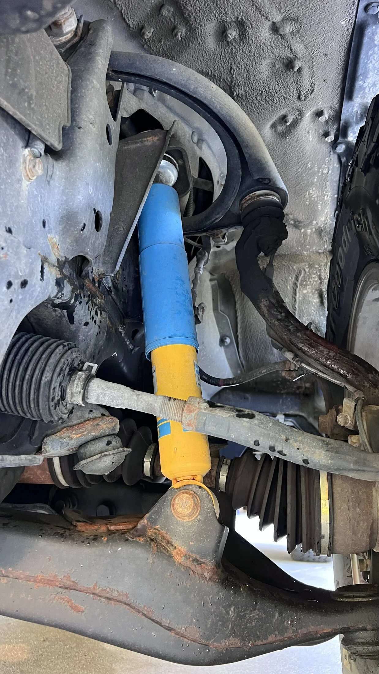

Hi everyone. I'm a newb. I bought this 2003 LX470 earlier this year. The AHC system indicator sometimes shows middle and high, but the car never moves up or down and drives great. The person I bought it from sold it for his older dad. He didn't know much. I assume the Bilstein setup replaces the AHC, though the equipment is still there and I don't see any cut lines etc. Can someone tell me what they notice from the pictures? Thanks for any help

I see the front height sensor so that explains the indication between neutral and high. Did they leave the fluid reservoir under the hood?
They did leave it. I was so dumb I got fluid and put it in there thinking it was low and that's why it wasn't working right. It leaked out slowly...
Any record of them changing the front torsion bars as well?
