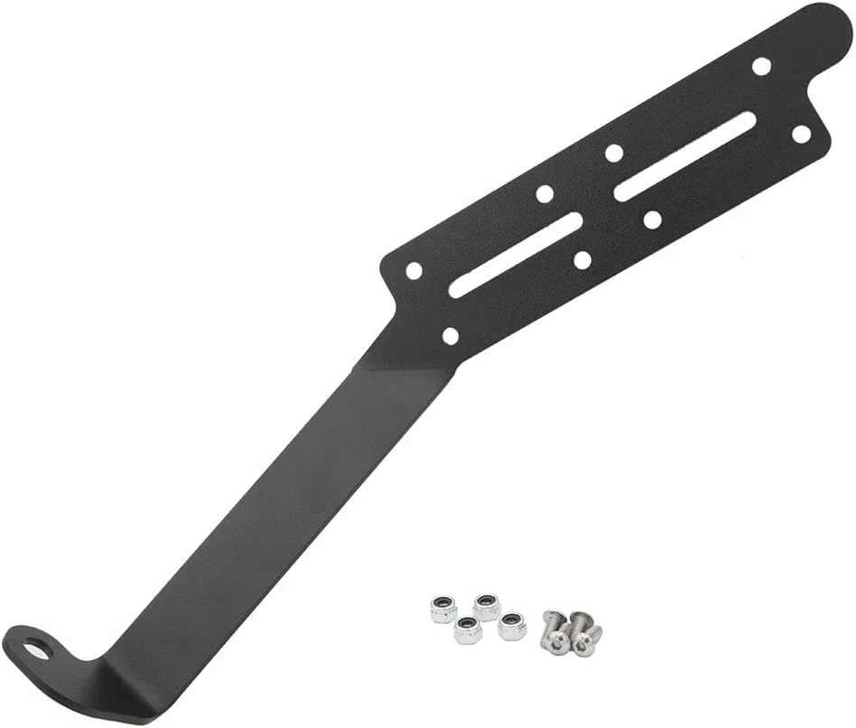

I think Rugged Radios makes them for 4Runners and Tacomas.

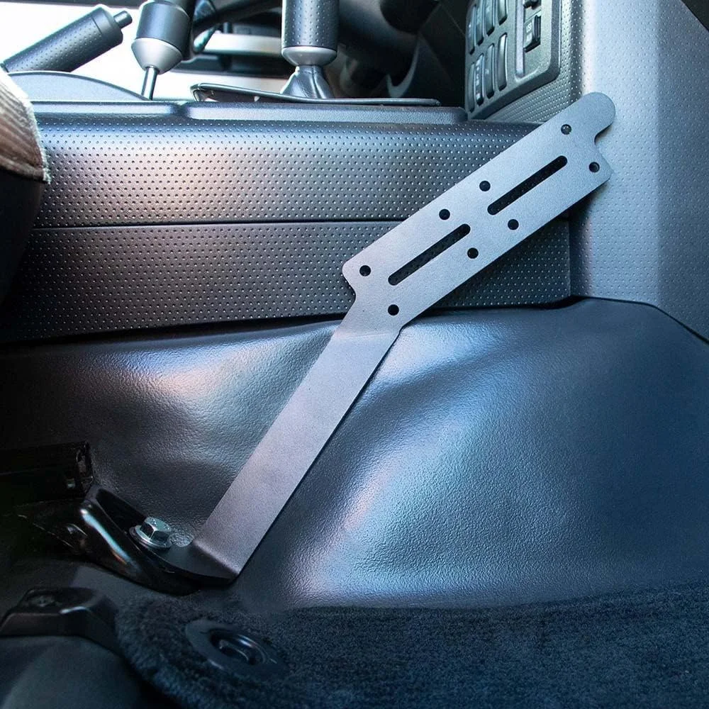

Yes, the Rugged Radio mount works. I double stacked a GME XRS-370C4P-U and a Cobra 29. I did not make any mods to the vehicle, just bolted the mount using the supplied longer seat bolt. The mount is snug against the carpet so it doesnt move but you can pull it away to install bolts. I ditched my cup holders a while back, last thing i want is liquids near my electronics.
Hope that helps some of you looking for a quick and easy solution.
Many thanks for steering me to their website.
