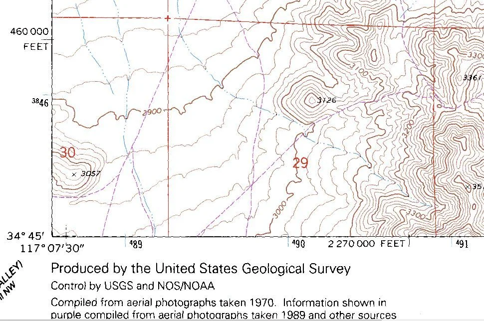

This is an example;
In the picture you see the "section numbers" "30" and "29" I'm looking for the gps coordinates of NE corner of section 30 and NW corner section 29.
I could get a micrometer and and do some old school math, but I I'm looking for an overlay that has these sections on it.

What's the name of the USGS map. I have an avenza account....I can check if they have the map. I can also check on Gaia GPS.
I'm assuming you can't check yourself.

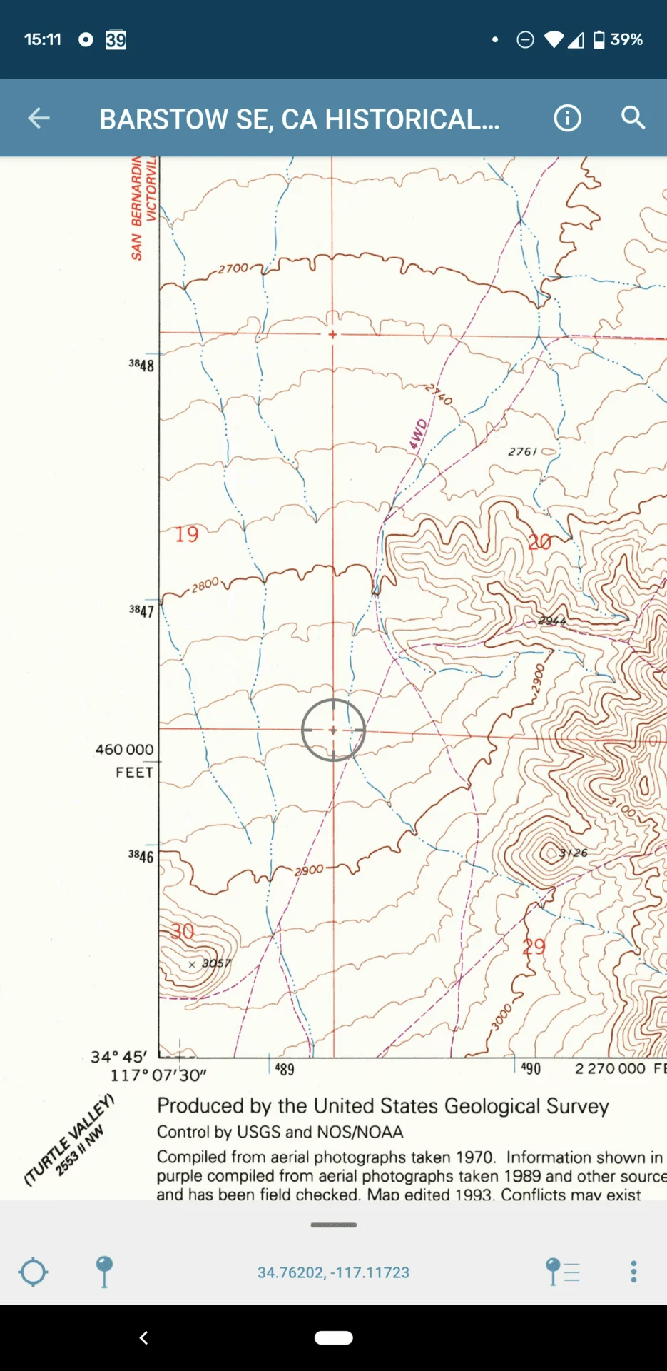

Actually it's the Barstow SE quadrangle. I found it on Avenza map. Here you go,
The coordinate you want is at the very bottom of the image. It's the coordinate of the cross hair/ target on the map
If you enter that on Google Maps as 34.76202, -117.11723, you get the aerial photo: 34°45'43.3"N 117°07'02.0"W
