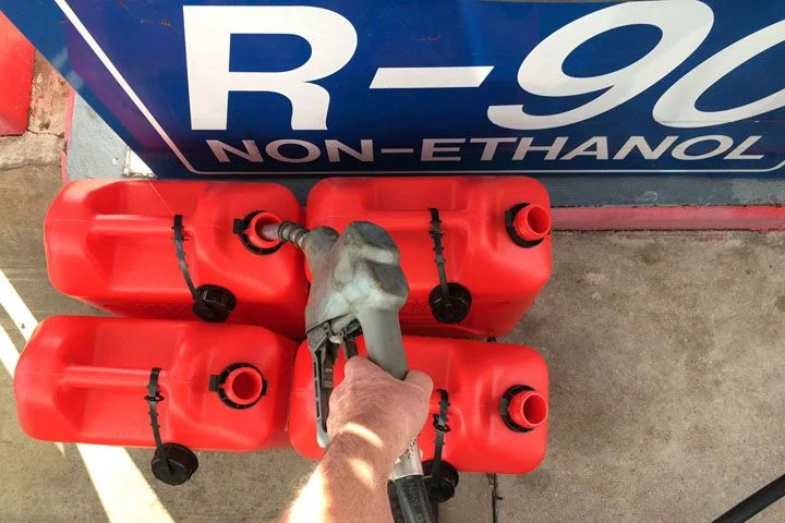

The only fuel I put into a container is Rec-90 with a dose of Sta-Bil.
