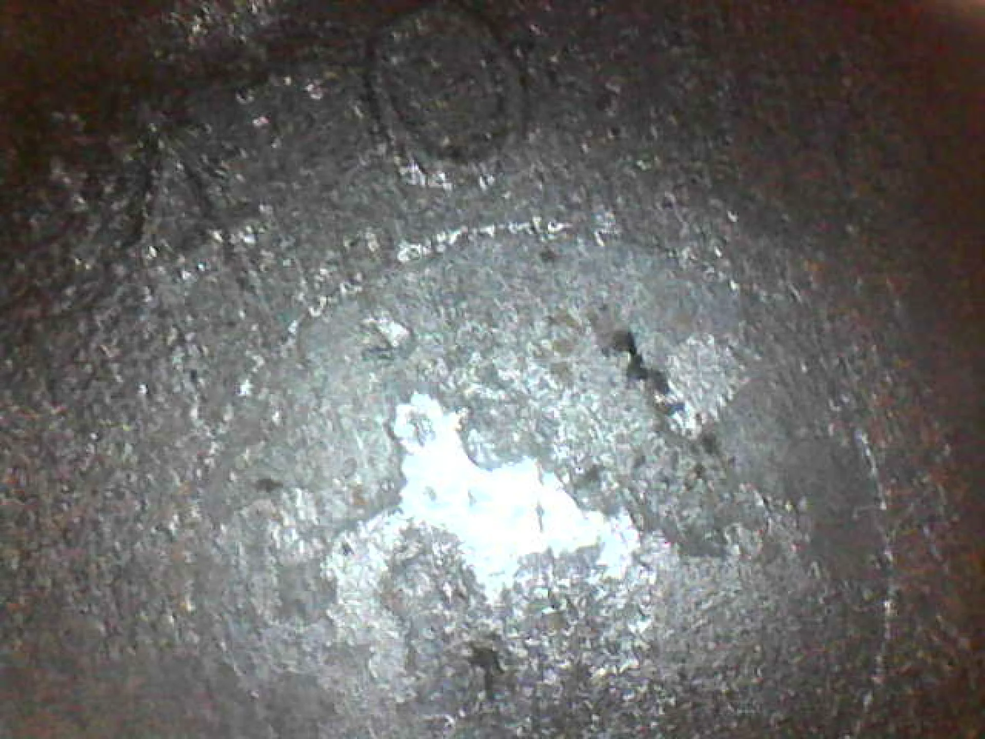

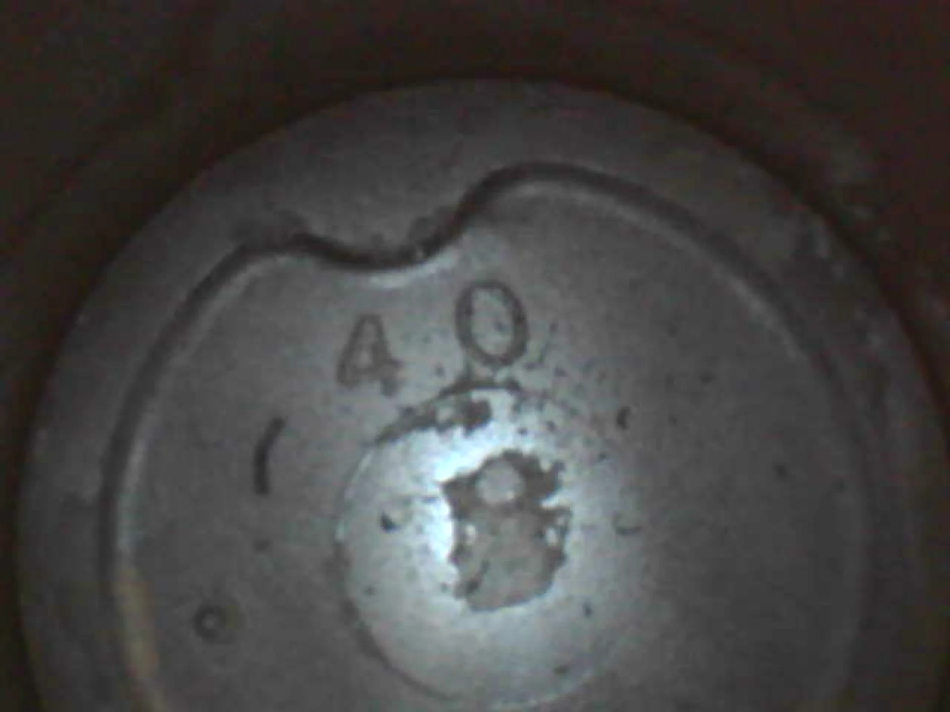

I have a friend who retired out of the racecar building business who warned me against EGR delete, He said that more times than not, you actually loose MPG. I've heard others say the same, but it is an 80 so not sure MPG is really an issue. right now my 80 is my only driver, I have wanted to try the landtank MAF swap. i regularly use only 87 octane ethanol free gas and once a year put in a bottle of fuel treatment like seafoam or the like. These are what my pistons look like after a few years of my ethanol. They were completely covered in carbon when i got it.
