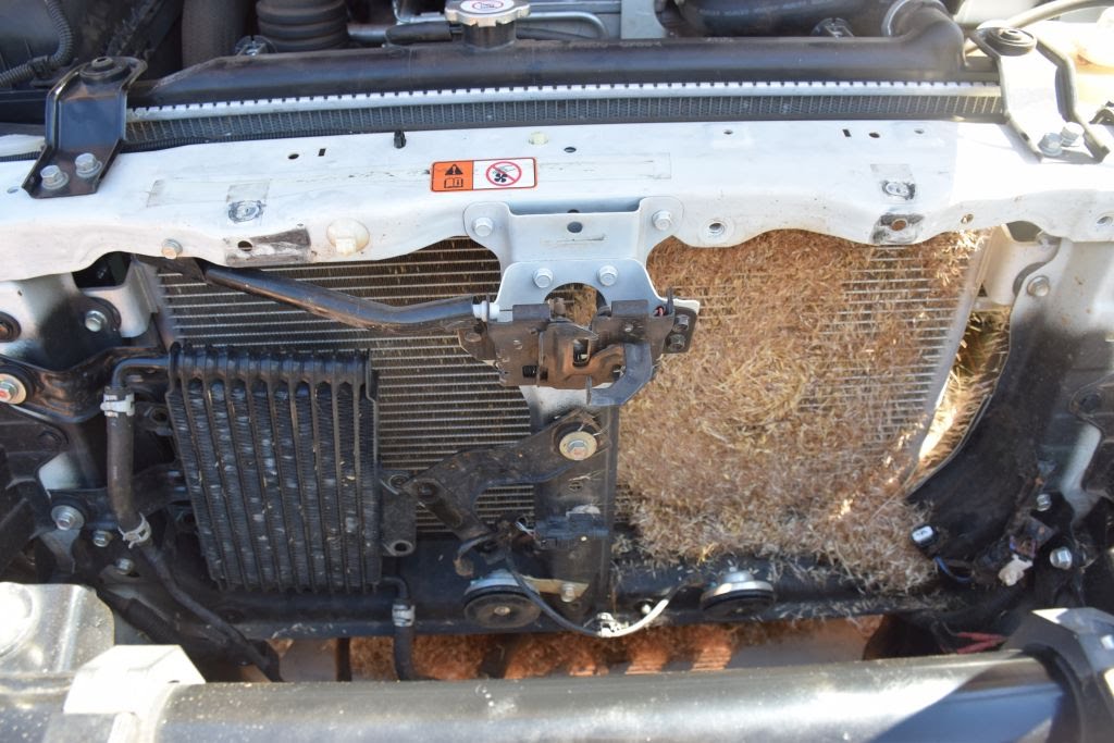

and here's a mate's latest model mitsubishi (god knows why he buys the things)... This is after removing a bunch of junk (body stuff) to get to the front to clean it out. He wasn't running a screen at this point...

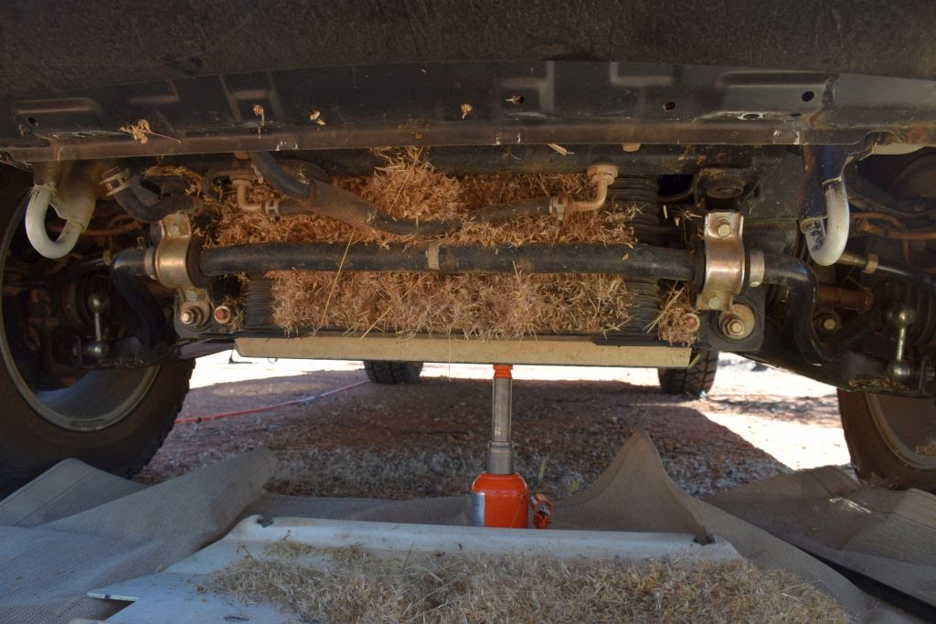

This is just madness. Mitsubishi in their 'wisdom' mount the intercooler radiator under the engine and in front of the diff - normally there's a bashplate here, that he's had to remove to clear the spinifex out of the i/c radiator. Totally cookoo. Bashplate is on the ground in the pic.

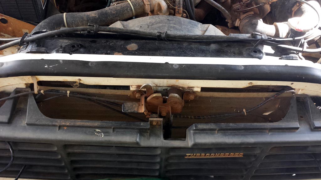

The mesh I run on my patrol. Advantage of the old patrol is that there's very little junk in front of the radiator and behind the grill. So very easy to get in there to brush the debris off and it just falls down to the ground.
