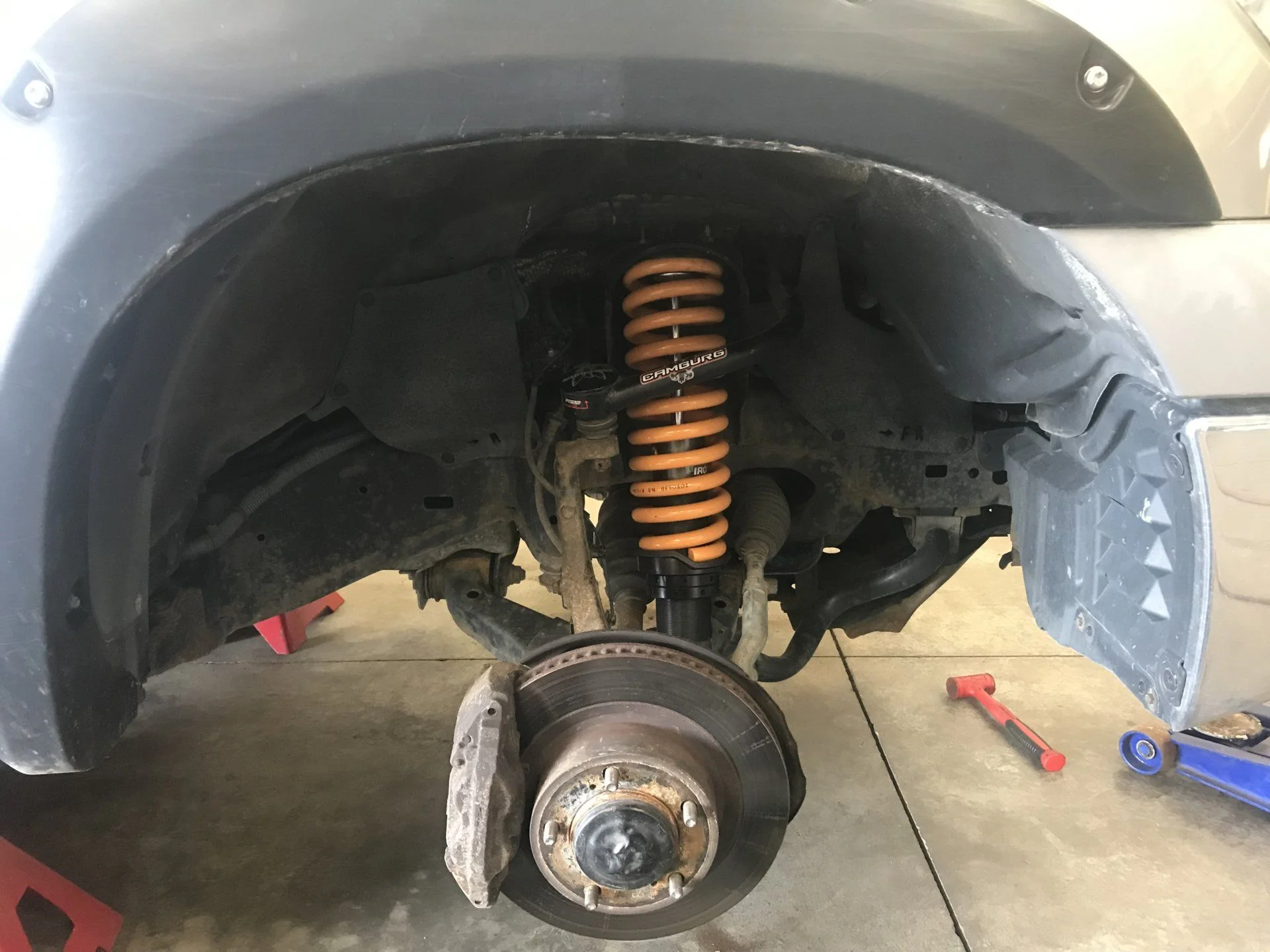

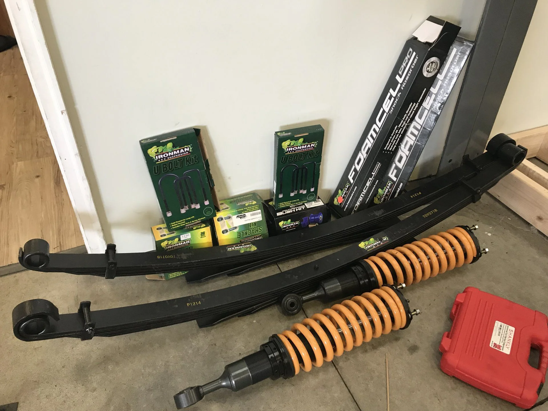

I saw that Ironman4x4 America was up and running out of Portland, and reached out to Luke to ask about the kit. I was already sold on the Foam Cell Shocks from my cruiser, but learned that the kit came fully complete with adjustable coil-overs, full 6-leaf spring pack out back with u-bolts, and greasable shckles, bushings etc... I did have to assemble the coils on the struts, and these things are incredibly beefy. I bought a Shankly spring compressor on amazon, and it worked like a champ.
the performance coil springs are supposed to give 2-2.5" of lift, and then you can dial in the adjusters on the strut body to get the desired lift you want. I went up to 10" from center of the bottom mount to the lower collar. the recommended is 9.65" so I was thinking i'd get anywhere from 3-3.5" of lift going this route, as I already have aftermarket UCA's that can handle the additional angles, and a diff drop already installed.
I think i'm right at about 3.5" and have the 60mm of downtravel. was gonna see if they settle at all in the next few weeks, but it aligned fine at my local Toyota dealer. I may end up going down a 1/2" in the future. I'm just a tad high by a 1/2 in the front

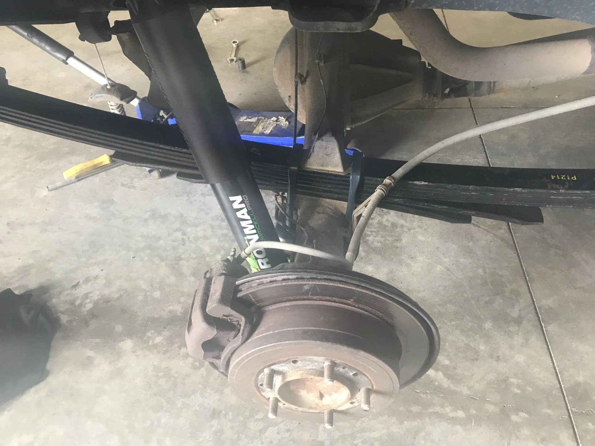

the springs out back gave me a solid 2" of lift over stock.

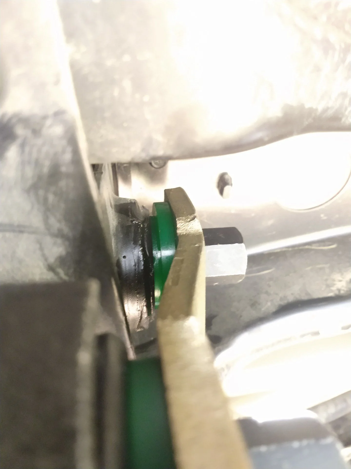

How do the shackles fit? any gaps between the shackle/bushing and the frame?
No, the new leafs come with eyelet bushings that’s sit flush against the shackle. They’re greasable as well with a recess for the zerk fitting
That is what I ended up with after my install. I'm working with Ironman to iron it all out.
Yes I tightened everything down.(including Pin) The guys at Ironman have gen 1 also on their trucks and seem to think I have the wrong pin.
