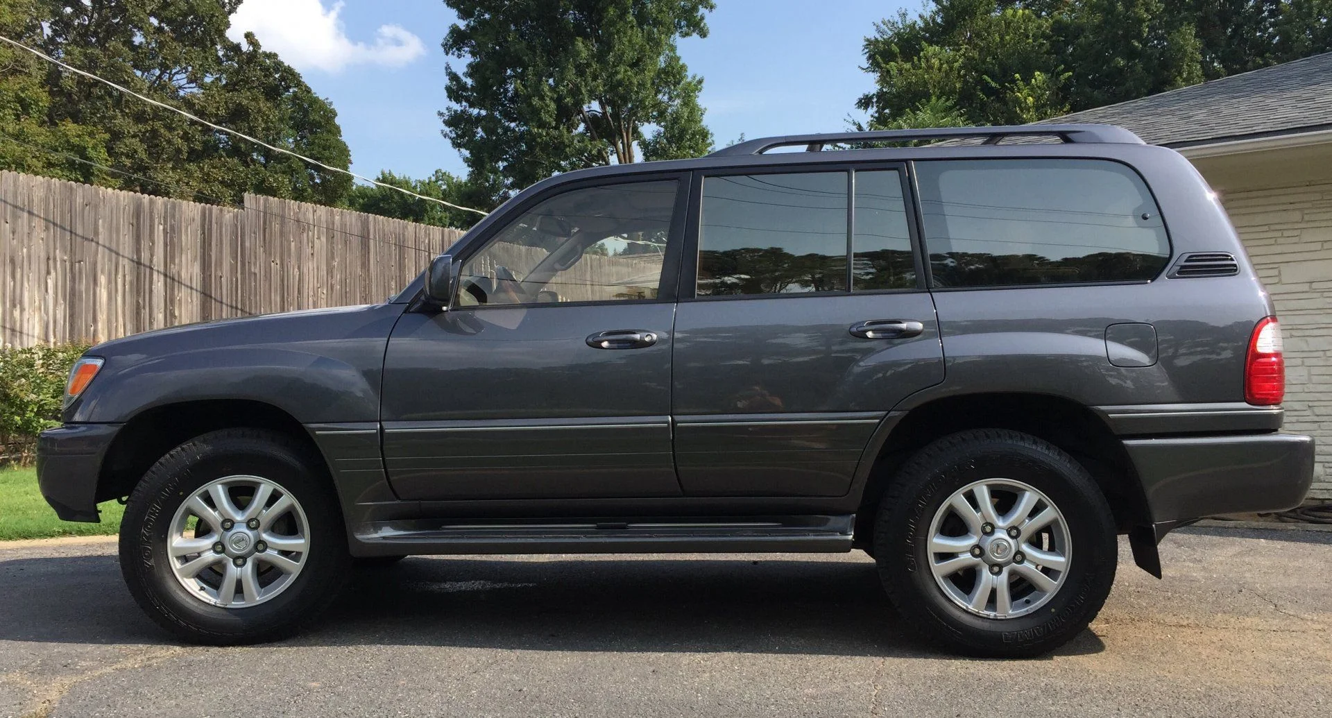

Yep, raising the front a tad. Wanting a more level stance, but I haven't taken measurements yet.
Just wanted to tell you I love that color! If I could have gotten that with Ivory interior I would have been all over it.
I love this colour as well but I was a lil different and went ahead with 2015 Metallic graphite which has a lil blue flake came on the Hilux Urban Warrior.
