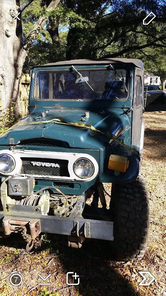

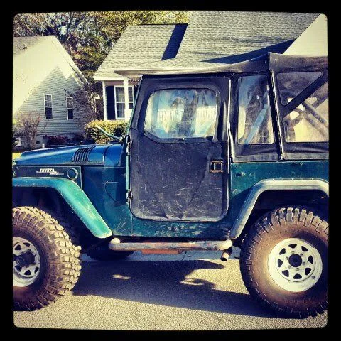

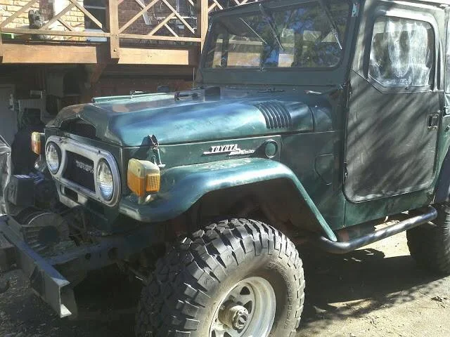

Hello, per the quick read course when registering, I am introducing myself. I have a 1969 Land cruiser. I've been reading MUD since I got the 40 about a year ago. I have gotten a ton of info and enjoyed many stories on the forum. I am not a mechanic, I'm an engineer. I listen to car talk and I figured if those bone heads can figure it out, then I can too. I've been doing OK I suppose. My 40 is atypical to say the least. A PO had some modifications, a lot of which appear to be done with shortcuts. So I'm fixing the shortcuts, trying to restore, and make safe (new brakes and such). I call my 40 Frankenstein. It has an Isuzu diesel. I'm still trying to figure out more about what it came out of. My friend and I changed the clutch. Right now I'm wrapping up that project and hopefully I'll soon be converting to front disc brakes. The fill plug on the transfer case is stuck so I think next step is either impact wrench or heat it with a blow torch. Some pictures of Frankenstein are attached.

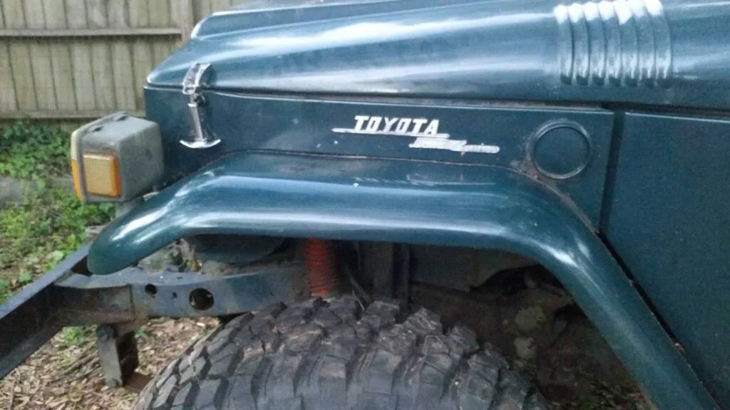

FJ4068944 is the frame number. What is the frame number for? I got the fill plug out! I soaked it in PB Blaster then waited a week bc I got distracted with yard work. I sprayed it again about 30 minutes before I started working on it. I used a six point socket with 12" breaker bar. While putting a lot of torque on it I hit it with a rubber mallet and then with a hammer. I wasn't hitting it when it came loose. I'm not sure if the PB Blaster was necessary because there was no rust on the threads or any where around it. I didn't expect any really with all the oil it is usually soaking in. But any way, got it out. I filled up with new gear oil and reused the plug since it looked good. I also installed these new hood latches since the old ones were non-existent.
