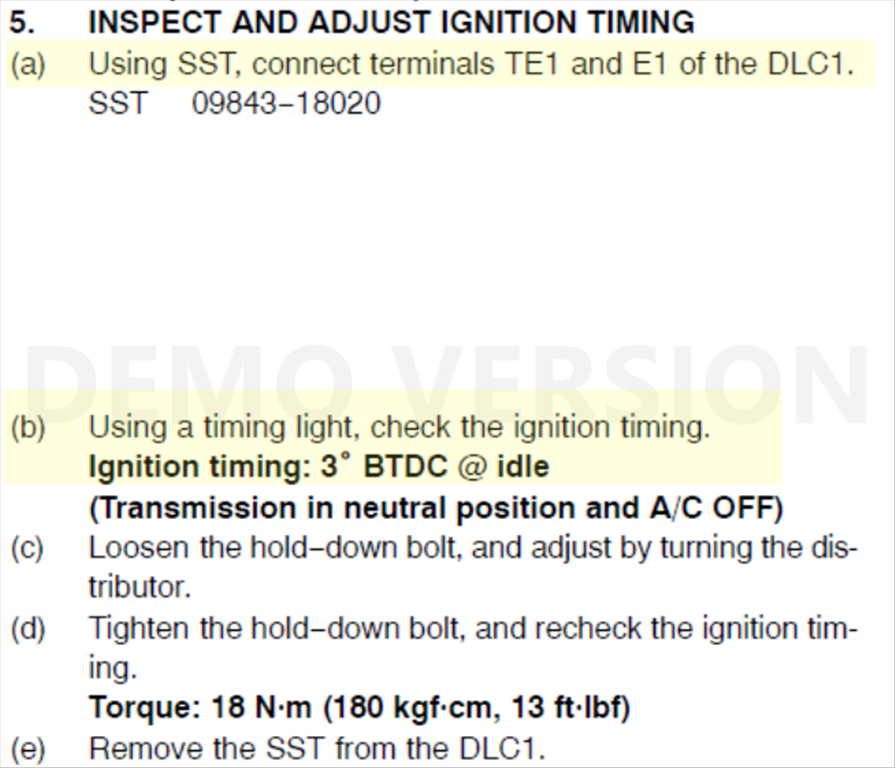

My scanner says it is 4 or 4.5 degrees at 740 RPM
Why 740 RPM? Idle should be 650 +/- 50 RPM when warm and in park or neutral.

At idle of 615 RPM she is timed at 4 degrees when at operating temp.

Are you still getting this measurement from the scan tool? If so, that is not the proper way to check/set timing. You have to set the ECM into "Base" mode and measure with a timing light as follows:
BTW, that SST is nothing but a "bent paper clip", so don't get wrapped too far around the axel if you didn't know what the SST is.
@Dangerson You might benefit from more static advance too.
You can increase timing to up to 10⁰ BTDC.
increasing advance in mine gave it stronger pickup from idle, and stronger mid range pick up.
Not all 1fz-fe will tolerate 10⁰ advance. Some will ping with that much advance.
Set advance with timing light, and paperclip SST in the diagnostic port.
