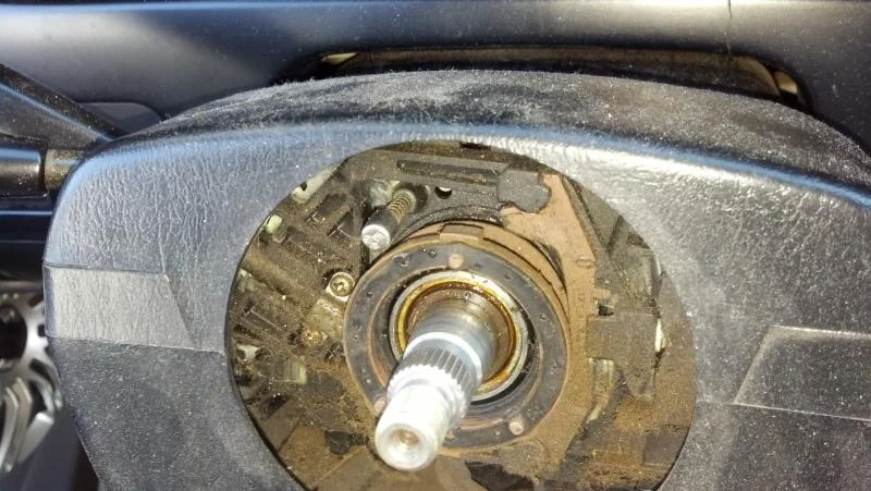

Here's what you find when you get there:
attachment.php
That's the plunger in the upper left hand. Worn down to a nub.
5: Put a piece of metal across the plunger and the stud in the middle of the column. If the horn sounds, this is your fix.

Looks like this:
attachment.php
9: Reassemble. Note the three brown nubs sticking out of the ring around the column. You will use the top one as a guide to aligning the wheel when you put it back over the spindle. You will need a flashlight to see it through the hole in the steering wheel.
