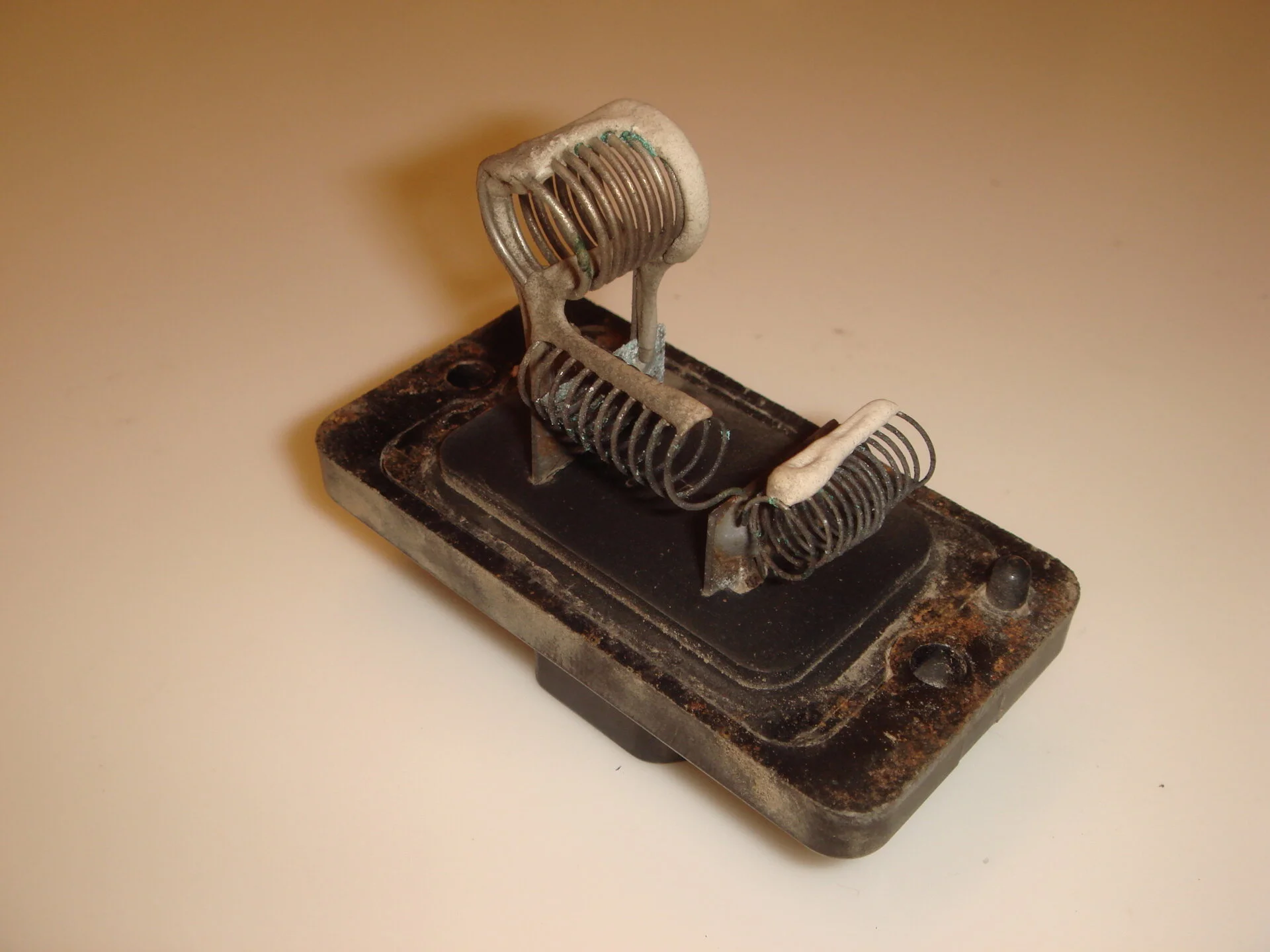

Maybe your fan resistor module’s low speed coiled burned out. It’s usually the first to go since it gets the most heating and use
Yep, blower resistor. Always on wife about not using the lowest speed setting. #2 or higher.
Took me a year but I got a new resistor and swapped it in. Worked like a charm!
