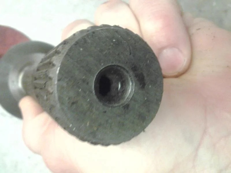

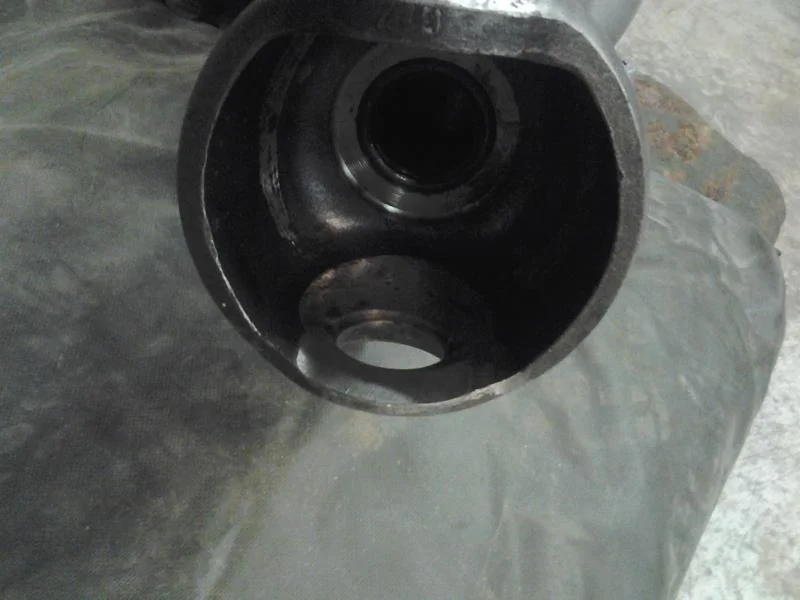

Birfs
So the complete stamping reads
BIRFIELD-NTN IGO AC TG
They do have a threaded hole on the end of the outer axle shaft and the inside of the axle housing has been clearance to fit something larger than intended
So you tell me. Newer or BS?
Bring it by. Tomorrow will work as will weekend. I can explain In person with show and tell..
