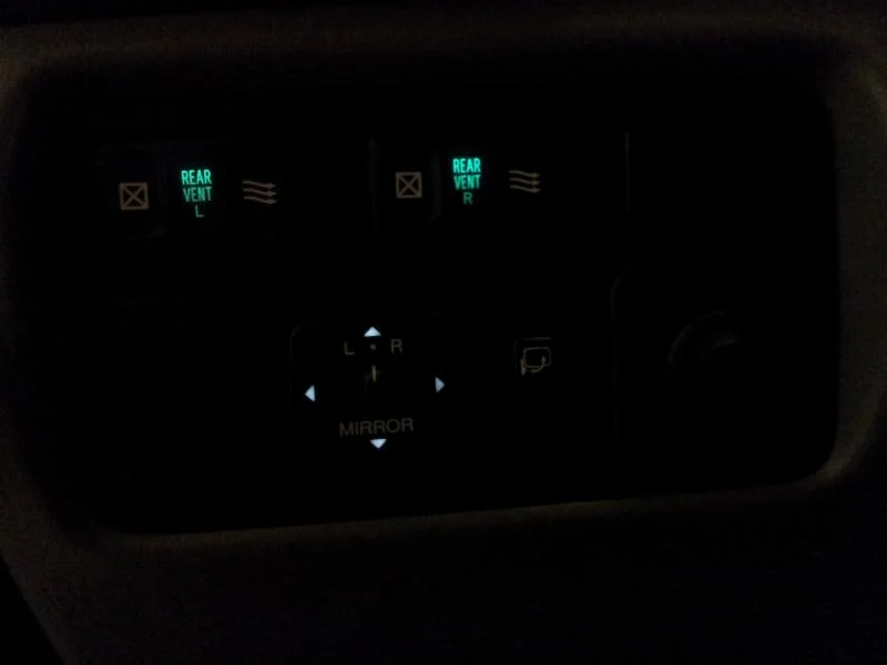

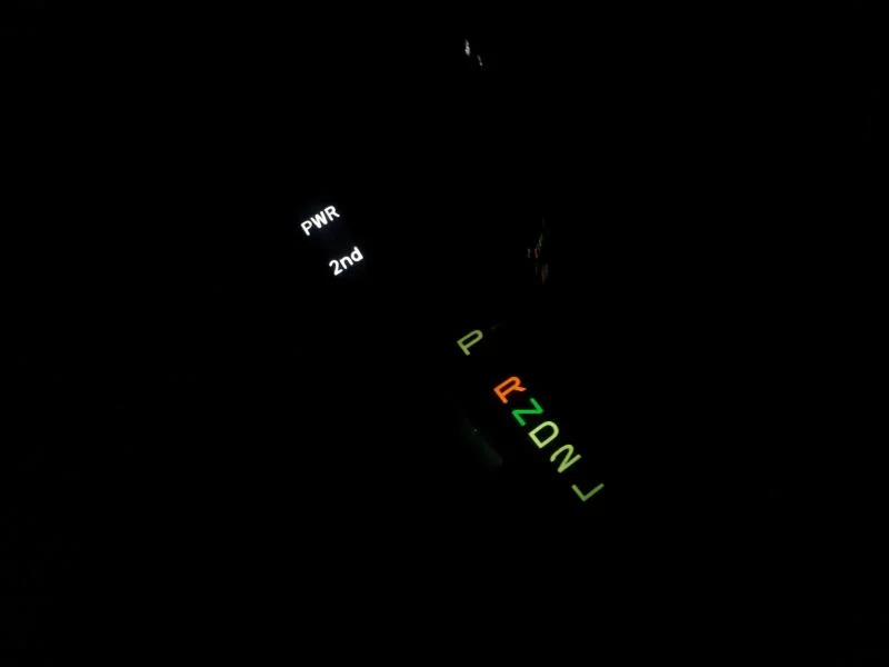

Success! We have light! After searching the internet I stumbled across an electronics website that has items from China. Its like an Amazon for electronics. I found T3 and T4 bulbs there cheaper than anywhere else. They come 5 to a pack. I just installed mine. They light up what needs to be lit, but I have to admit I was a little disappointed with the output. I think a lot of it has to do with the angle, and since they're LED's you can expect too much angled light.
http://dx.com/p/t3-0-4w-16lm-6500k-...-car-instrument-lamp-bulb-5-pcs-152189?item=4
T3's are for Quarter Windows, PWR 2ND, Seat Heaters, and AHC bulbs
http://dx.com/p/d-z-f423w-t4-2-0-15...t-instrument-lamps-black-5-pcs-152346?item=11
T4's are for the Window Switch. They also fit the dash, but I wasn't replacing anything in there. I'm hoping that they also will fit the HVAC system. If anyone can confirm it would be great. My system is dying and dim
Here's pics of them installed
