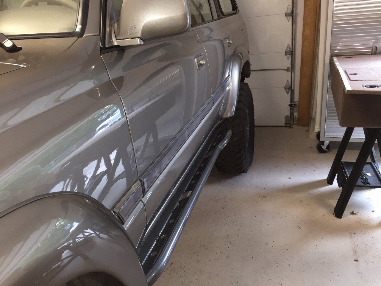

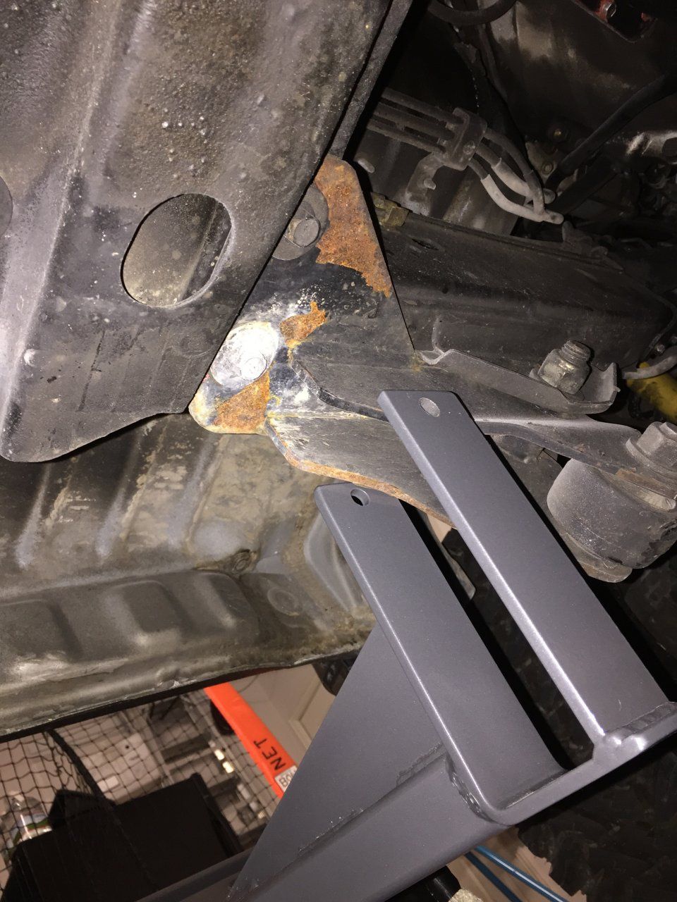

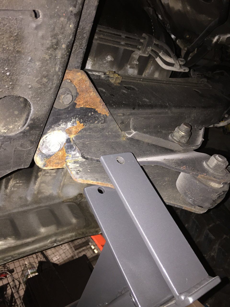

Just finished the driver side. The sliders fit between the MAF drop bracket and the frame.
I started by using a ratchet strap on the front axel and tied it to another truck to keep the axel from moving.
I then put a jack stand under the frame.
I unbolted the 2 bolts from the back of the drop bracket and then I unbolted the bolt that goes through the control arm bushing. From there I was able to swing the bracket down and out of the way to install the slider.
