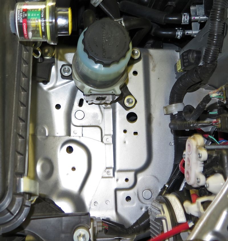

What’s that magic air filter indicator?
[edit] nevermind, found it:
Link
You want this one (note model number difference). Not sure why it’s picture is generic now on Amazon, but this is the one, as per @gaijin —same unit is on my truck:
K&N 85-2445 Filter Minder; Push in Amazon product ASIN B000E5XQDY
PS. If you plan to add a **second battery,** you’ll need that space, so consider a different location.
I put mine here:
I put mine here:

Your location looks fine, but the front location works fine for my application:
HTH
HTH
