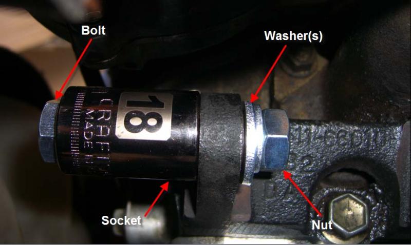

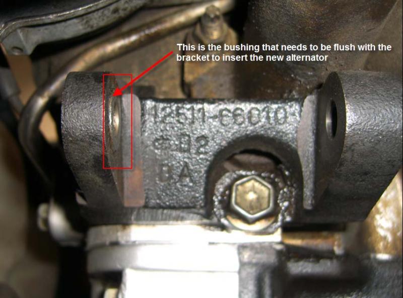

I believe the rear bushing on the alternator, if Denso, is adjustable.
You can press it out, install on the pivot bracket,
and tighten the nut/bolt to press back in to fit the bracket.
I just replaced mine on my '91, so it's fresh in my mind.
HTH
JJ
Your bushing is most likely the culprit. I hope these pics clarify the problem for you
Thank you JJ and Tony! That's exactly what I did and it worked like a charm! I just took the lady on her first ride and I think she likes it!:bounce:
