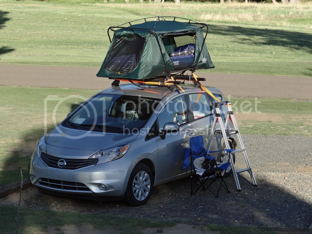

If you love rooftop tents but can't afford the weight or price, here's an alternative I came up with. If money were no object, I'd have a Tacoma with one of those hard shell hardtop tents. Or better yet, a Tacoma with a small slide in camper. My budget and dreams have compromised with this 2014 Nissan Versa and a rooftop tent setup.
First I got a Rhino Rack 2500 Series Heavy Duty roof rack. Then I got a Kamp Rite tent cot. I replaced the screws holding the legs to the tent cot with hand tightening knob screws/nuts. They're the kind that you see on a lawnmower handle. This way the cot can be bolted to the roof or the original legs easily. I made some shorter legs out of PVC and bolted them to the roof rack cross bars using some U bolts. To reinforce the setup laterally, I used some ratcheting straps. It works out pretty nice and can easily be duplicated. It's all pretty straight forward. The entire rig weighs a little under 50LBs. The tent cot is 35lbs and the roof rack is roughly 15lbs. The setup cuts gas mileage by about 2-4 mpg on average according to the display. It's also noisy and vibrates at certain speeds. I'm working on a different ladder setup and a weatherproof cover.
I know I need to get some pictures of it all packed up but that won't happen until late May.
Anyway, just thought I'd share so that anyone can experience the freedom of a RTT on a budget. The total cost should be South of $500.00.
