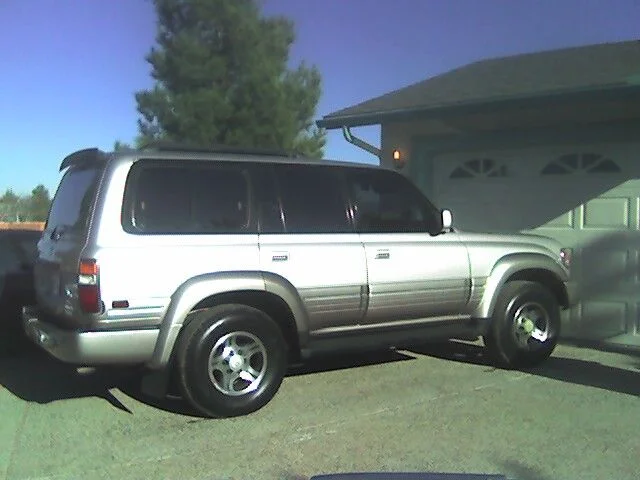

Hi again guys..
I went down with the intention of seeing the 91 with 33's in person, but got a call back from an internet guy for a small dealership that they had 2 locations with 3 LX450's available.
I figured it might be out of my price range, but after seeing a few Cruisers with cloth and no power, I wanted to at least know what it was like to sit in a fully loaded truck.
They had green...too dark. Gold, too expensive because only 80k or so miles, and then a Silver. I really liked the silver since I haven't seen any other Silvers on my searches the past few weeks.
I talked the guy down to 11,8 and had them swap the little wheel centercaps from a better rig, remove the towing setup from the Green LX to install on the Silver, and throw in an extra key cut to match the VIN and an extra remote so I have a pair of keys and remotes.
Quite clean, wonderful ride. Where am I supposed to put my big drink cups?!?!?! Those "cupholders" are a joke!
