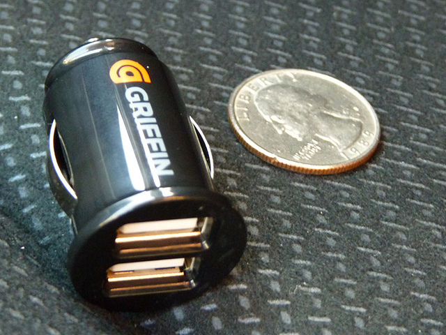

Griffin makes a dual usb cig plug one now. it sits flush with the cig plug face.
Now, I know you said you wanted one that doesnt take up space. I saw a FJC guy over on the blue forum that put them into a blank.

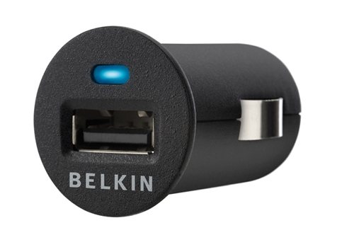

I just cut apart a single usb port belkin last night, and will be flush mounting it in my dash somewhere.

Waytek Wire ( http://order.waytekwire.com/ ) sells one that can be built into the dash, but adding a couple extra lighter sockets plus buying a couple of the Belkin converters posted earlier is cheaper and more versatile.
Waytek Wire ( Waytek Inc, Home page to buy fuses, circuit breakers, cable ties, wire and other electrical supplies By Waytek Inc. ) sells one that can be built into the dash, but adding a couple extra lighter sockets plus buying a couple of the Belkin converters posted earlier is cheaper and more versatile.
