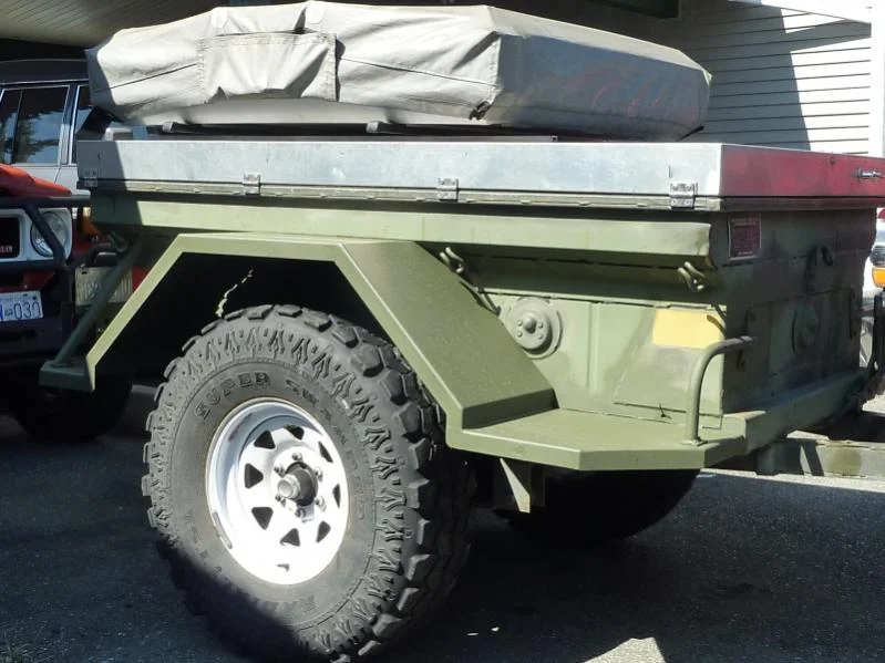

yep, in stock form they're great. if it works for the military, its gotta work for us right? in stock form, the only place my m101 went was from north van, to surrey :p so i cant comment more on stock.
on a 40, it might not be so bad, but behind my 80, i couldnt see the damn thing...and it didnt ride level. that and the dinkyness of the 6.5X29" tires compared to big 315s kind of looked silly, so thats why i opted for a spring over and matching wheels/tires (image is everything! :p) but i think in stock form, a stock cdn m101/iltis and a (mild SUA on pizza cutter) 40 is like a match made in heaven. i wouldnt bother with SO either.
depending on new axle width, tire width etc, you may not have to raise or get bigger fenders. i have 33X12 on my trailer. tires stick out about 4". 4.5" BS 80 wheels on the stock axle put the wheels way out there. with skinnies and more BS wheels, you should be able to be well inside the flares. if you're planning on pulling some leafs, to the point where the suspension would actually cycle, then yes you may need raise or get bigger fenders for clearance. from looking at the pics & vid from the trip report, the 40 track width isnt much more than the trailers? it seemed to track very well, staying within the ruts that the 40 was in.
i dont know if trailer brakes would be needed on these things, unless you're planning on loading a thousand lbs worth of gear in there or the 40s brakes arent stellar.
and yes, the trailer gets sprayed. not fun at all. not having a good pressure washer sucks too. i dont have an RTT and dont base camp around the trailer so its a non issue for me.
cant wait to see what you have in store for your setup greg!

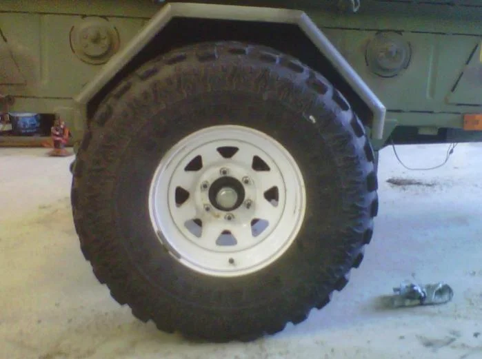

Finally got around to changing the hub/drums to LC size. Should be okay, as long as I don't hit any bumps eh?
gb
Ya think?:)
Yeah, looks pretty tight. I think there's more spring travel than the distance between the fender and top of the tire.

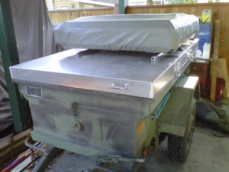

It's heading to Cruisin Off Road for some custom lov'n. Staying SUA, and having a set of bolt on fenders built. Building for max size of 35" tires, which will mean the top of the fender likely starting at the top of the gunwale, angled down to a flat storage section front and rear.
Tailgate, tongue box, aluminum storage box in front of the RTT on the lid, then some sort of removable load bar system above it all for mixed use, then into the interior for some sort of storage system: Rear slide out camp kitchen idea, with flat storage above which is accessed by the main lid. It'll all change 10 times between now and then anyway.
Hey, it's looking better already!
The locking lid is probably the next step for us, then the RTT. Looking forward to seeing where yours goes. Ours is probably fixed up as good as it's going to get for this year.

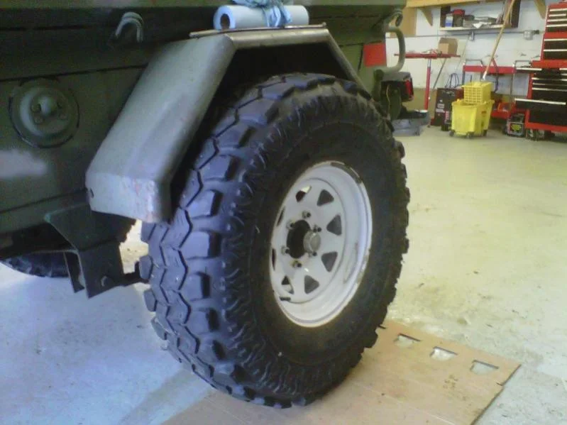

Here's the latest update with my trailer. Someone here as a "my slow trailer build" thread. I should rename mine "my slower trailer build" thread!
Anyway, some prototype bolt on fenders that allow running of 35" tires and staying SUA. These are build for the width of 315/75R16's on FZJ80 alloy 16x8 wheels (not the combo in the pics obviously). We also had some custom light brackets cut.

Looking Good. I found a product at my work... Costco it is called TarpX. It works great with the M101 CDn. I think it was about $40.
later
Ryan
Yowza, I like the lines of those fenders, too. Very nice work!:clap:
fine build---i love the trailer and the look,,,,,,,,,,,,,,goo job!!!!!!!!!!!!
Thanks for the complements folks. Jason is a pleasure to work with, as we beat up ideas, matched to his "this or that will work" hands on building experience. The pattern is in a laser table now, so where Jason wants to take this will be his call. There are a few ideas I have for a "prototype two" version, but I want to run this a little bit 1st. If "Prototype two" happens, these ones will be sold off.
