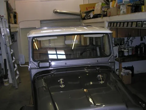

OK. I finally got to spray the cygnus white and I must say, is it really supposed to be this yellow?
Other than the colour, I'm quite pleased with the results.
I put a bead of seam sealer in the gutter and smoother it down with my finger, leaving a thin layer that rounds up onto the outer lip and into the roof itself. I did this before I sprayed the colour.

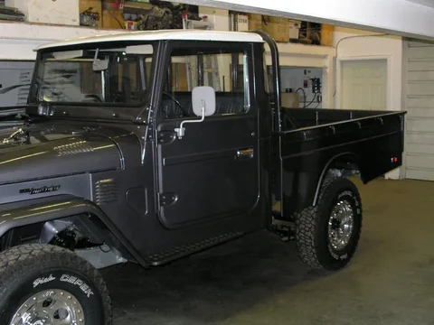

Here are some pics of the truck that made me buy mine. It's pretty white...ish. Hard to judge colors just looking at pics on the monitor. I don't know for sure if this rebuild is done with cygnus white or not but he does restoration as a big part of his operation so I would expect it is. I realize the rest of the truck is not exactly original but it is a stock Toyota color.
Yeah, I know it is hard to determine the real colour on a monitor screen.
It came to me this morning while I was making breakfast, my roof is the colour of buttermilk pancake mix. The Aunt Jamima brand.
