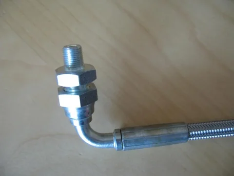

yeah,that confirms it ,still waiting for delivery off the gauges, because i use the oil pressure light and gauge i have to make an extension because the starter motor is in the way. I had a teflon hose made whit a 90° bend,seems okay,post pictures when done
