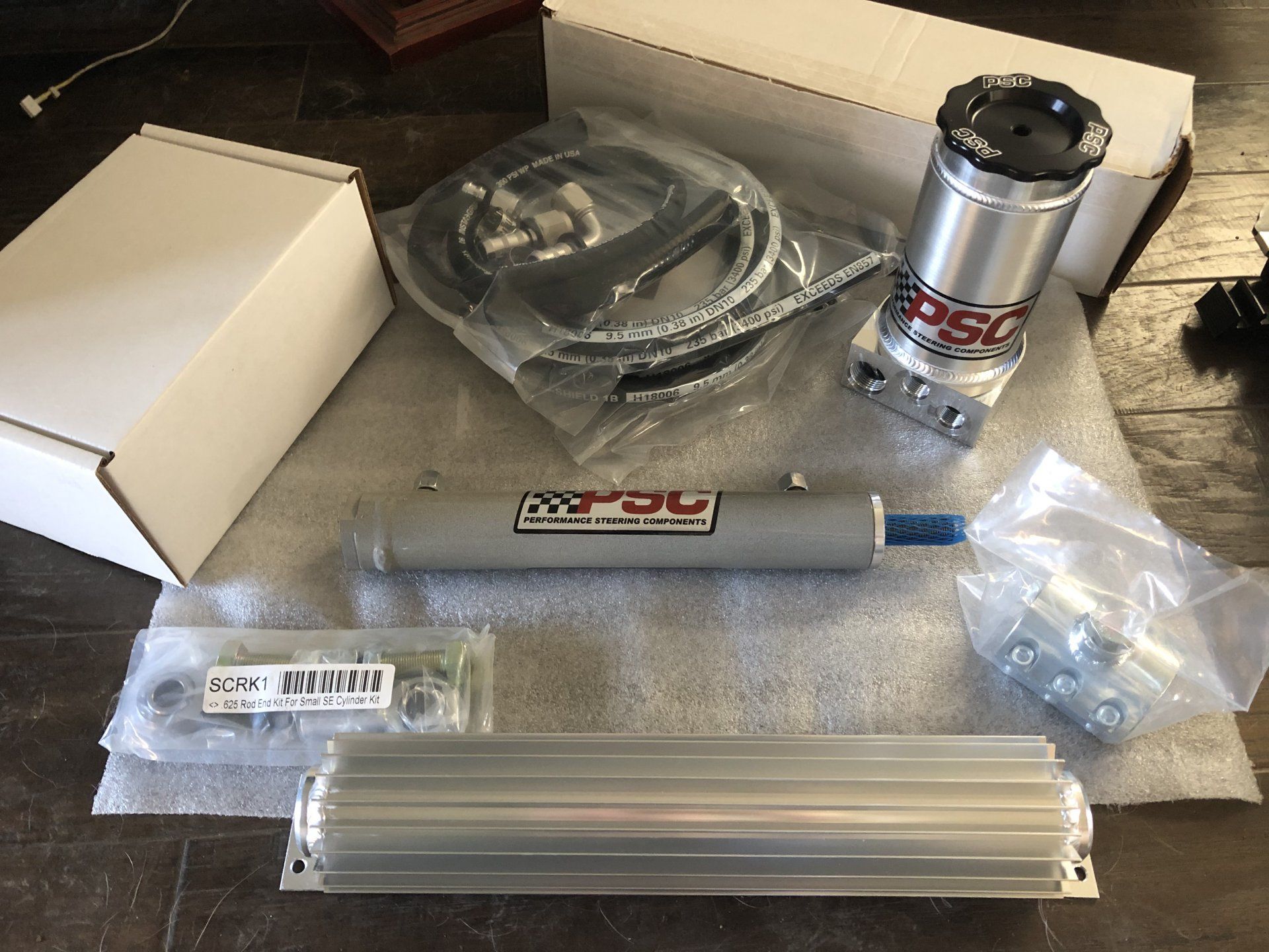

IFS eliminate kit
No interest at all . Maybe 2 years ago . Half the fun for me is the build. I still have so many big plans for this FJ. just takes Lots of Time and Money . Every year i make improvements
I mean, for IFS spindles, they are pretty cool. I just don't beat my daily driver hard enough to warrant that kind of upgrade. If I had a dedicated trail rig, it would be different for me without a doubt.
I also understand and respect the "thrill of the build" aspect. Looking forward to seeing how your project progresses.
If i am being honest the FJc is not the best platform to build . I could build a Mini truck for a fraction of the cost and not worry about it , The ifs has held up fine i take it on some good trails . Its just something i want to do and it will allow me to do the trails i do now with more confidence .

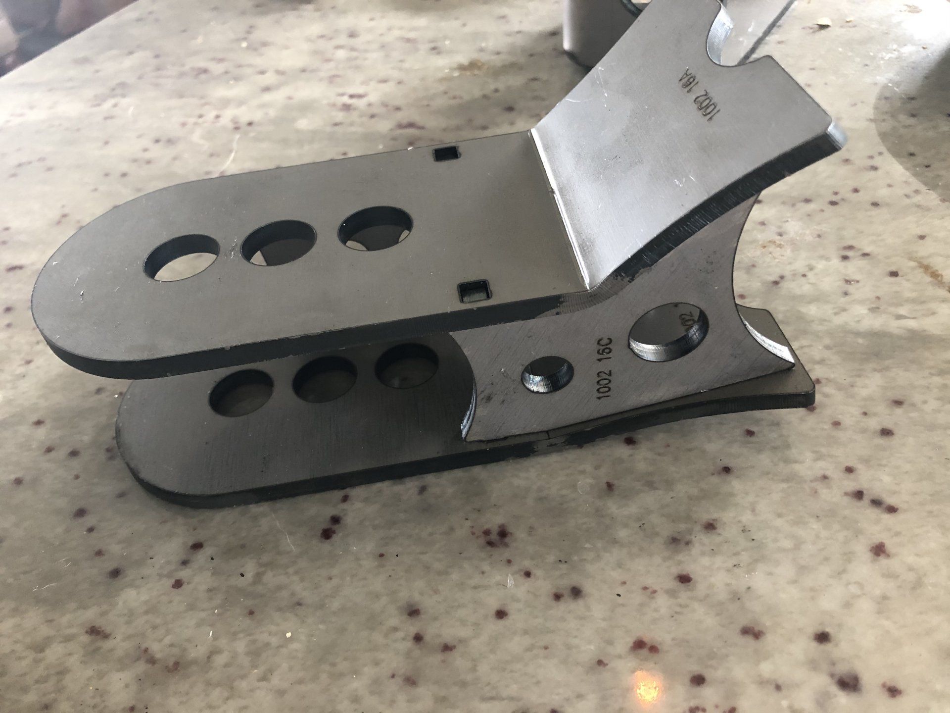

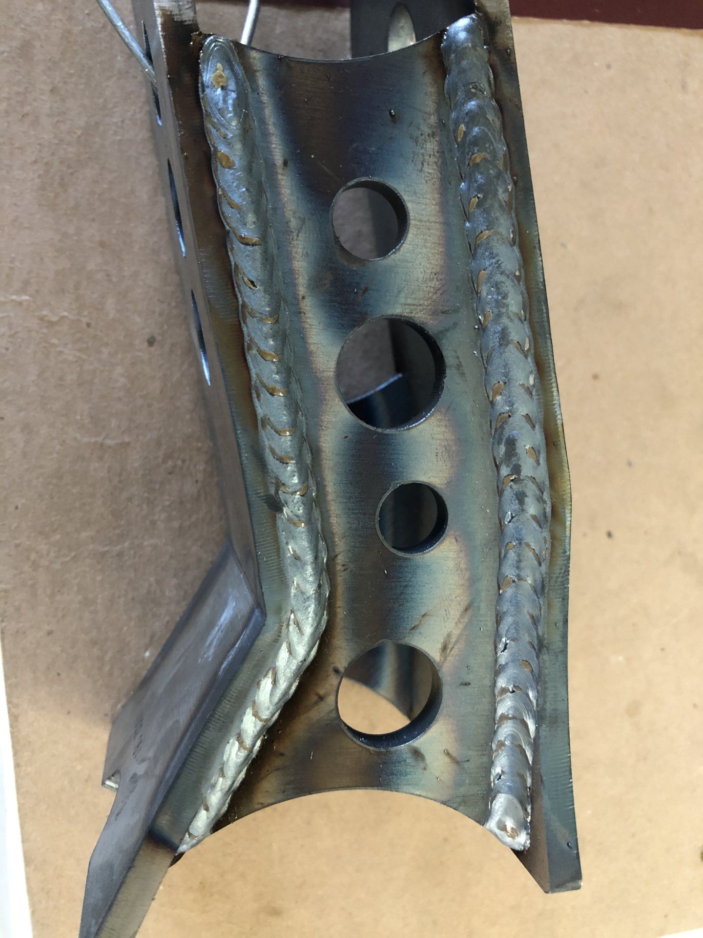

Glued some stuff together today

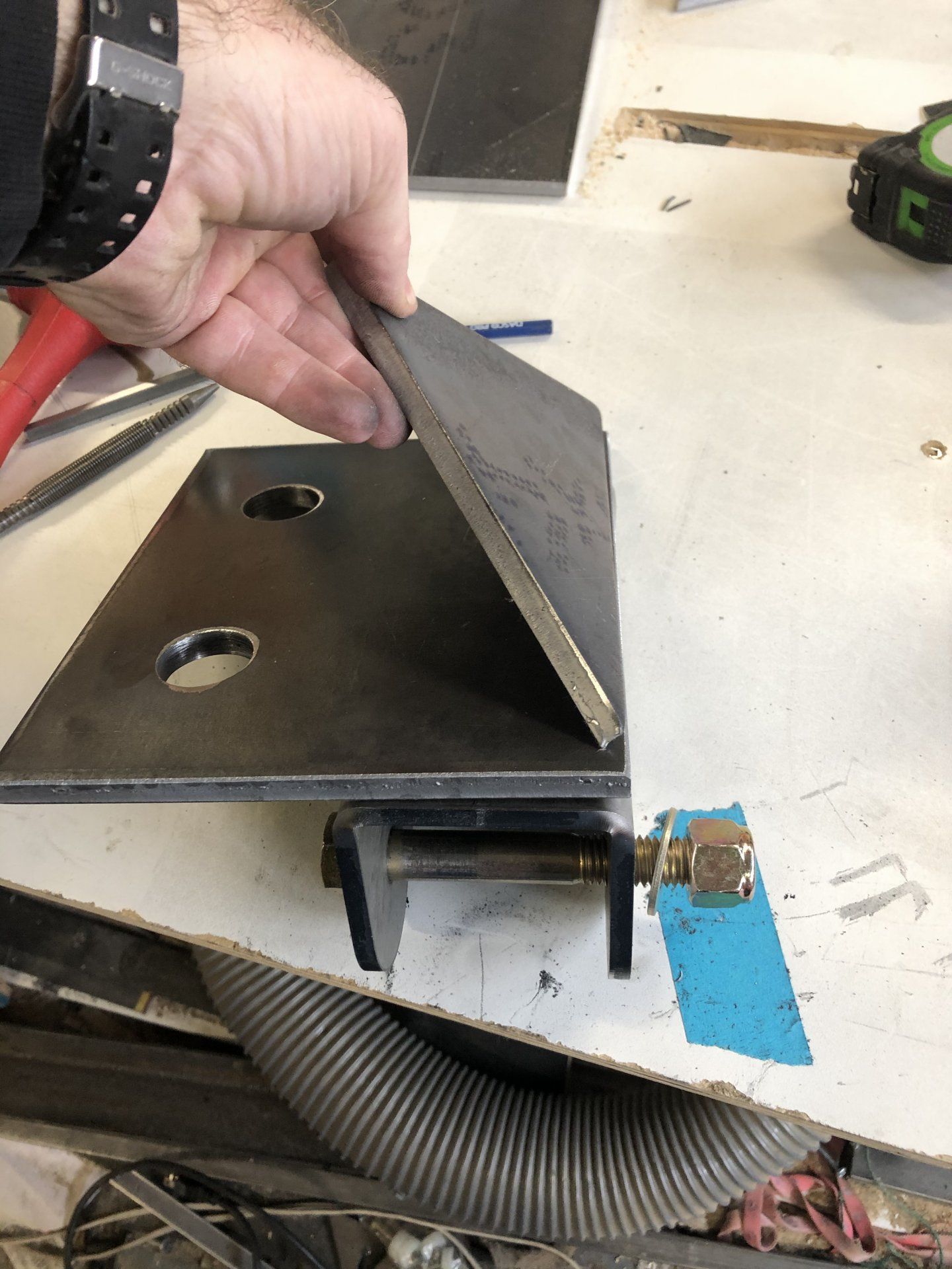

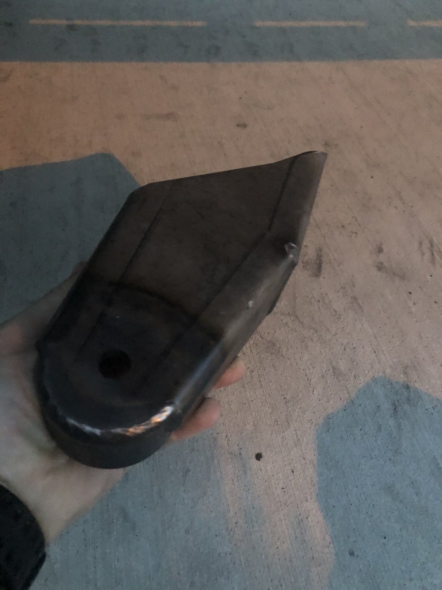

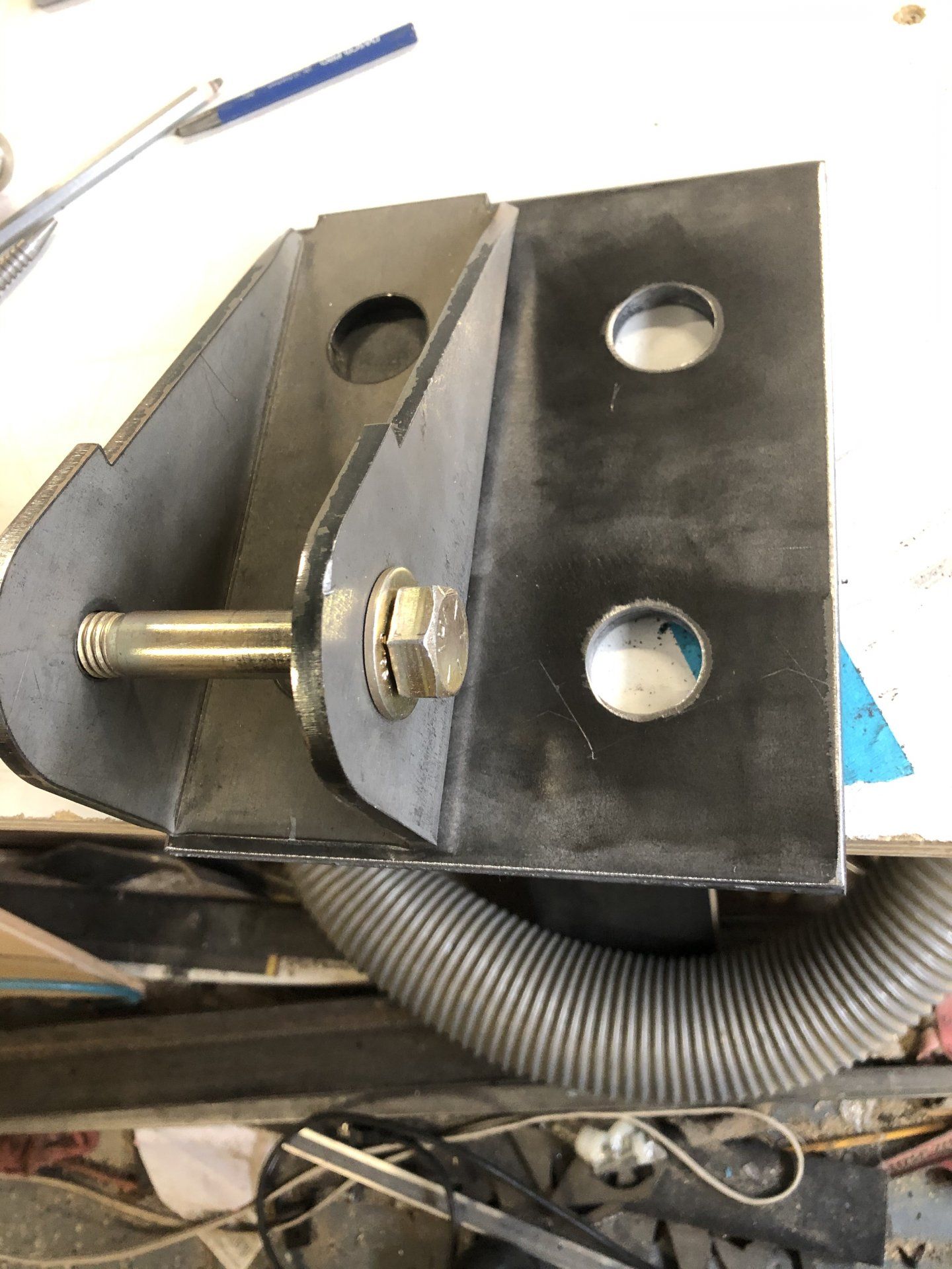

Made up the lower link frame mounts. And gussets today

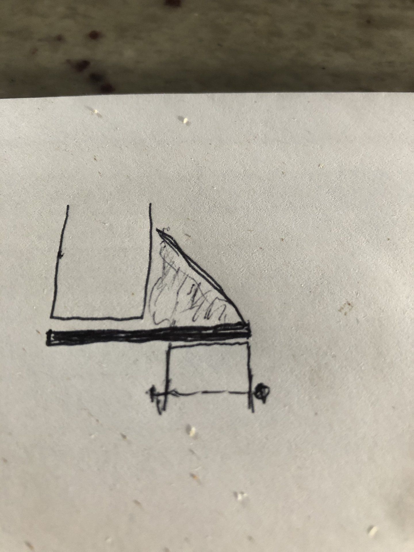

For those that need a visual of what they are . On the FJ you have to inboard the link mounts on the front .
Man that looks extremely beefy. Are you changing the lengths of your lower arms significantly?
Are you asking about the rear links ? I have not started the rear yet But when i do it will be a 3 link set up and yes the links will be longer than OE . The Front is also a 3 link setup but going from IFS to solid axle so i can not compare to anything .
