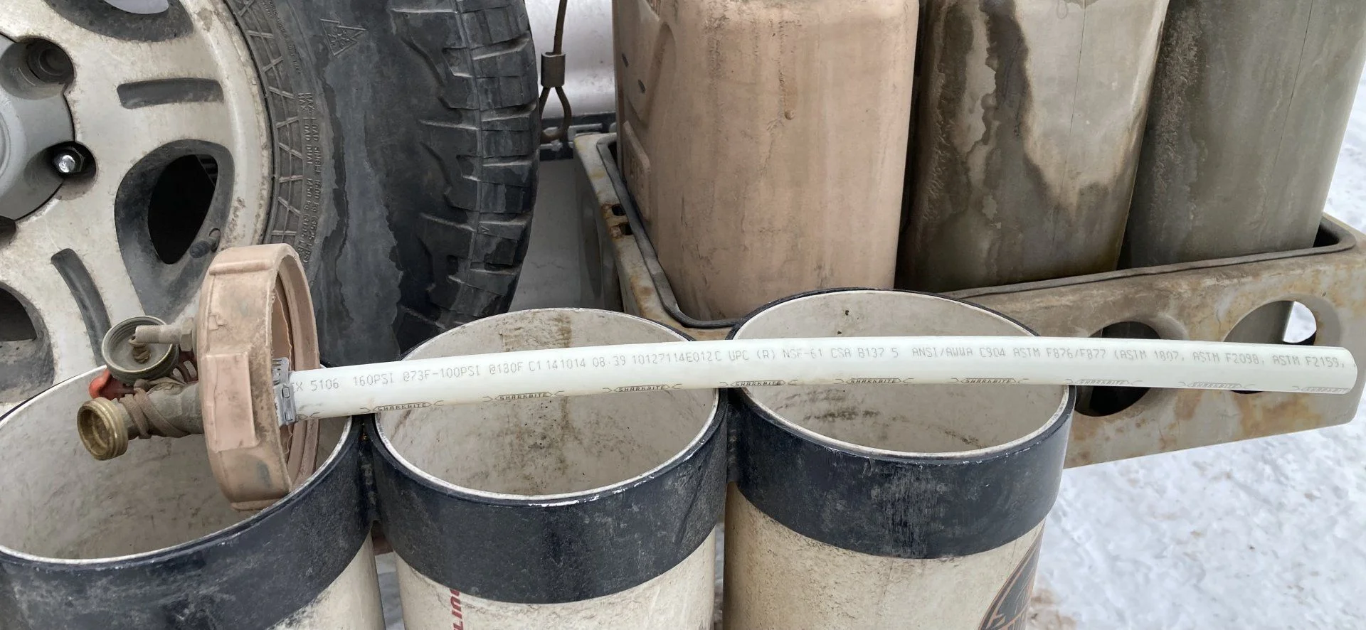

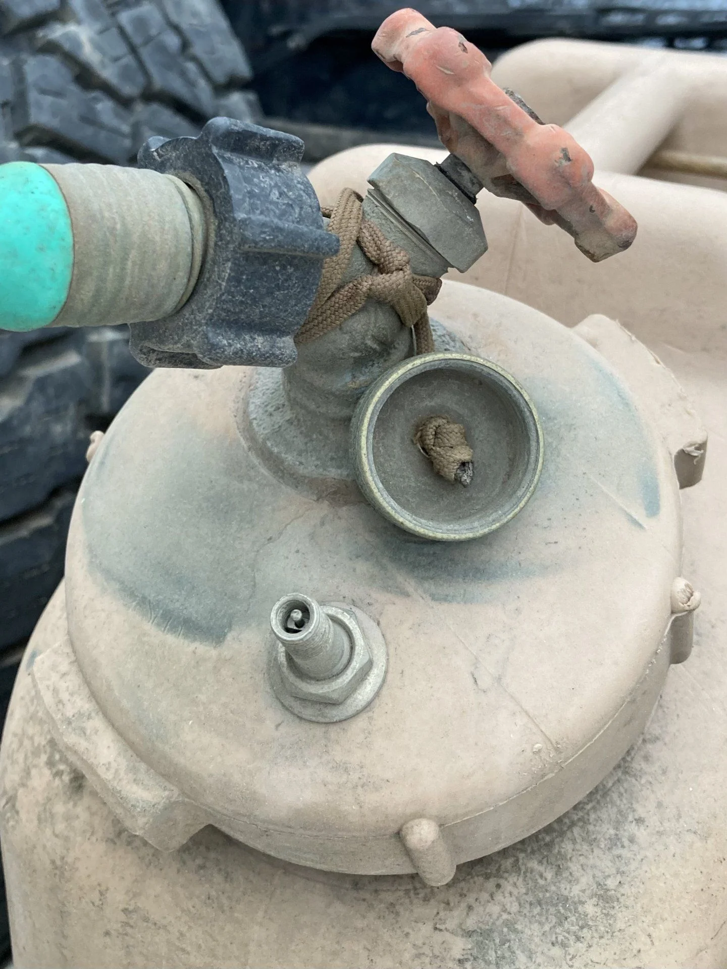

The Sceptor fuel & water cans are the best. In the Army we had them fly off of vehicles and slide down the road. No splitting or leakage. The 80 in the video is my rig, the pic is blurry but I set up one of the lids with an air valve. When I add air to the can, the pressure pushes the water out of the spigot. If anyone is interested, I can take some detailed pics.

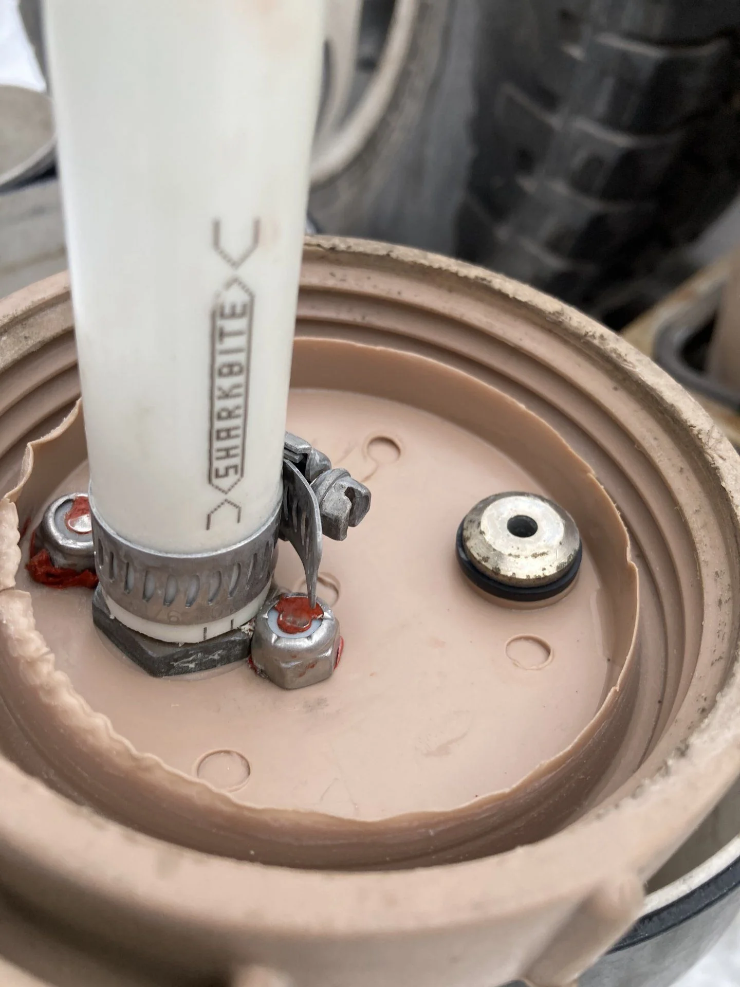

This isn’t my design, I found it on Mud and I don’t have the exact parts list. Basically when I pressurerize the air fitting, it forces the water down and up the white tube. I use it to wash up and fill the dogs water bowl.
Ahh, that makes sense. I was wondering how you fed that hose without a pump. How much pressure do you add and how long does that last (gallons wise?).

Atlas says deal! Actually it was Expedition Portal. Link bellow. Not sure how much pressure I pit in. I have the air chuck that will lock onto the air valve. It last 30-40 seconds if I fill and remove the air nozzle, if I leave it on, it will continue to flow.
